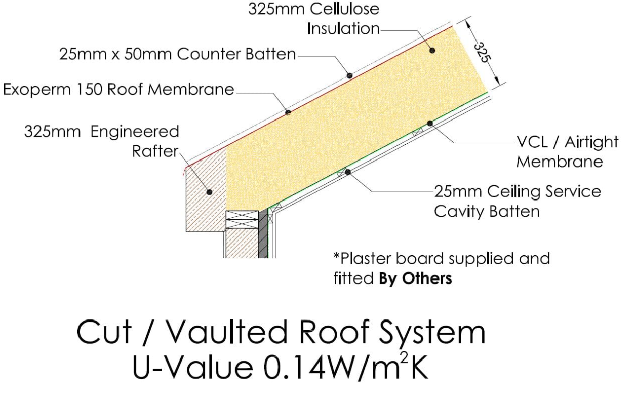

bob the builder 2 Posted March 12, 2022 Author Share Posted March 12, 2022 Thanks to everyone for the input so far. We are going with a well known TF provider who will leave us with a vaulted roof as per this picture (hope you can all see it) So the question is if we want to go standing seam (zinc or PLX) what is the best in terms of depth and performance (we are just a bit tight on headroom hence the desire to make the depth as narrow as possible) Thanks again for your thoughts Bob 1 Link to comment Share on other sites More sharing options...

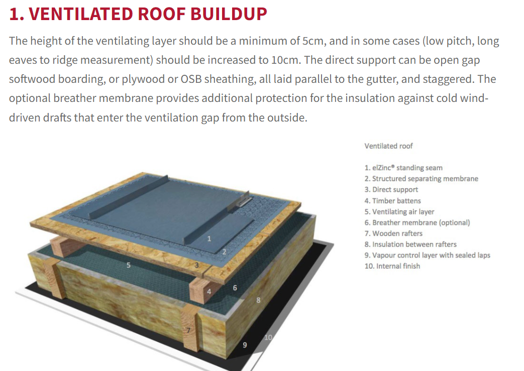

Patrick Posted March 12, 2022 Share Posted March 12, 2022 Always always ventilated. No question about that .... It s not even close. It s so much more secure and less option for mistakes ... On the paper , both might have pros and cons.... In reality I haven't seen much evidence for warm roof being a great idea. Link to comment Share on other sites More sharing options...

PeterW Posted March 12, 2022 Share Posted March 12, 2022 @bob the builder 2 you’ve asked the wrong question and everyone is answering it ..!! If your TF provider is insulating using blown cellulose then you have a warm roof to start with. You can’t change that unless you change the insulation and a whole load of other things. What I think you are asking is whether to ventilate behind the standing seam zinc and the answer there depends on what the supplier requires as some will be happy to go onto your current counterbattens and others may require OSB or fleece backed underlay prior to laying. If you want to ventilate the rafter level space then you have a lot of work to do to join membranes and sort partial fill insulation which will need to be a change to your TF spec. 2 Link to comment Share on other sites More sharing options...
Patrick Posted March 12, 2022 Share Posted March 12, 2022 46 minutes ago, PeterW said: @bob the builder 2 you’ve asked the wrong question and everyone is answering it ..!! If your TF provider is insulating using blown cellulose then you have a warm roof to start with. You can’t change that unless you change the insulation and a whole load of other things. What I think you are asking is whether to ventilate behind the standing seam zinc and the answer there depends on what the supplier requires as some will be happy to go onto your current counterbattens and others may require OSB or fleece backed underlay prior to laying. If you want to ventilate the rafter level space then you have a lot of work to do to join membranes and sort partial fill insulation which will need to be a change to your TF spec. To answer how to do that best (imho) . As i got the same setup in my house. Blown cellulose , Standing Seam on top : Sarking boards on counterbattens above Timber frame filled with Cellulose. Link to comment Share on other sites More sharing options...
bob the builder 2 Posted March 12, 2022 Author Share Posted March 12, 2022 All Thank you as ever some great advice. So i think this is what i must do then given my timber frame is specified to a 'warm roof' build-up. Am i right to call this a 'Ventilated warm roof' ? Many thanks 1 Link to comment Share on other sites More sharing options...
Patrick Posted March 12, 2022 Share Posted March 12, 2022 3 minutes ago, bob the builder 2 said: All Thank you as ever some great advice. So i think this is what i must do then given my timber frame is specified to a 'warm roof' build-up. Am i right to call this a 'Ventilated warm roof' ? Many thanks Thats the correct setup . You can get away with putting tanalised timber boards cloesely spaced underneath the Standing seam instead of OSB - saves a bit of wood and a bit of Hairy chest - but both methods are pretty rock solid . Link to comment Share on other sites More sharing options...

Temp Posted March 12, 2022 Share Posted March 12, 2022 11 hours ago, bob the builder 2 said: Thanks to everyone for the input so far. We are going with a well known TF provider who will leave us with a vaulted roof as per this picture (hope you can all see it) So the question is if we want to go standing seam (zinc or PLX) what is the best in terms of depth and performance (we are just a bit tight on headroom hence the desire to make the depth as narrow as possible) Thanks again for your thoughts Bob OK so some people will call this a warm roof because the loft space is heated or at least on the warm side of the insulation. I prefer the term "warm loft, cold roof". This is a cold roof because part of the structural roof (the rafters) extend through the insulation to the cold side. The gap between the metal roof and the membrane needs to be well ventilated. This would involve using a ridge system that provides a full length vent with matching vent at the eaves. The vent at the eaves would be equivalent to a 25mm wide slot. The vent at the ridge would be equivalent to a 5mm wide gap each side of the ridge "tile". Insect mesh may reduce the effectiveness area of the vent so allow for that by making them bit wider. It shows counter battens and I would expect horizontal battens to be added on top of these to raise the steel roof further to form the gap. The membrane should be a vapour permeable type (Exoperm is breathable) and approved for contact with the insulation (I haven't checked). Metal roofs have a history of attracting condensation on the underside of the metal so I'd be tempted to increase ventilation above what normally recommended. Bigger vents at the ridge? As the roof supplier. 1 Link to comment Share on other sites More sharing options...

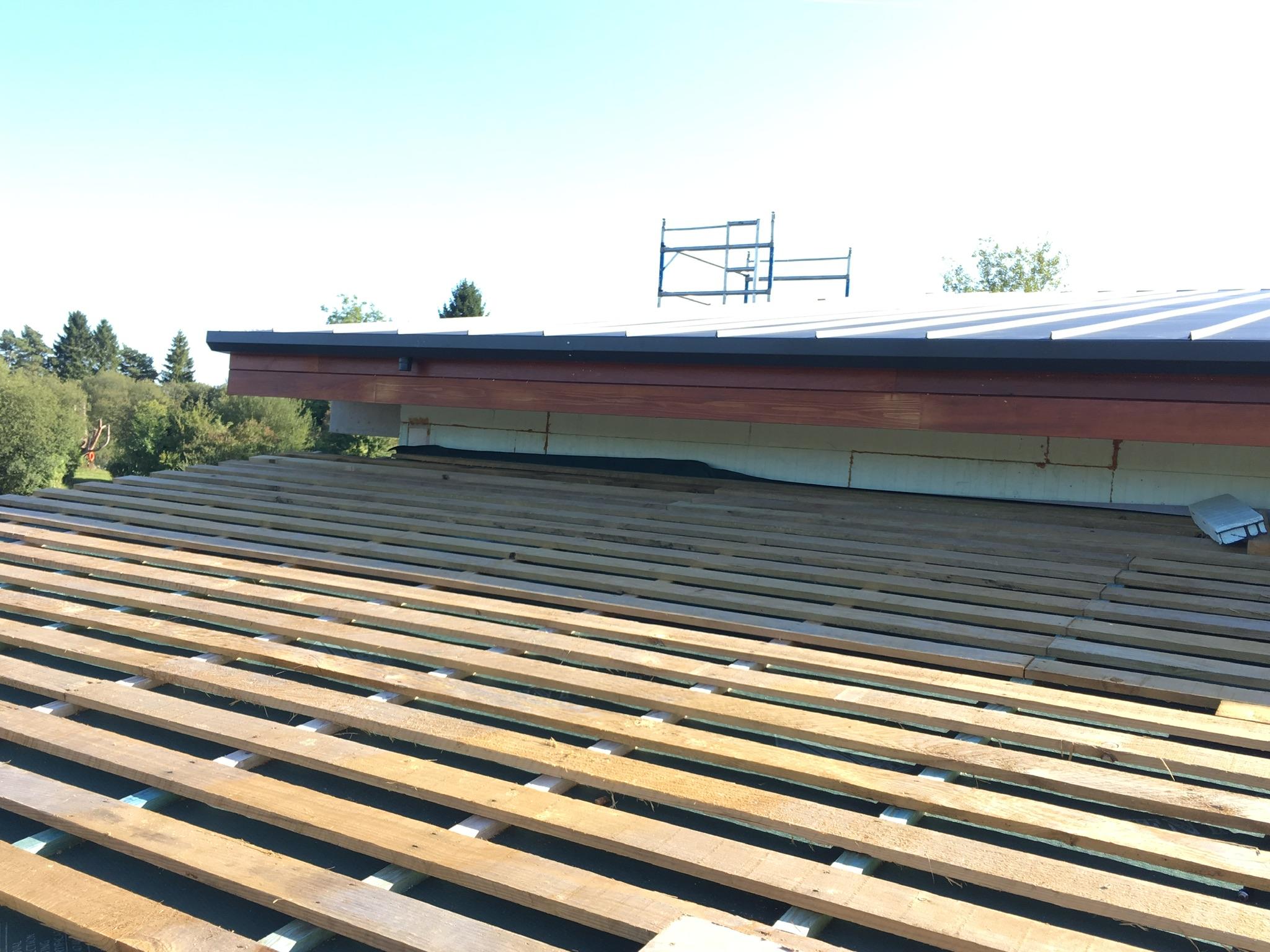

Iceverge Posted March 13, 2022 Share Posted March 13, 2022 4 hours ago, Patrick said: You can get away with putting tanalised timber boards cloesely spaced underneath the Standing seam instead of OSB Excellent, I didn't know this. I never liked the idea of a flat sheet of metal on a flat sheet of OSB. Far to much chance of moisture between the layers not being able to dry out quickly. The closely spaced battens is a far most robust idea. 10/10. 1 Link to comment Share on other sites More sharing options...
JamesP Posted March 13, 2022 Share Posted March 13, 2022 I have a ventilated warm roof fitted with Tata Steel SSR system. Pay attention to the closely fitted battens otherwise it is very noisy when the wind blows. 1 Link to comment Share on other sites More sharing options...
Patrick Posted March 13, 2022 Share Posted March 13, 2022 2 hours ago, JamesP said: I have a ventilated warm roof fitted with Tata Steel SSR system. Pay attention to the closely fitted battens otherwise it is very noisy when the wind blows. Hairy chest underneath is the answer ( tyvek metal or Dorken DeltaTrela ....) 1 Link to comment Share on other sites More sharing options...
Russell griffiths Posted March 13, 2022 Share Posted March 13, 2022 10 hours ago, Iceverge said: Excellent, I didn't know this. I never liked the idea of a flat sheet of metal on a flat sheet of OSB. Far to much chance of moisture between the layers not being able to dry out quickly. The closely spaced battens is a far most robust idea. 10/10. this is how we did ours. 4 Link to comment Share on other sites More sharing options...
