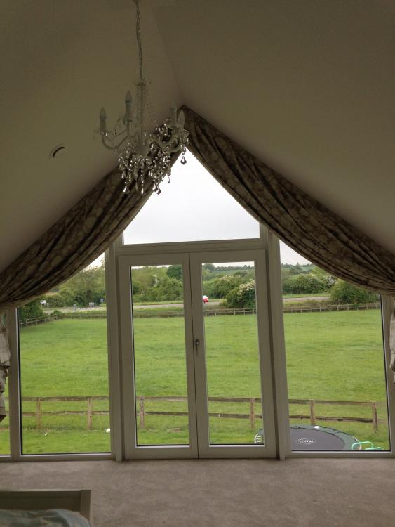

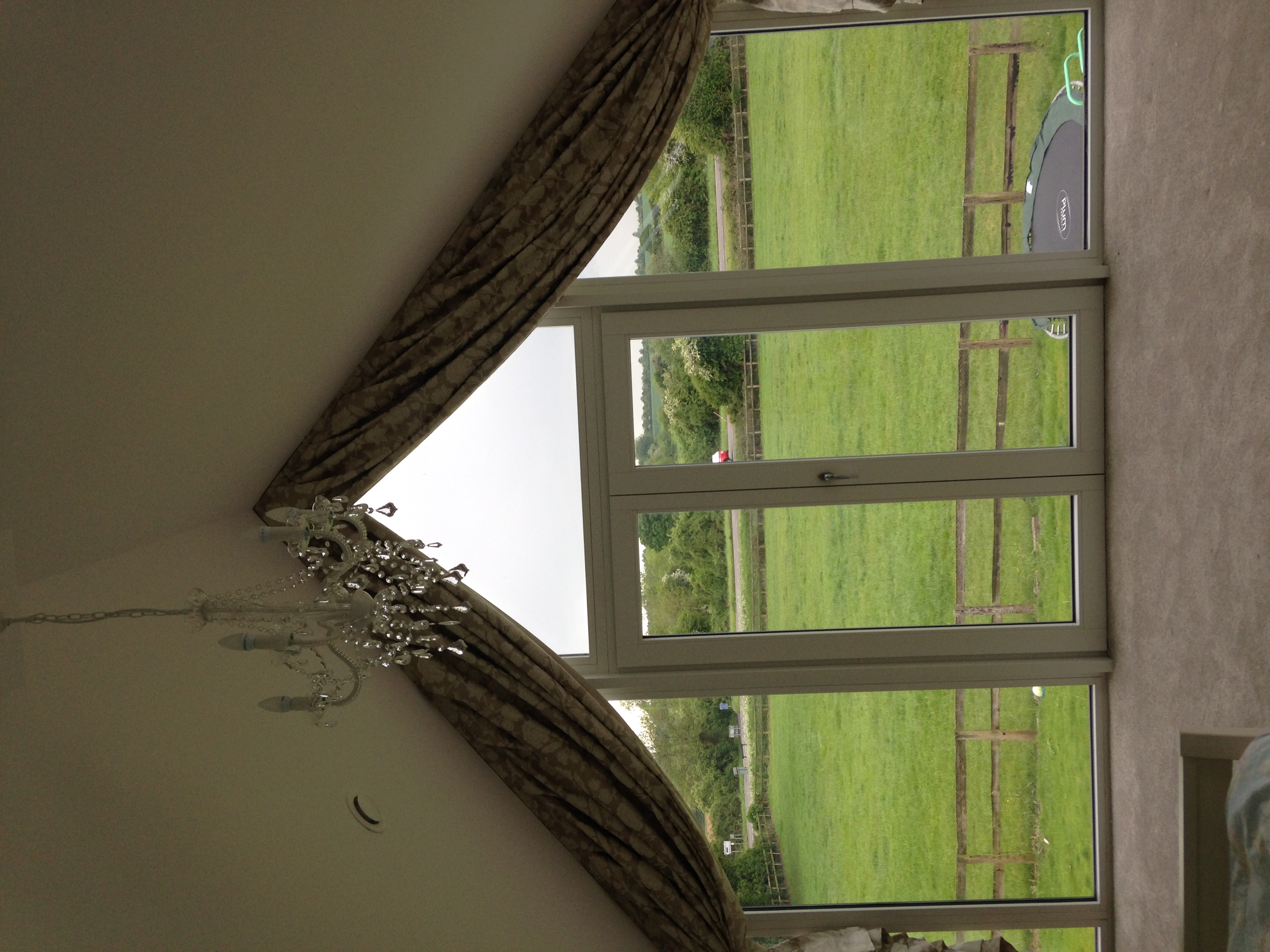

We have had some roman blinds made up for a couple of the windows, and some curtains on poles which should be installed in a couple of weeks, so will post a picture.  The most fun has been trying to come up with a solution for our massive bedroom glazed gable, we'll see what that looks like in a couple of weeks.

  • 3 weeks later...
The curtains went up today, we have been nervous about how they would look but are really please
