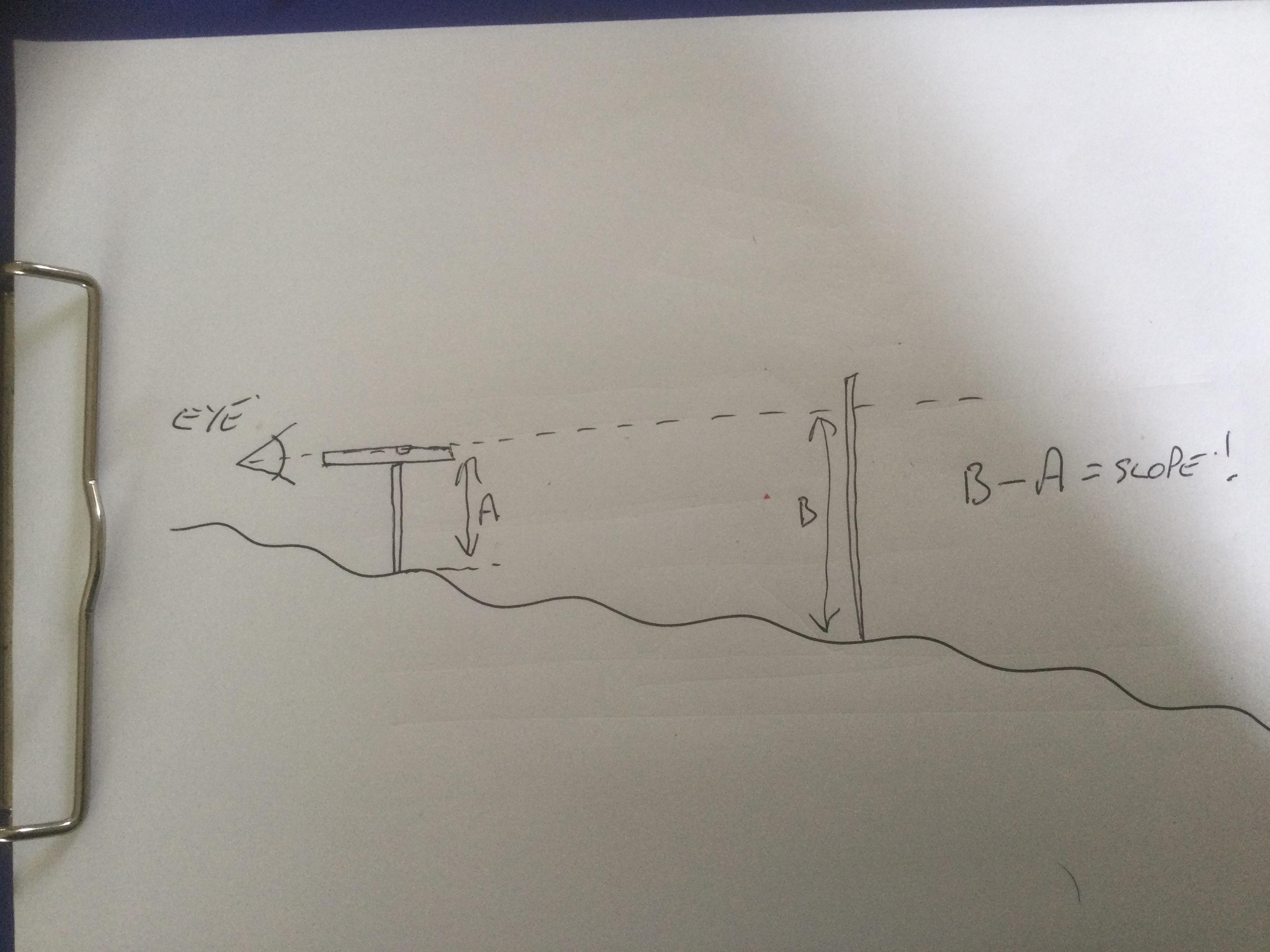

joe90 Posted February 17, 2022 Posted February 17, 2022 How accurate do you really need to be?. Use a spirit level and two poles with a friend!. 3
Grian Posted February 17, 2022 Author Posted February 17, 2022 Ah!!!! That looks familiar, in a distant and unpleasant way, 'if the tree is 20ft away and Timmy is 4'7" how soon will the train reach the station?". Thank you! Accurate enough to be 100% confident the drop is sufficient to work for foul water... The proposed hut location is a fair distance from the septic tank. Step 2 will be discovering the formula (forumula probably as I will ask here!) that tells me if poopies will make it that far. If not there is a plan b but I prefer plan a quite a bit more. 1
