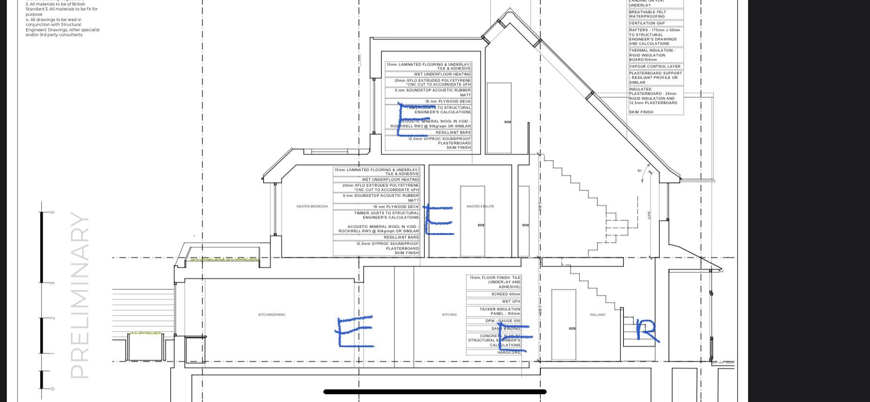

Dan F Posted February 12, 2022 Share Posted February 12, 2022 31 minutes ago, Adsibob said: R shows the location of my Router (or the location it will be once installed next week). E shows the points where I have Ethernet. I can only give up the one on the first floor and one of the ones on the ground floor for access points. Well this be enough? Really hard to know from a single cross-section like this. They have a design tool that you can use to give you a good idea, it is fairly conservative though and is only 2D, not 3D. 31 minutes ago, Adsibob said: What hardware do I actually need and what the hell is a ubiquiti dream machine? Depends what you want to use Ubiquiti for: - If you just want wifi then you need access points, something to power them with and somewhere to host the controller software. To recommended way to power them is from a PoE switch, which means they can just run on the other end of your pre-installed ethernet cable and don't need ay power adapters. The controller software to manage the wifi networks can be run anyway (including a PC or a raspberry pi etc.) but the "dream machine" products have it pre-installed so you don't need to host it. - Another thing you might want to use Ubiquiti for is as a router. If you do, then the "dream machine" products are also routers. Alternatively you might want to use a ISP supplied router or a product from an alternative manufactuer. - If you also want to Ubiquiti for CCTV, the "dream machine" products (particualry the ones that accept hard drives) can be used and an NVR. 31 minutes ago, Adsibob said: And can the access points go in cupboards, or will their ability to spread the magic suffer? They can go anyway. Ours are in ceiling voids. But there will be some amount of impact on sigan`l if you hide them away too much. so you do need to be aware of that. Link to comment Share on other sites More sharing options...

Adsibob Posted February 13, 2022 Author Share Posted February 13, 2022 Thanks @Rob99 and @Dan F. For a three storey house, do you think one dream machine pro and two APs will be enough? Does the dream machine pro also act as a wireless access point itself (like the Virgin superhub does) ? And I was a bit confused by @Dan F’s comment about needing a pc to run the software. Why is that necessary when ubiquiti’s website talks about controlling everything from their app? Link to comment Share on other sites More sharing options...
Dan F Posted February 13, 2022 Share Posted February 13, 2022 (edited) 2 hours ago, Adsibob said: For a three storey house, do you think one dream machine pro and two APs will be enough? Hard to know. If they are ceiling mounted though, i can't see you getting good signal on second floor (from first floor AP) as i think the beams point downwards, if that make sense? Quote Does the dream machine pro also act as a wireless access point itself (like the Virgin superhub does) ? Most don't, but i think they may have just released one with an AP incorporated, might need to check EA store though. Quote And I was a bit confused by @Dan F’s comment about needing a pc to run the software. Why is that necessary when ubiquiti’s website talks about controlling everything from their app? PC/Pi to run the management software, but this is only if you don't buy a dream machine. Edited February 13, 2022 by Dan F Link to comment Share on other sites More sharing options...
