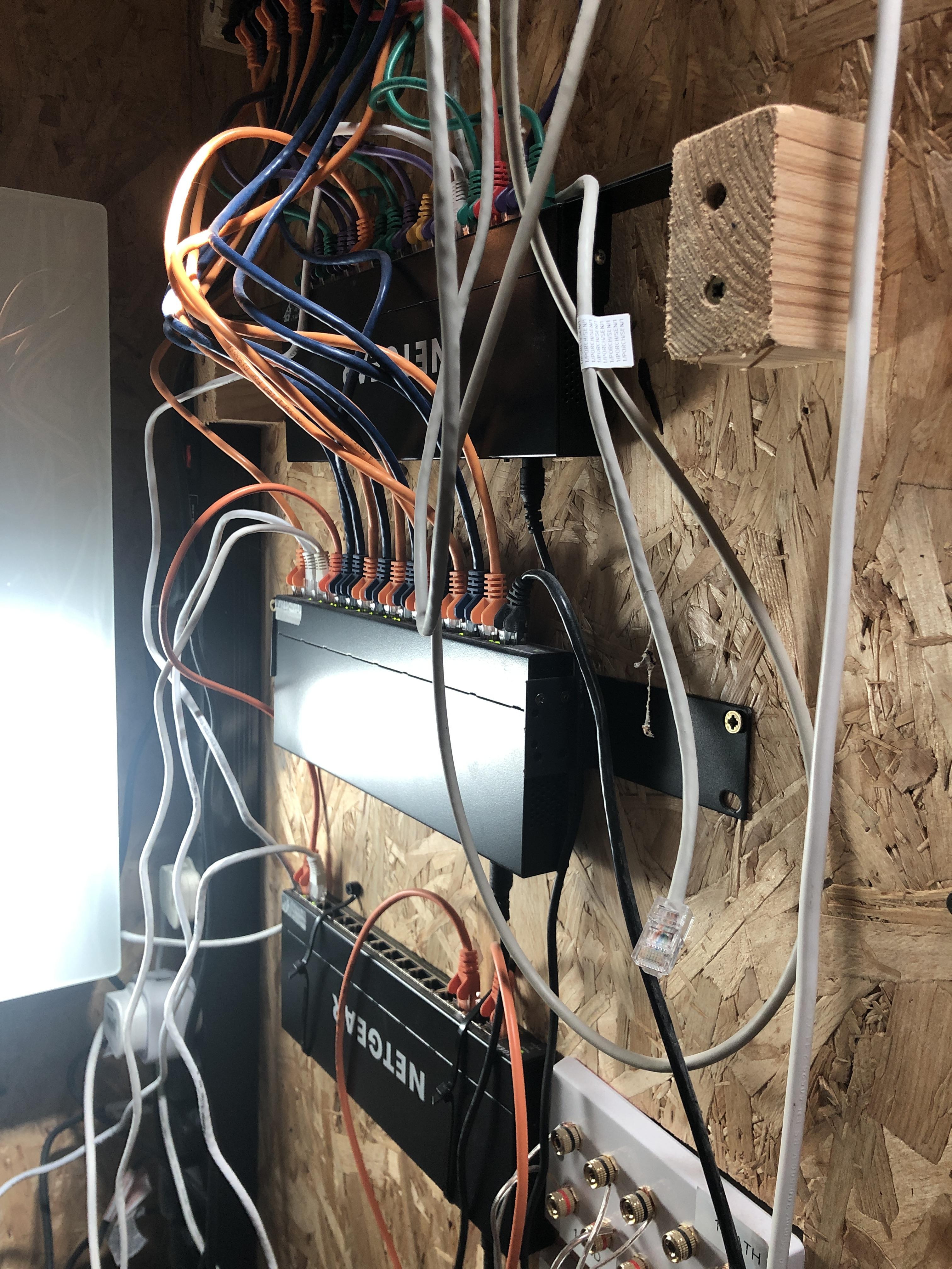

willbish Posted June 26, 2022 Share Posted June 26, 2022 I have similar requirements to @Adsibob and will likely follow @JonJump advice and fit an unmanaged switch in front of my router with 2 decent ceiling mounted wireless access points. Currently looking at switch options and it seems that most 19" rack mounted POE options are all managed. Is that the case? I'm looking for 24 port total but only really need a handful POE. Currently have all 16x cat6 terminated and patched ready for the next step.. 1 Link to comment Share on other sites More sharing options...

MikeSharp01 Posted June 26, 2022 Share Posted June 26, 2022 2 hours ago, willbish said: I'm looking for 24 port total but only really need a handful POE. That's a dinky rack, like it. Link to comment Share on other sites More sharing options...

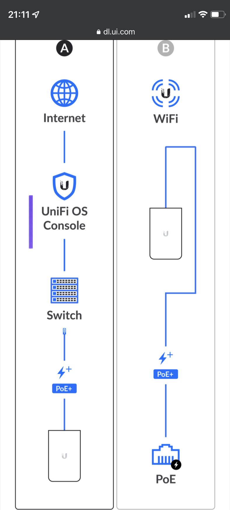

Adsibob Posted June 26, 2022 Author Share Posted June 26, 2022 The confusion prevails. Was about to purchase two ubiquiti in wall APs, as recommended by @Nickfromwales , and a switch and on the ubiquiti website I come across the below infographic which suggests I also need a “Unifi OS Console”. Do I and if so what the hell is it and why are the others on here managing without one? Link to comment Share on other sites More sharing options...

willbish Posted June 27, 2022 Share Posted June 27, 2022 14 hours ago, Adsibob said: The confusion prevails. Was about to purchase two ubiquiti in wall APs, as recommended by @Nickfromwales , and a switch and on the ubiquiti website I come across the below infographic which suggests I also need a “Unifi OS Console”. Do I and if so what the hell is it and why are the others on here managing without one? Why do you need an expensive Ubiquity switch? I would've thought a cheaper unmanaged alternative would suffice and then add the Ubiquity WAP's Link to comment Share on other sites More sharing options...
Adsibob Posted June 27, 2022 Author Share Posted June 27, 2022 52 minutes ago, willbish said: Why do you need an expensive Ubiquity switch? I would've thought a cheaper unmanaged alternative would suffice and then add the Ubiquity WAP's I thought that if i'm forking out £350 for two market leading APs it makes sense to get a decent switch from the same manufacturer. Won't that assist with managing it all from the ubiquiti app, or is that not required for compatibility with the app? I have no real idea about any of this. Way over my head. Link to comment Share on other sites More sharing options...

Rob99 Posted June 27, 2022 Share Posted June 27, 2022 38 minutes ago, joth said: unfortunately they don't have a PoE switch built They do now - the UDM SE.............. https://eu.store.ui.com/products/dream-machine-se 1 Link to comment Share on other sites More sharing options...
joth Posted June 27, 2022 Share Posted June 27, 2022 (edited) 41 minutes ago, Rob99 said: They do now - the UDM SE.............. https://eu.store.ui.com/products/dream-machine-se So there you go. Buy: 1x UDM-SE-EU 2x U6-Lite (or other AP of your choice) Job done. "in for a penny, in for a few hundred pounds" Edited June 27, 2022 by joth Link to comment Share on other sites More sharing options...
Adsibob Posted June 27, 2022 Author Share Posted June 27, 2022 9 minutes ago, joth said: So there you go. Buy: 1x UDM-SE-EU 2x U6-Lite (or other AP of your choice) Job done. "in for a penny, in for a few hundred pounds" That is a very expensive setup and not one I can afford unfortunately, particularly when an unmanaged solution would probably solve all my problems much much more cheaply, eg.: https://www.broadbandbuyer.com/products/41041-tp-link-tl-sf1009p/ I say probably because I haven't really given much thought to the PoE budget yet. At present, i plan on using PoE to power the following: Tado hub (using the this Active PoE Splitter I mentioned previously: https://amzn.eu/d/hpNsulI) Philips Hue hub (not sure if they do or will do a PoE version, but if not I will use a splitter) Ring PoE camera Velux Netatmo hub (not sure if they do or will do a PoE version, but if not I will use a splitter) First AP Second AP Third AP (if necessary - i'm hoping two will suffice, but who knows until it's actually installed) connection to further switch for non PoE devices So 8 PoE sockets should suffice but there is little room for future proofing if I think of something else. Having said that, I'm not planning on laying any more cable so there isn't much more I could install without making the house really ugly with trunking. How did you choose the number of PoE ports? Is it possible to add additional ports by adding switches later down the line (as i'm provisioning with item 8 on my list above? This would be for everything that needs ethernet but no power, so two PCs, two TVs and a printer. Link to comment Share on other sites More sharing options...

Adsibob Posted June 27, 2022 Author Share Posted June 27, 2022 (edited) 3 hours ago, joth said: That doesn't solve all your needs, as you still need a way to run the Unifi OS Console, and (presumably?) you still need a router/firewall/gateway of some sort? ... I don't know I'd both getting a managed unifi switch unless going all in with their ecosystem (so router gateway and OS console) Really grateful for everyone's continued help with this, though I'm still confused and I'm not sure if that's because of earlier contradictory responses from others or just my general cluelessness. On 14/02/2022 at 22:47, Nickfromwales said: On 14/02/2022 at 20:17, Dreadnaught said: No you don't actually need a cloud key. You can set up the APs using a laptop, or even a smart phone and the app, and then leave them alone to do their thing. A Cloud Key is useful for remote monitoring of network performance, but who does that remotely in a domestic situation (only for professionals handling multiple sites and complicated setups, etc). Agreed, sorry. The cloud key is for access by 3rd party and my IT guy did indeed set everything up on his laptop. So are you @joth saying something different to what @Nickfromwales and @Dreadnaught were saying? After seeing the cost of the dream machine, I figured I would set my virgin "superhub" router to have no wifi at all and just act as a wired router and then link that to a switch and then link those switches to the APs and everything else. I haven't bought the Ring PoE camera yet, but have already bought into their doorbell and so thought it made sense to get their camera instead of a Hikvision one, for example, as that way the ring cameras (the doorbell one and the PoE one) would be on the same software. I knew that meant paying Ring a hefty sub each year, but i figured that would be cheaper and more future proof than going down the NVR route. With no requirement for an NVR the dream machine becomes really an unnecessary luxury. But maybe I'm missing something here. Edited June 27, 2022 by Adsibob Link to comment Share on other sites More sharing options...
