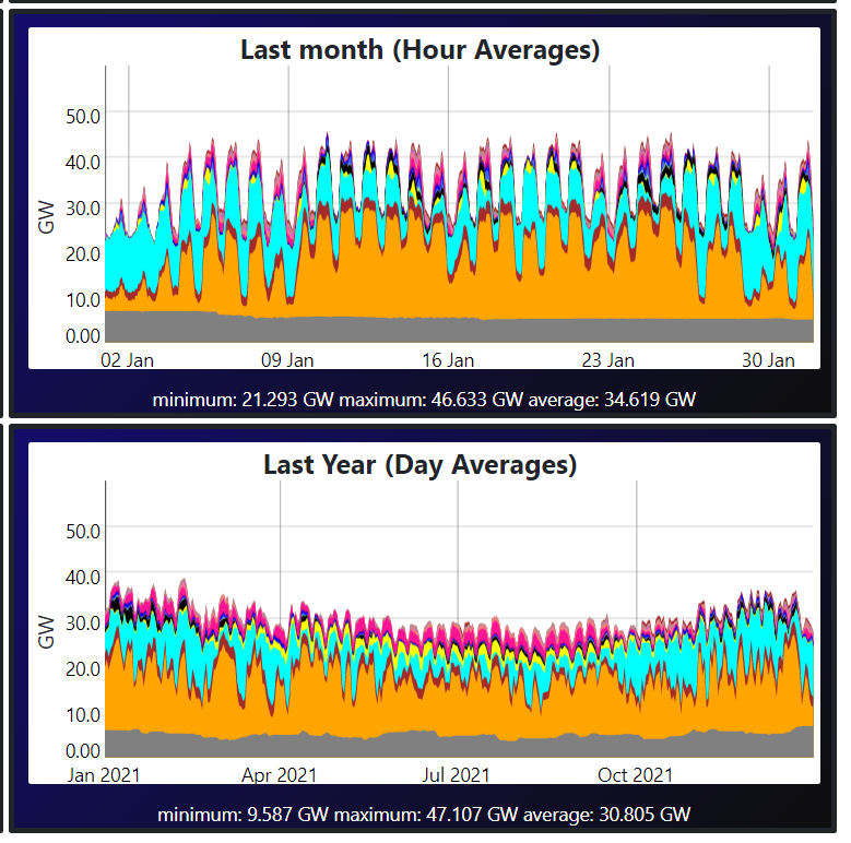

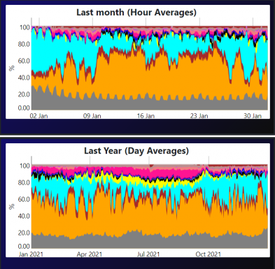

Ferdinand Posted February 15, 2022 Share Posted February 15, 2022 On 14/02/2022 at 12:58, epsilonGreedy said: On 14/02/2022 at 12:58, epsilonGreedy said: That could be down to 30-35% over the summer, and only go back to 40% at this time next year. What low carbon progress do you expect to arrive over the next year to achieve such a startling change in energy generation? The reality is that we will likely see a rise in carbon-based UK electricity generation because our nuclear capacity is being retired early with 1.4GW due to be lost this year. New wind farm capacity will only nudge the dial a percent or two each year, for example the biggest recent news in wind farms was Triton Knoll which took years to build and came online last year with 0.8GW capacity. It isn't startling imo. Let me take you through it. My samples of elec generation (=elec use as near as dammit) are Gridwatch graphs. I am taking the last month as a proxy for "winter" and the whole year as a proxy for the whole year. Percentages of elec supply. Gas fired is orange. Offshore wind is turquoise. https://gridwatch.co.uk/demand/percent Actual amounts in GWh: Assumptions 1 - The % share for gas / wind / nuclear in energy production over the year are something like 40%:30%:20%, judging by that - but let's work with my generous 50% guestimate for now for % of electricity made by gas. 2 - Total demand is about 35 GW in the winter, falling to 28GW in the summer - a fall of 20%. 3 - Offshore wind farm availability is now around 60%. ie a 1GW nameplate capacity windfarm will produce an average of .6GW output (Production Based Availability, which is the one relevant to total generation). https://www.ourenergypolicy.org/wp-content/uploads/2017/08/Definitions-of-availability-terms-for-the-wind-industry-white-paper-09-08-2017.pdf Generation of Electricity 4 - So eg Triton Knoll with 857 MW nominal capacity should produce something around 514 MW, or call it 0.5 GW. The first turbine there went active in Sept last year, and will be fully operational by end of Q1. 5 - There are two big wind farms coming on stream this year in addition to Triton Knoll. That is Hornsea 2 (1,386 MW nameplate capacity = .83 GW actual), and Moray East (950 MW nameplate capacity = .57 GW actual). 6 - In addition we now have an up to extra 1.4 GW actual supply from the North Sea Link, which was half turned on in Oct 2021, and is now fully active at 1.4 GW. This is 2 way so is available when we need it, and ditto Norway. 7 - Plus the burnt down French interconnector is due back online by Dec 2022. That is worth another 1 GW, and usually exports from France to us the majority of the time. 8 - So to set against the 1.4GW going offline with the nuclear, between Sep 21 and Dec 22 we have 1.9 GW actual which is ours coming on stream, and another up to 2.4GW which is available as required. Up to 4.3 GW overall. Gas Calc 9 - Now consider if Gas currently supplies my over-estimate of 50% of electricity, and Winter Demand is 35 GW. And summer demand is 28 GW. Gas therefore supplies around 17GW of electricity in winter, and 14 GW in summer (though the 12 months of data above argues that it is more like 14-15 GW and 11-11.5 GW respectively due to my generous 50% assumption). 10 - Our new coming-online resources are worth a conservative 3.5 GW of generation, which can switch directly out from gas, and on gas generation of 14 GW or 17 GW represent 20% of gas generated electricity in winter and -25% of gas generated electricity in summer. Halve those to get a % of the overall electricity supply and you get 10% or 12.5% shift from gas generated electricity to other sources. 11 - Which numbers, once we use the data from the graphs at the top, give a reduction in the 10-15% range ie Gas generated electricity falling to 35-40% from the current 50%. Which is very roughly where my estimate came from. 12 - I think my assumptions are quite central and balanced, and I have not factored in reduced usage from higher prices, or the amount usage has been ticking down each year. 13 - To take account of the nuclear 1.4 GW closure that I was unaware of, my 50% base case for the amount of electricity generated from gas is generous as pointed out - and reducing that just to 45%, which I suggest is still generous, will account for that difference. A 10-12.5% shift of gas generated electricity to the other sources I have identified will put it in the range 32.5-35%. 14 - There are a few things we can quibble about around the edges, such as the impact on the winter 22 numbers of the first 200 GW of Triton and the first part of North Sea link being onstream, but I think the reduction in gas share of electricity generated in 2022 is going to be significant. 15 - Which is why I think the Govt have been right to take a short-term attitude to mitigating price rises, as I think they need to be nimble due to rapid change happening. But I wish they had done something far simpler such as "the cap will not rise at all, we will provide medium term borrowing to the industry for the difference, and this is the new expanded insulation etc programme that will take the £150 of green taxes off bills whilst doing the renovation job 3-4x more quickly". Which would have kept it all out of the inflation rate, and be totally flexible. 16 - I guess one potential change is if electricity jumps up after COVID, but as we will not all be at home all day it cuts both ways. The highest demand increase prediction for 2022 I have seen is 3-4%, whilst the 4 GW approx new supply capacity is much larger. (As you know, I do not think that electric cars will drive up demand appreciably for several years.) F 1 Link to comment Share on other sites More sharing options...
epsilonGreedy Posted February 16, 2022 Share Posted February 16, 2022 @Ferdinandyou need to rework your projections and factor in the following: Total installed wind capacity in the UK is 24GW Peak wind output in 2021 was 14GW Average wind output was 5.6GW You are greatly overestimating net increase due to new wind farms. By 2028 the UK power insecurity period will be over but until then we are in for a difficult time. Re. The new link to Norway. Is this good news from either a kWh or CO2 perspective? Link to comment Share on other sites More sharing options...

Ferdinand Posted February 17, 2022 Share Posted February 17, 2022 10 hours ago, epsilonGreedy said: @Ferdinandyou need to rework your projections and factor in the following: Can you justify these numbers with a source before I rework, please? Happy to do so, however. Quote Total installed wind capacity in the UK is 24GW Accept that. 24.4 GW current wind nameplate power capacity. Quote Peak wind output in 2021 was 14GW This actually seems to be 17.6 GW, ie 25% higher than your number - though estimates such as we are doing need mean averages and totals, not peaks. On May 4 2021. https://www.theguardian.com/environment/2021/may/21/may-gales-help-britain-set-record-for-wind-power-generation Quote Average wind output was 5.6GW I make that more like 8.6 GW, which is 50+% higher than your number. Based on wind energy generated of 75,369 GWh (2020 Govt Environmental Accounts), divide by (24*365), gives a mean average power output of 8.60 GW. Quote You are greatly overestimating net increase due to new wind farms. By 2028 the UK power insecurity period will be over but until then we are in for a difficult time. Are you missing that Offshore wind has a far higher capacity factor than Onshore wind, and all the new fields are offshore? For offshore it is 46% - just under half, and for onshore it is 28%. For new offshore wind coming on stream it is higher, which is why I use 0.5 or 50% in my estimate. Quote Re. The new link to Norway. Is this good news from either a kWh or CO2 perspective? Seems so to me. 1 - In resilience terms, we get a new stable source of elec,which is overwhelmingly low carbon - 90%+ in No is hydro. Part of teh answer to "occasionally no wind, sometimes no sun"? 2 - In C02 terms that's clearly a benefit. National Grid have an animated presentation of live. Nat Grid say they save 3 million tonnes a year, even without full data from the new one. data: https://www.nationalgridcleanenergy.com/powerofnow/ 3 - In kWh, it is extra capacity if required - at a time when we are seeking to increase renewable supply availability. 4 - In £, it is a more open market, and aiui Norway Link gives us access to another pricing pool. Plus I see no reason why we can't end up being more of an exporter over say 8-15 years. 5 - Politically, diversity of supply has to be good, surely? I'll avoid politics, however, beyond noting Mr Macaron's efforts to use it as a political lever - electricity being France's 2nd or 3rd largest export to the UK. There's quite an interesting pipeline of interconnectors coming on stream (somewhat old list, and I'd expect some of these to fail): https://www.ofgem.gov.uk/energy-policy-and-regulation/policy-and-regulatory-programmes/interconnectors F 1 Link to comment Share on other sites More sharing options...
SteamyTea Posted February 17, 2022 Share Posted February 17, 2022 (edited) 26 minutes ago, Ferdinand said: I make that more like 8.6 GW, which is 50+% higher than your number. Based on wind energy generated of 75,369 GWh (2020 Govt Environmental Accounts), divide by (24*365), gives a mean average power output of 8.60 GW. What I made it as well, for 2020. Edited February 17, 2022 by SteamyTea Link to comment Share on other sites More sharing options...
epsilonGreedy Posted February 17, 2022 Share Posted February 17, 2022 41 minutes ago, Ferdinand said: Can you justify these numbers with a source before I rework, please? Happy to do so, however. Your original post lead with data from GridWatch and I chose to debunk your predictions by exclusively using data from GridWatch. In response you now cherry pick from multiple sources including the Guardian. Rampant gas price inflation and astonishing kWh price inflation illustrate that wind is not yet delivering what you claim. There is a 5 to 10 year gap between reality and your happy clappy tree hugger view of the world. That reality gap is causing real suffering millions of Britons. Link to comment Share on other sites More sharing options...
SteamyTea Posted February 17, 2022 Share Posted February 17, 2022 40 minutes ago, epsilonGreedy said: Your original post lead with data from GridWatch and I chose to debunk your predictions by exclusively using data from GridWatch I seem to remember that Gridwatch does not meter all generation, certainly the case with PV. What total wind generation are you getting for 2019 and 2020? Link to comment Share on other sites More sharing options...
epsilonGreedy Posted February 17, 2022 Share Posted February 17, 2022 2 hours ago, SteamyTea said: I seem to remember that Gridwatch does not meter all generation, certainly the case with PV. GridWatch is just a weekend side project run by an enterprising computer programmer. He publishes data from industry realtime feeds. The PV data is synthetic produced by a model created by Sheffield University. GridWatch wind data should be good. 2 hours ago, SteamyTea said: What total wind generation are you getting for 2019 and 2020? https://gridwatch.co.uk/Wind Link to comment Share on other sites More sharing options...
