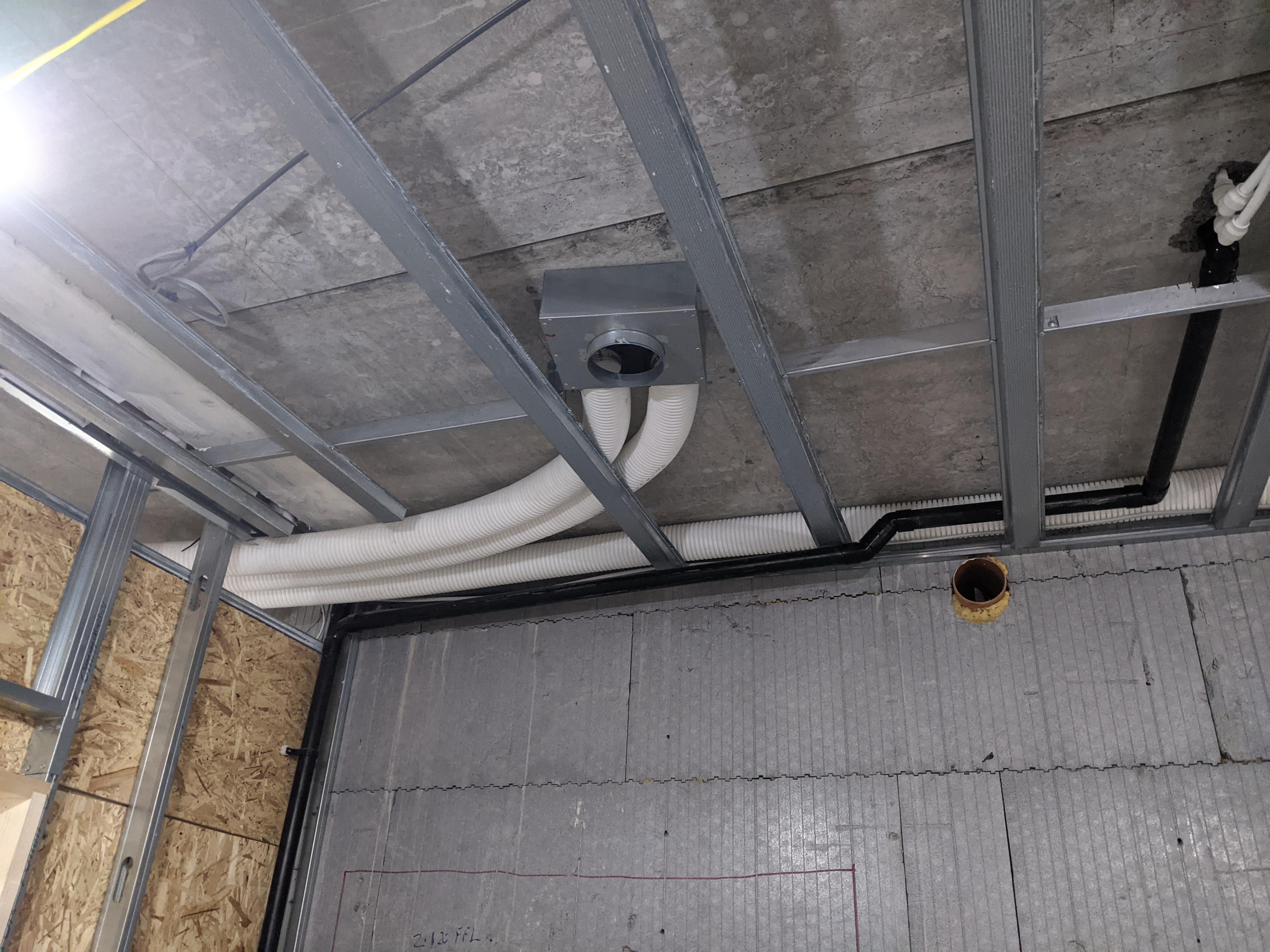

MJNewton Posted February 4, 2022 Posted February 4, 2022 Semi rigid, not least given that kine was a retrofit and rigid would've been impossible. I'm not sure of the benefits of rigid though - semi rigid seems to tick so many boxes in terms of ease of use, absence of joins etc.Â
Russdl Posted February 4, 2022 Posted February 4, 2022 Semi rigid if you’re doing it yourself, its easy - depending on the house build of course. Â

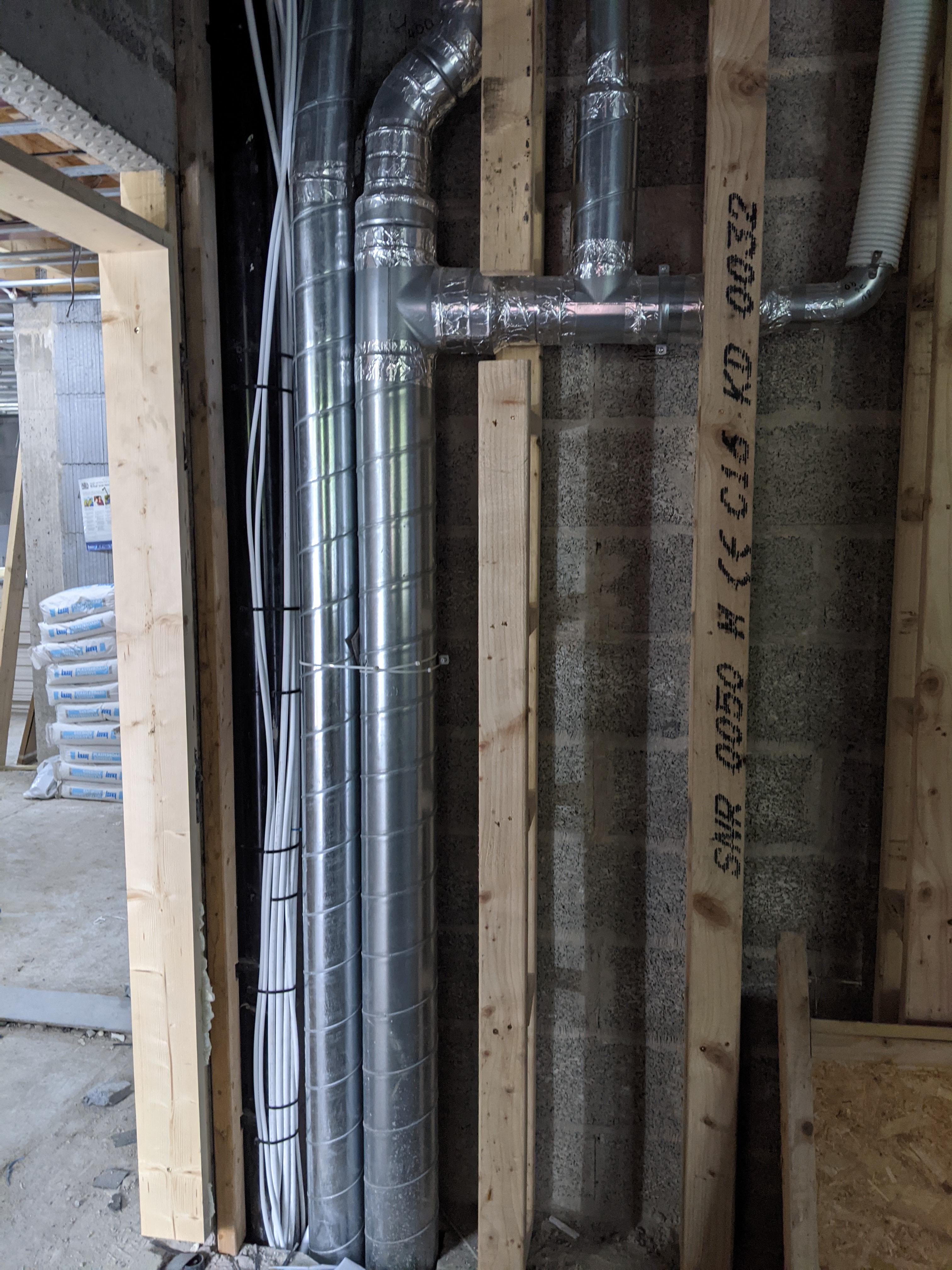

Conor Posted February 5, 2022 Posted February 5, 2022 I did a mix of both as we have a three story building. I used a mix of 160 and 125mm galvanised ducts to each floor. Then branched off using tees to semi rigid or to a manifold then semi rigid. Advantage is lower pressure losses an quieter system. Disadvantages, much more time consuming to install.
JohnMo Posted February 5, 2022 Posted February 5, 2022 Semi rigid 90mm via plenum box. Ease of DIY install, but also very quiet in use and no cross talk. Most of mine is also going through Posi rafters and there was not enough room to install rigid.  If doing rigid, use metal pipes only, most plastic bends the radius this too tight and you get a large pressure drop. Blumberg may be the exception, as their bends have a larger radius. You will also need an attenuator at each outlet to stop cross talk.

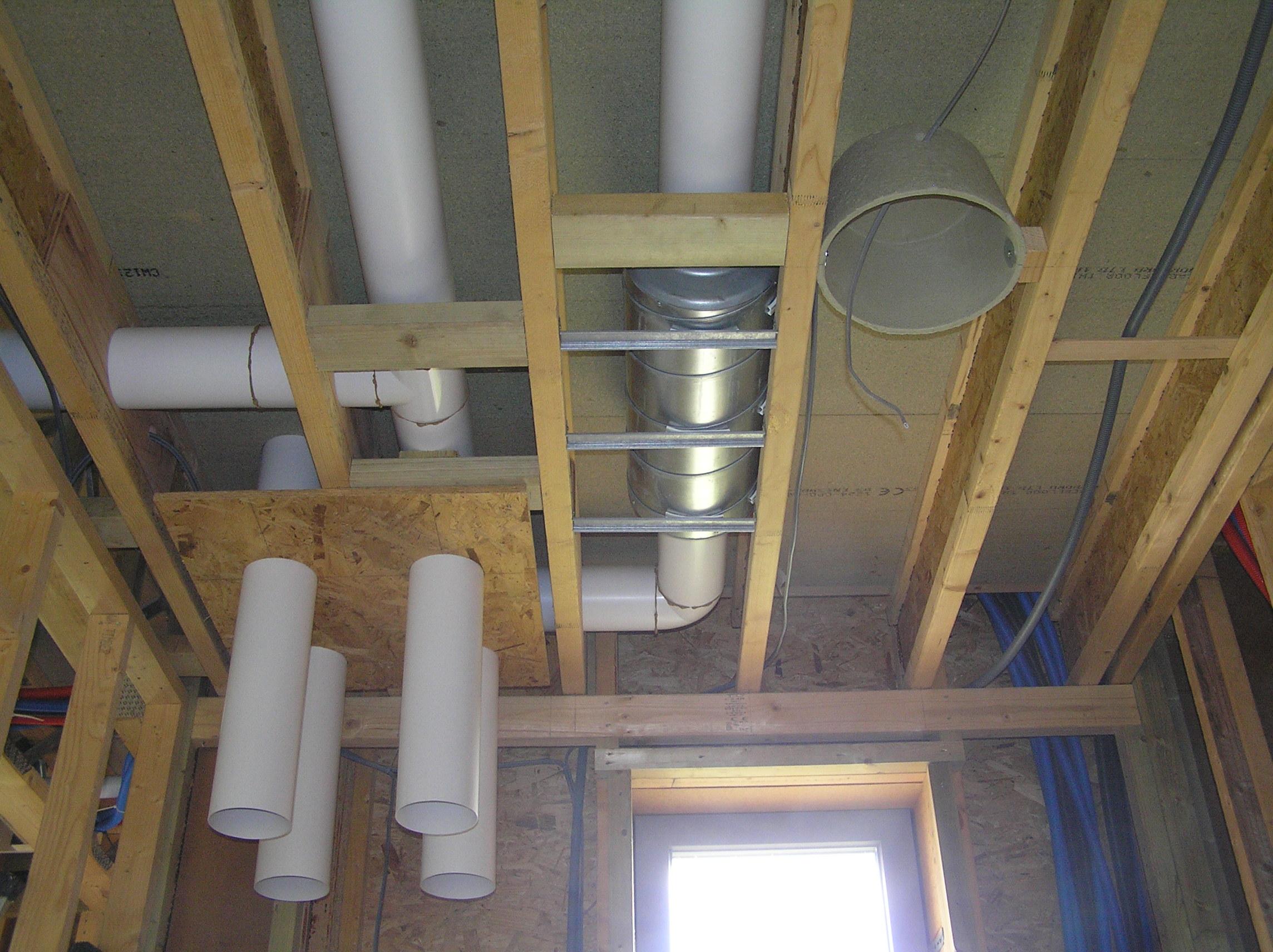

Gone West Posted February 5, 2022 Posted February 5, 2022 10 hours ago, SBMS said: For those who have installed MVHR which route did you go down? I designed a branch system using rigid plastic ducting. Â Â 2

gavztheouch Posted February 5, 2022 Posted February 5, 2022 7 hours ago, Conor said: I did a mix of both as we have a three story building. I used a mix of 160 and 125mm galvanised ducts to each floor. Then branched off using tees to semi rigid or to a manifold then semi rigid. Advantage is lower pressure losses an quieter system. Disadvantages, much more time consuming to install. Hi Conor, what size is your flexible duct 75mm or 90mm? Â Â
crispy_wafer Posted February 5, 2022 Posted February 5, 2022 6 hours ago, Gone West said: I designed a branch system using rigid plastic ducting.    How does the plastic piping interface with the metal silencers, any issues? I'm planning on doing similar but without getting my hands on stuff it's hard to know about how interchange the plastic is with metal fittings. Could I ask what sealant you have used on the pipe joins please? Â
Gone West Posted February 5, 2022 Posted February 5, 2022 1 minute ago, crispy_wafer said: How does the plastic piping interface with the metal silencers, any issues? I'm planning on doing similar but without getting my hands on stuff it's hard to know about how interchange the plastic is with metal fittings. Could I ask what sealant you have used on the pipe joins please? It was a while ago now but IIRC the metal silencer had a rubber 'O' ring on the outside which sealed against the inside of the ducting and I don't remember any problems. I bought all the ducting etc from i-sells. I used Titebond PU gel adhesive to to glue the ducting together. https://www.axminstertools.com/titebond-greenchoicetm-polyurethane-construction-adhesive-311ml-952217  1
gavztheouch Posted February 5, 2022 Posted February 5, 2022 3 hours ago, Conor said: @gavztheouch 90mm (76mm internal diam) ? thanks

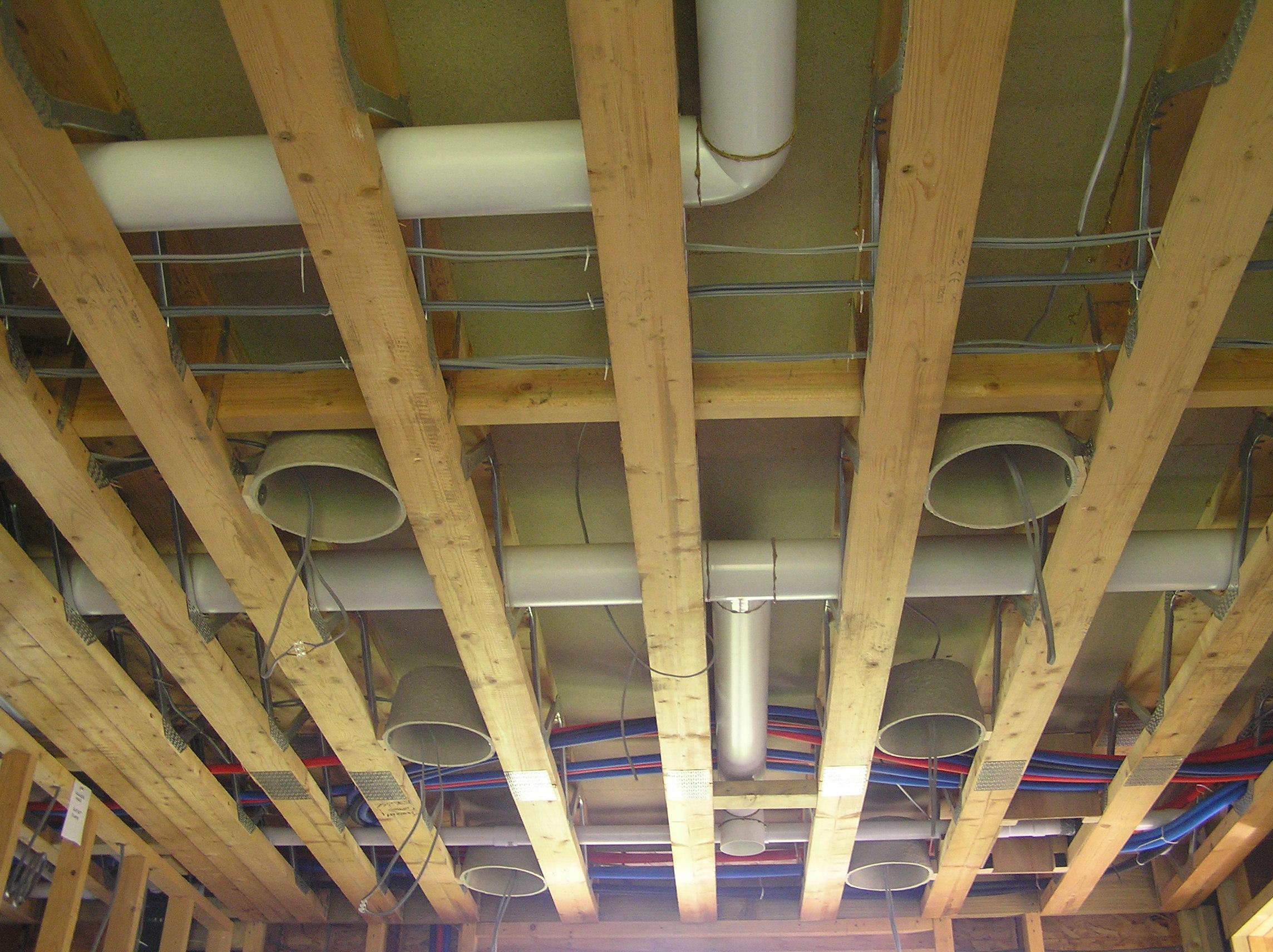

Rishard Posted March 13, 2022 Posted March 13, 2022 @Gone West- not an mvhr question but, What are the bowl looking things you have your lighting cables running into in your voids? Thanks

Nickfromwales Posted March 13, 2022 Posted March 13, 2022 (edited) 26 minutes ago, Rishard said: @Gone West- not an mvhr question but, What are the bowl looking things you have your lighting cables running into in your voids? Thanks Intumescent fire hoods for lighting. They offer some acoustic benefits also, as they are fully encapsulating the fitting, plus the acoustic insulation can go over / all around them. Edited March 13, 2022 by Nickfromwales

Gone West Posted March 14, 2022 Posted March 14, 2022 15 hours ago, Rishard said: @Gone West- not an mvhr question but, What are the bowl looking things you have your lighting cables running into in your voids? Thanks They are plain compressed glass fibre hoods, not intumescent fire hoods, that I used for all my downlighters. I used them to keep the insulation away from the lights. I bought them from TLC many years ago but they don't seem to sell them any longer. They were about 250 to 300mm diameter IIRC.
