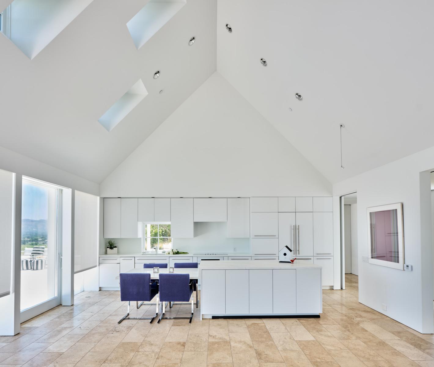

PaddyP Posted February 2, 2022 Posted February 2, 2022 Hi there I hope you are all keeping well. I am currently looking the roof design of our house. We are trying to achieve a vaulted ceiling in the open plan area. This area measure 5m wide x 12m long. We are trying to achieve a full height pointed apex and on the ceiling and not have a flat piece at the top. The picture below shows the finish we are trying to achieve. However, most people appear to have a flat bit at the apex rather than a point. In many cases this is to hide MVHR pipes. We will also have MVHR in the build so wondering is there an alternative? How can we achieve full height apex ceiling and still have space for services? Some options I have come across are scissors trusses and parallel chord trusses. Are these viable options or am I barking up the wrong tree? Any opinions links, pictures etc are greatly appreciated!

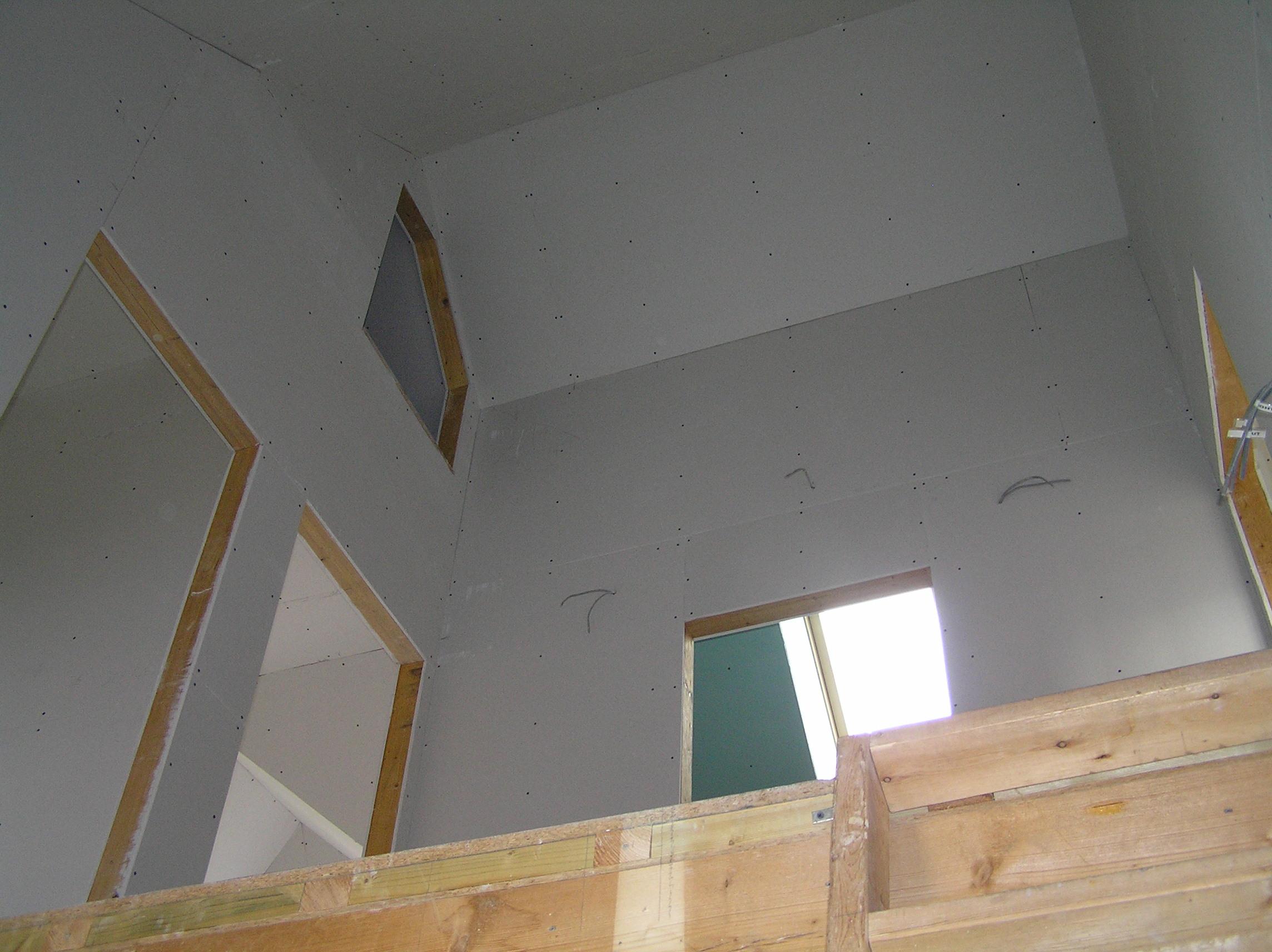

Ralph Posted February 2, 2022 Posted February 2, 2022 (edited) We had the same issue, we did not realise there was a flat piece until it was up. It was to accommodate the steal. What we ended up doing is using it for lights. It does not bother me but it bugs my wife. Edited February 2, 2022 by Ralph

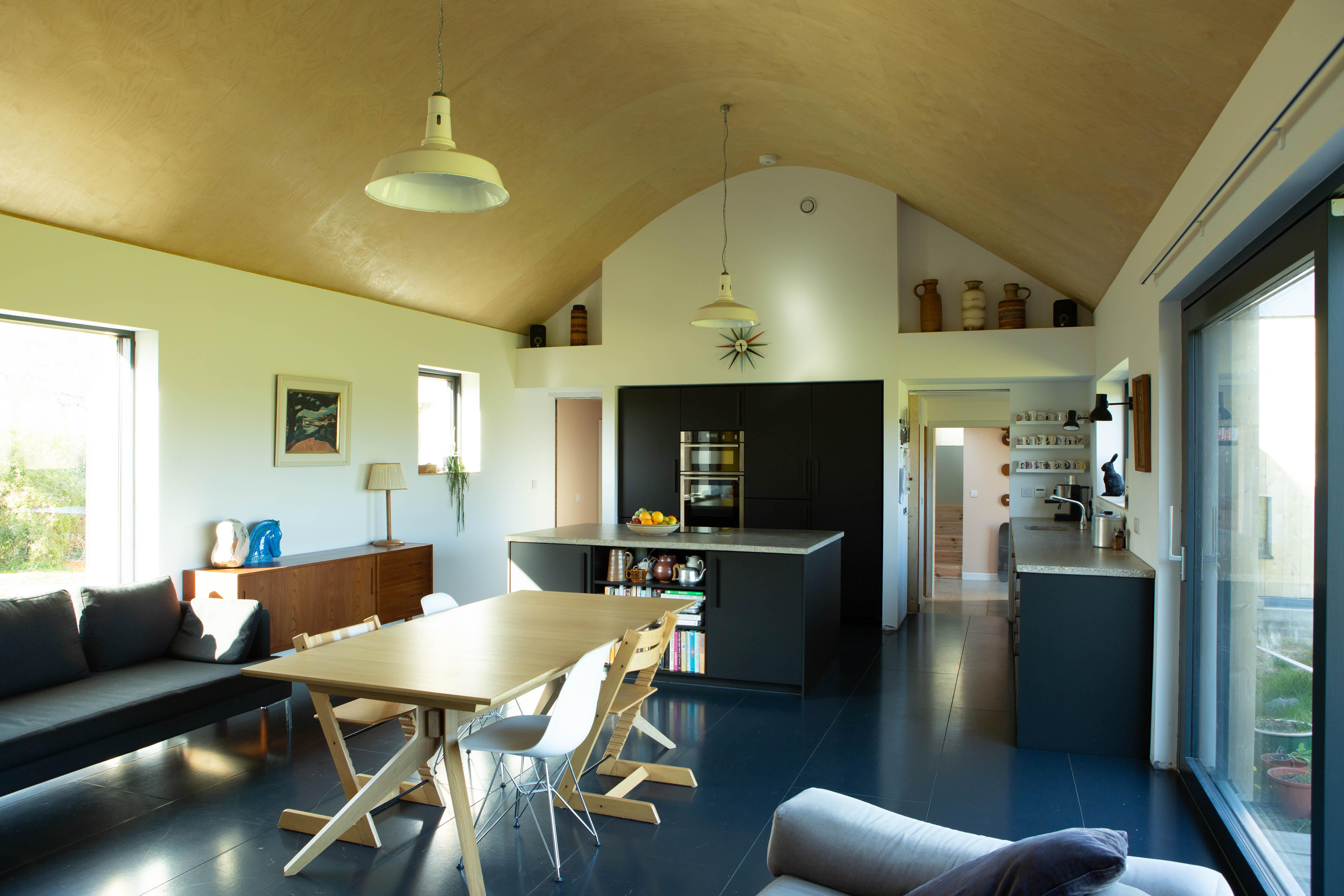

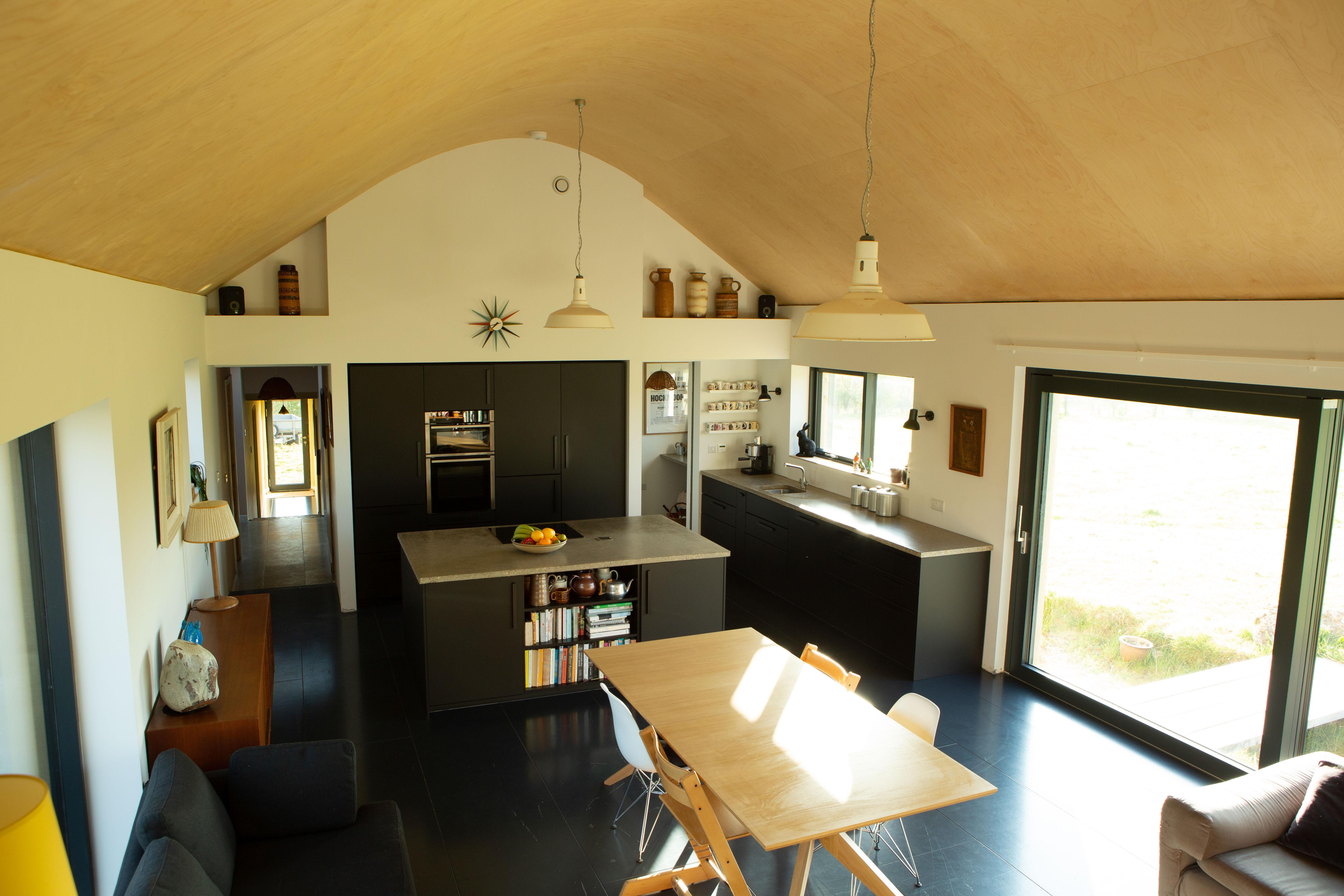

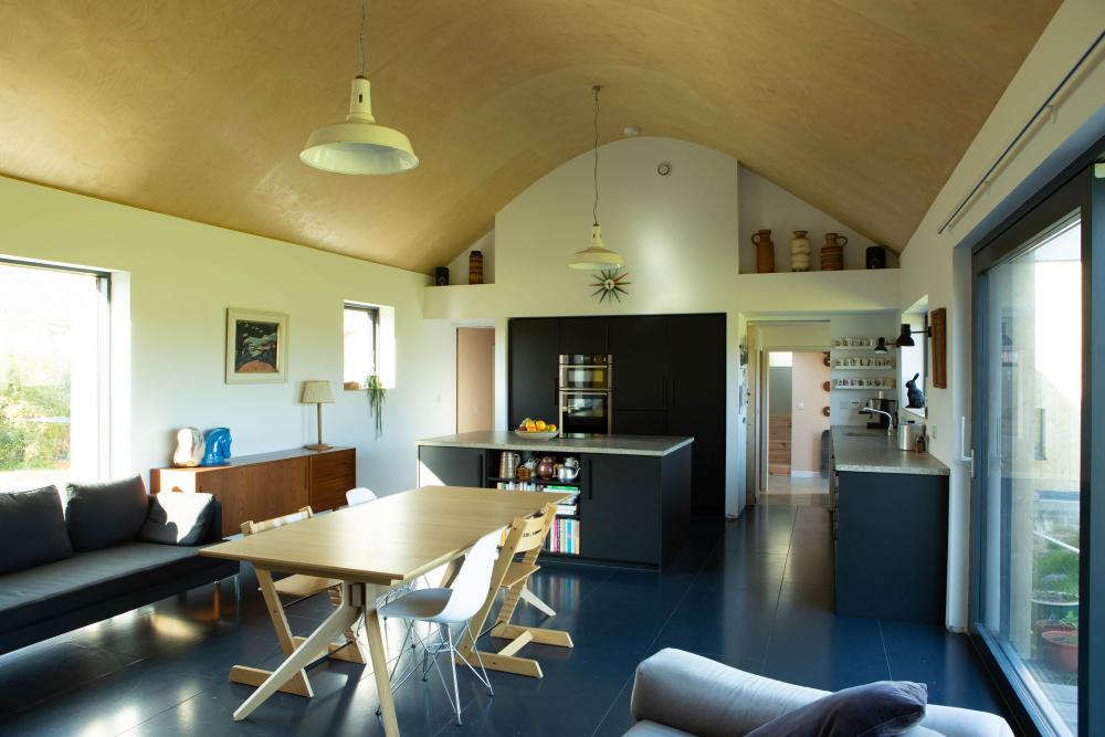

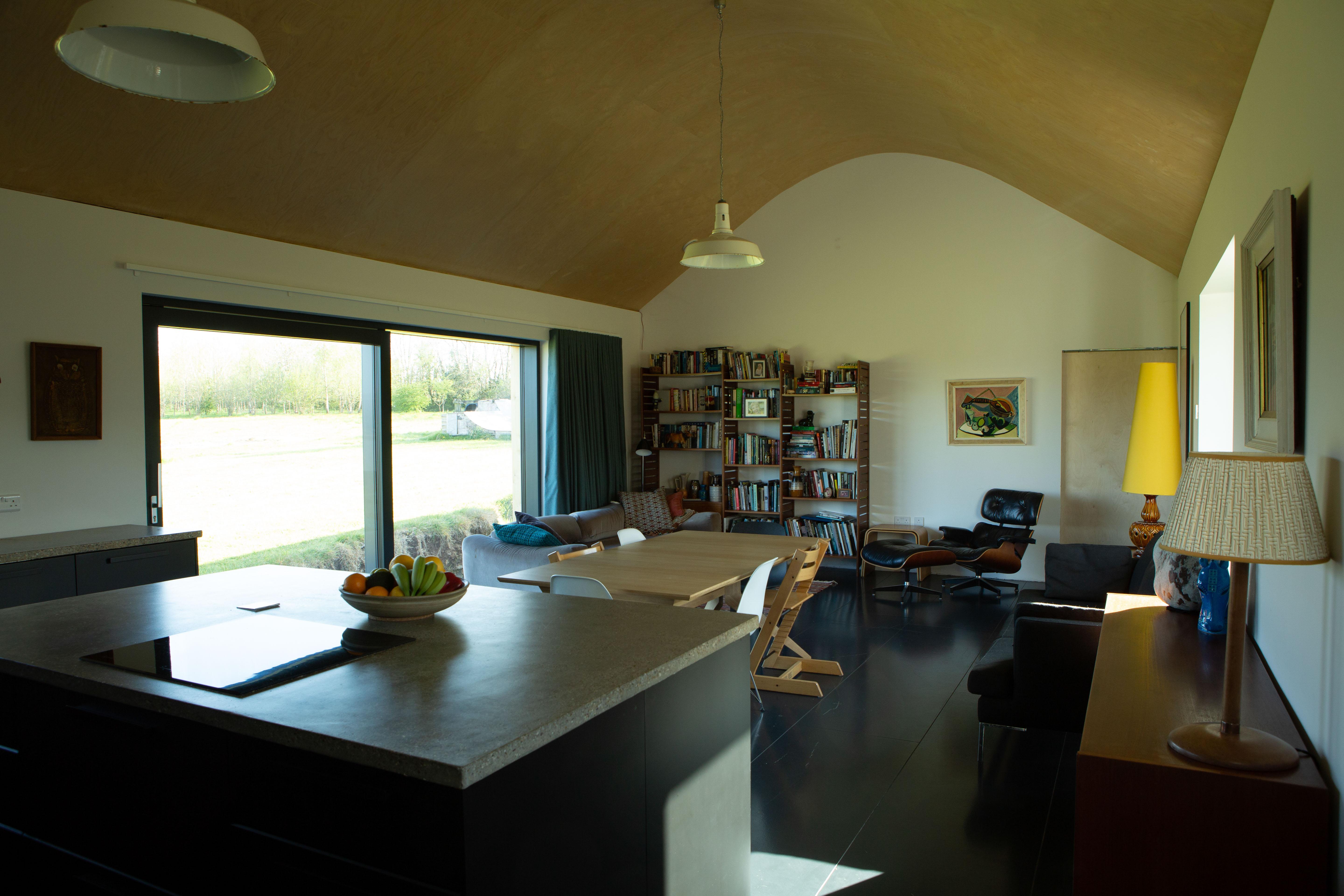

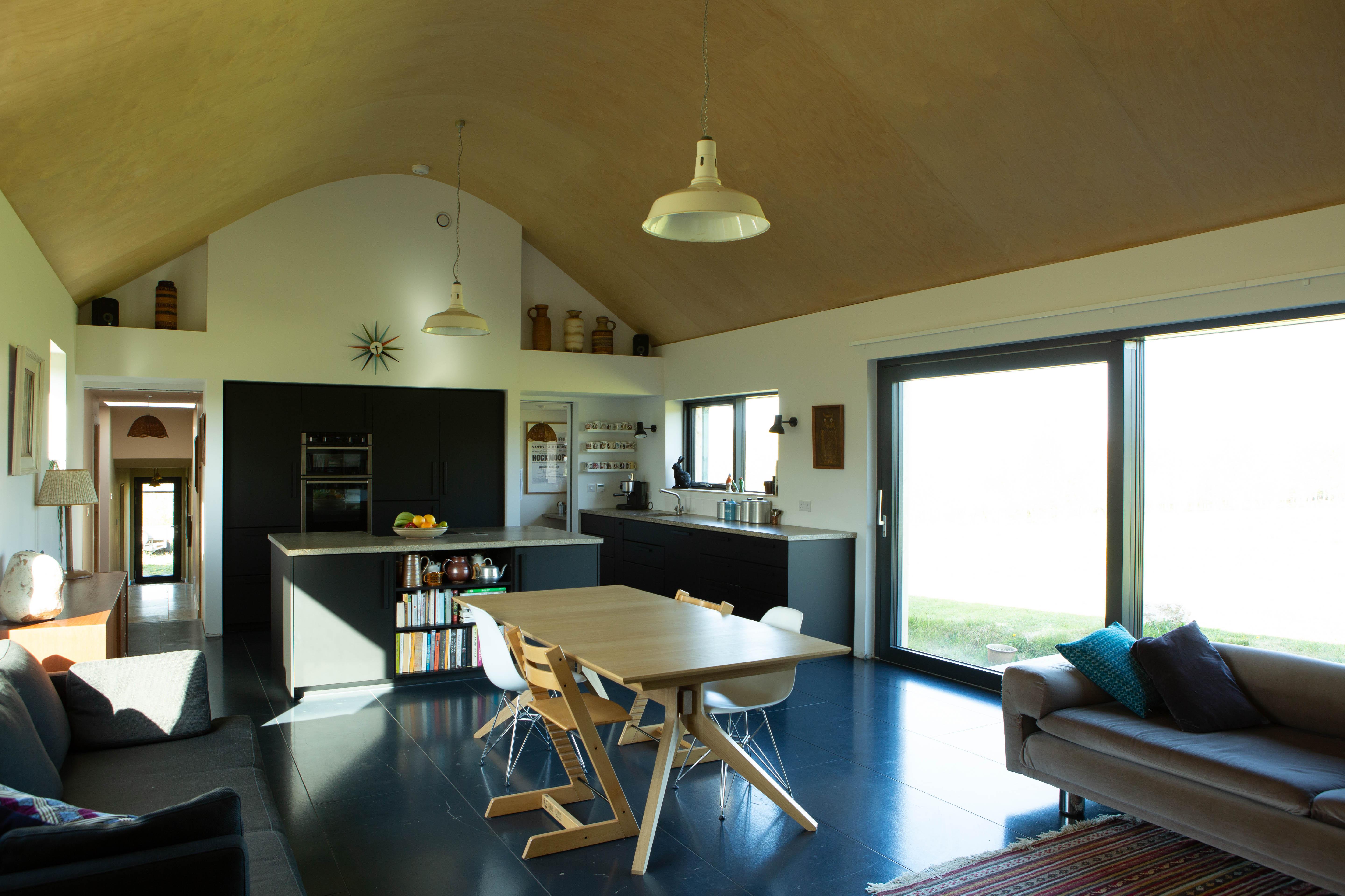

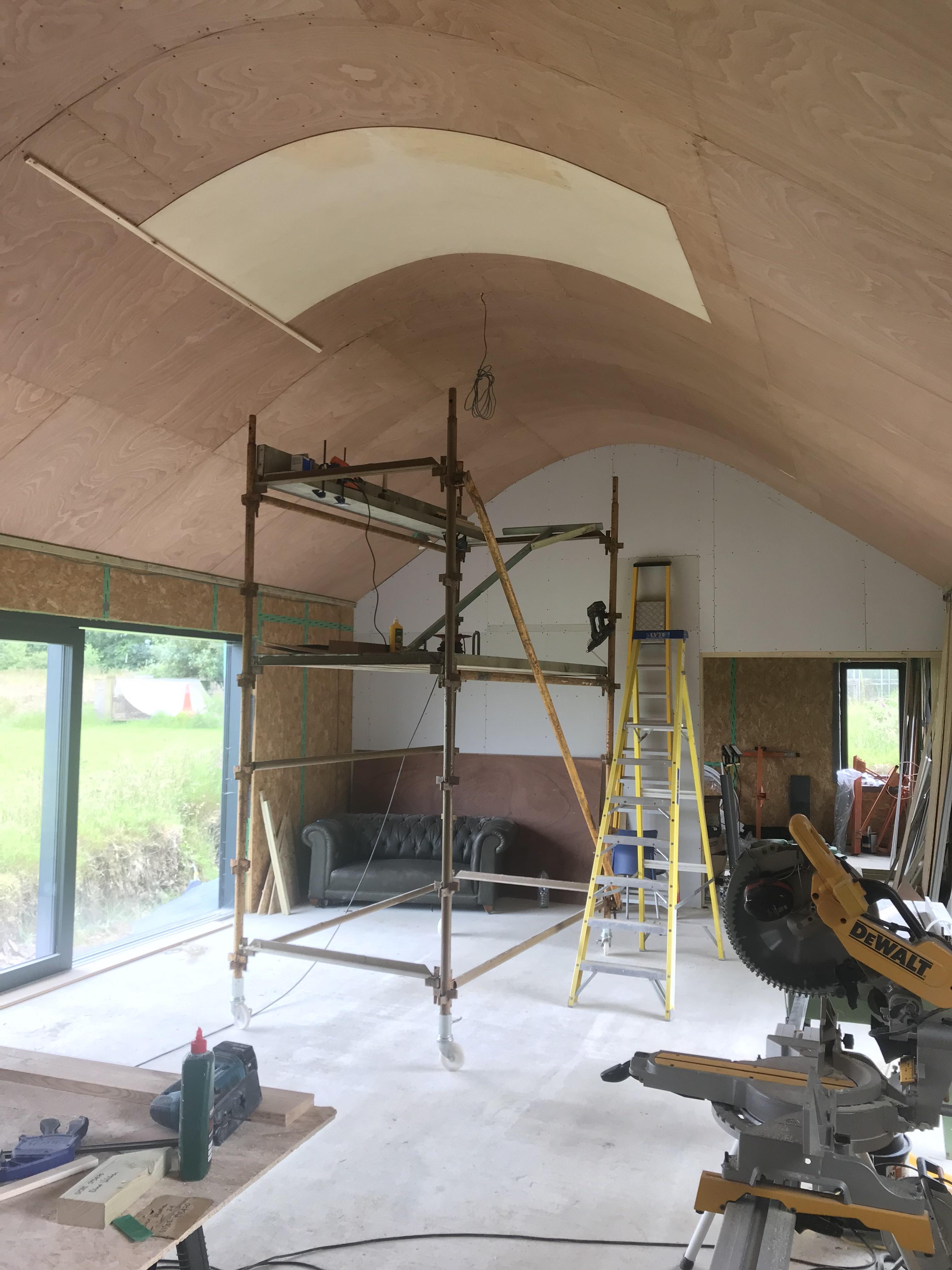

Nestor Posted February 2, 2022 Posted February 2, 2022 I had similar issues trying to avoid a large steel ridge and MVHR pipe work. I decided on building a curve using birch plywood. 3
Ralph Posted February 2, 2022 Posted February 2, 2022 37 minutes ago, PaddyP said: Hi @Ralph that looks a great space. From your picture it is difficult to see the flat piece at all. Thanks, like a lot of things when building a house it seemed like a big issue and a compromise at the time but it pales into insignificance with all the other stuff you end up dealing with. 1

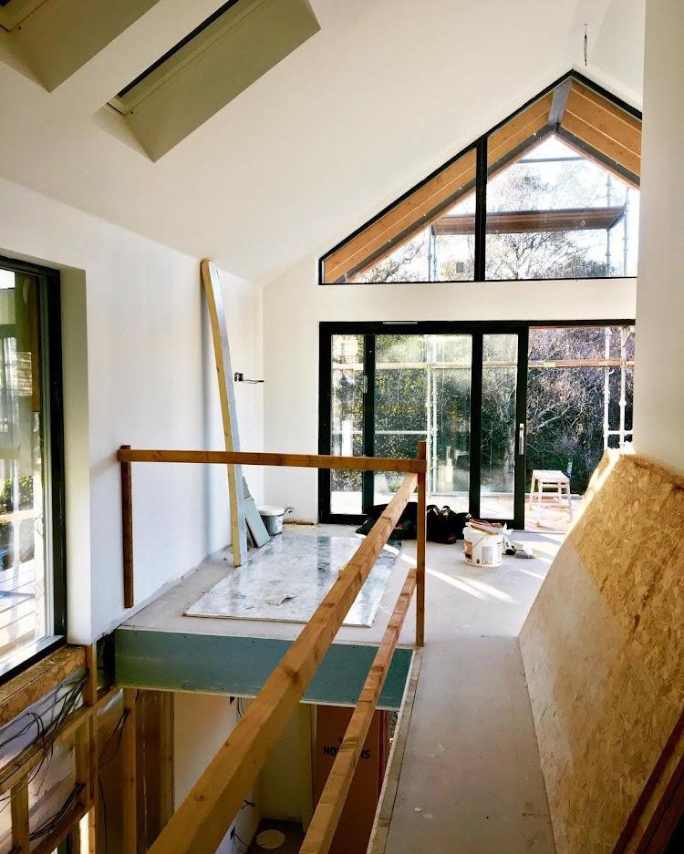

JohnMo Posted February 2, 2022 Posted February 2, 2022 We have a flat section at the apex, but it's painted white, there are no lights pointing at the apex, so you just don't notice what up there. The big windows at the front grab the attention. Long spans equal either structural steel or glulam beams. Our glulam beam are 450mm deep. So even with 350mm insulation, you still end up with a small flat spot. We are Scotland and the outside is covered in sarking board, breather membrane, then slates.
Annker Posted February 3, 2022 Posted February 3, 2022 @JamesP That ceiling looks well done. How did they get on with bending the ply to the curve that cant have been easy, did you use flexi-ply?
Chanmenie Posted February 3, 2022 Posted February 3, 2022 15 hours ago, Ralph said: We had the same issue, we did not realise there was a flat piece until it was up. It was to accommodate the steal. What we ended up doing is using it for lights. It does not bother me but it bugs my wife. loving the minimalistic hand rails ?

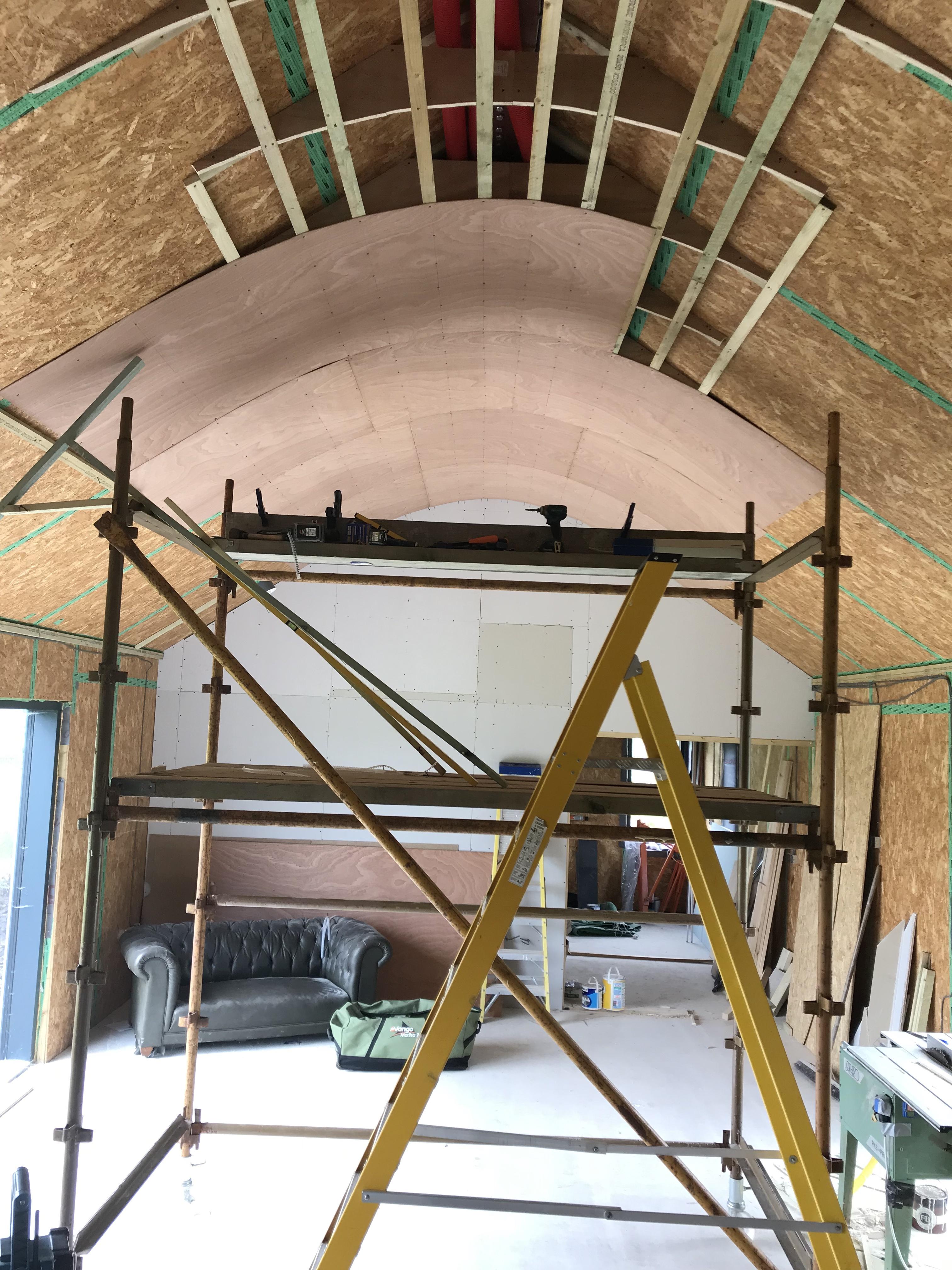

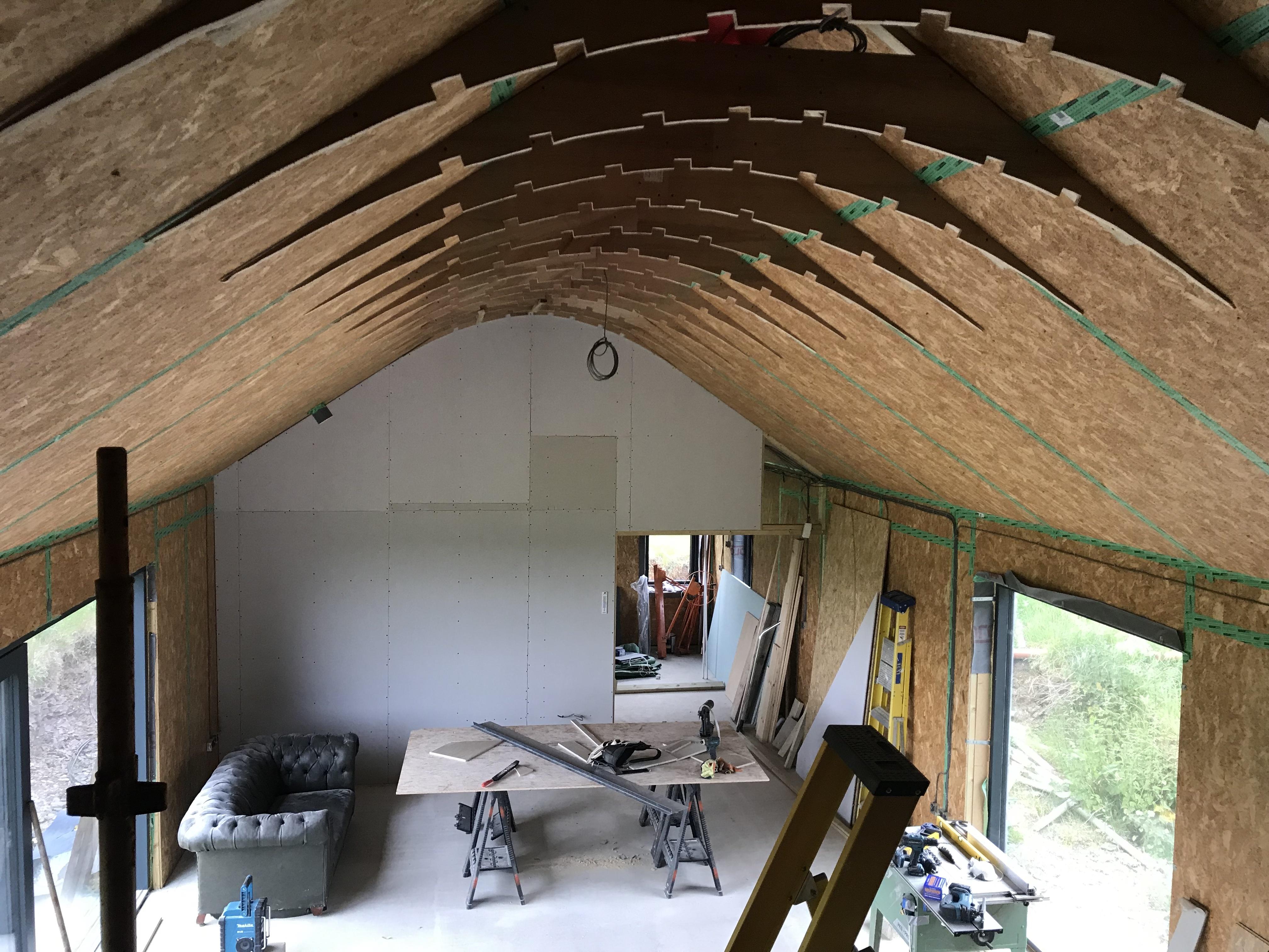

Nestor Posted February 3, 2022 Posted February 3, 2022 1 hour ago, Annker said: @JamesP That ceiling looks well done. How did they get on with bending the ply to the curve that cant have been easy, did you use flexi-ply? I made a frame similar to a skateboard half pipe on the ceiling then fitted a layer of red faced ply followed by glued and pinned 4mm birch ply, it was a challenge. I have built most of the house myself excluding electrics and skimming. 3

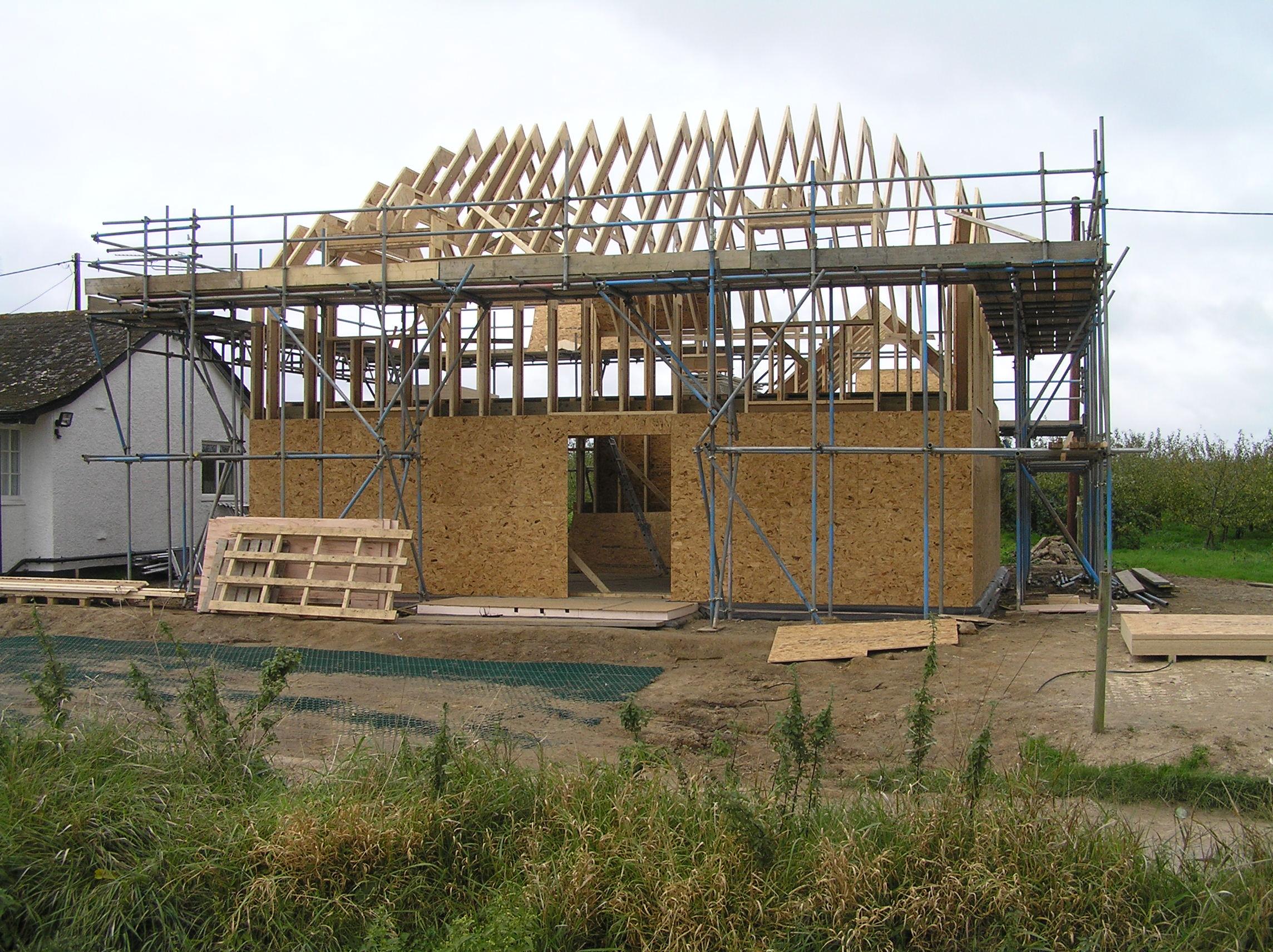

SimonD Posted February 3, 2022 Posted February 3, 2022 (edited) 20 hours ago, PaddyP said: We are trying to achieve a full height pointed apex and on the ceiling and not have a flat piece at the top. In a previous project, I had a SE, my father in law actually, who spent most of his life designing large steel and concrete buildings, design a steel frame for this. He designed some steel trusses that were tied at the ridge, negating any need for ties anywhere else, so left the whole space open. This solution also got rid of the need for a large ridge beam. In our case we had one large central truss and two smaller ones at each end of the building supporting smaller steel purlins, and cross braced (to provide racking strength) with small steels in tension on a diagonal from ridge to bottom corner. The span was about 7m compared to your 5m and for the length you could just add several steel trusses. Edited February 3, 2022 by SimonD

Annker Posted February 3, 2022 Posted February 3, 2022 @JamesP Well done. I'm a carpenter myself and did a bit of curved work over the past year. Doing it to a high standard separates the men from the boys! 1

PaddyP Posted February 7, 2022 Author Posted February 7, 2022 @JamesP your ceiling looks fantastic! Love the exposed timber. Real attention to detail required there! Hi @JohnMo thanks a million for those pictures. Great to see that the flat bit is barely noticable. Thank you everyone for their help. I will speak with the structural engineer and see what they reckon. Has anyone used scissors trusses? While the flat bit is barely noticeable I still would like to avoid it if I can without too much additional cost and effort. 1
