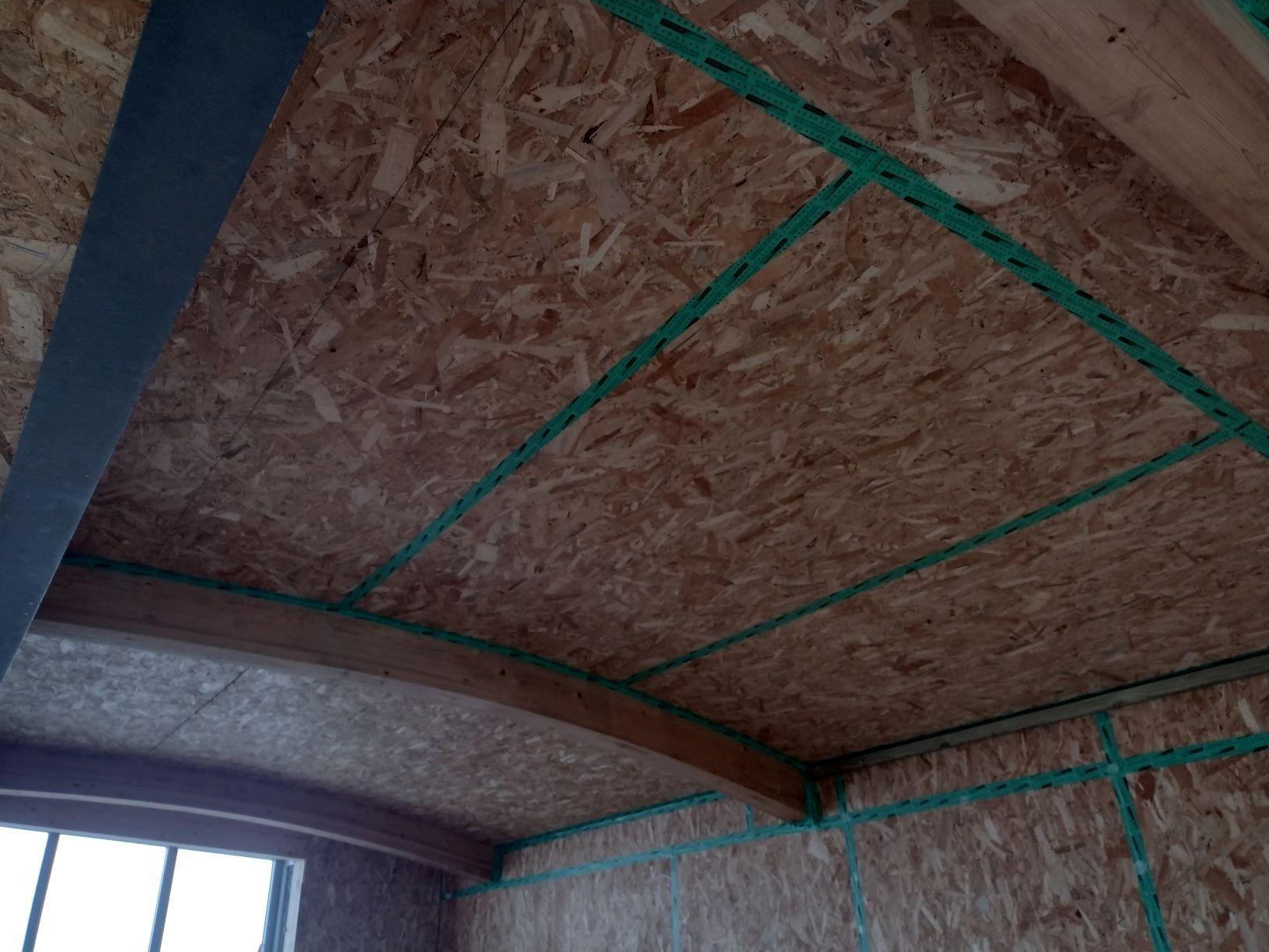

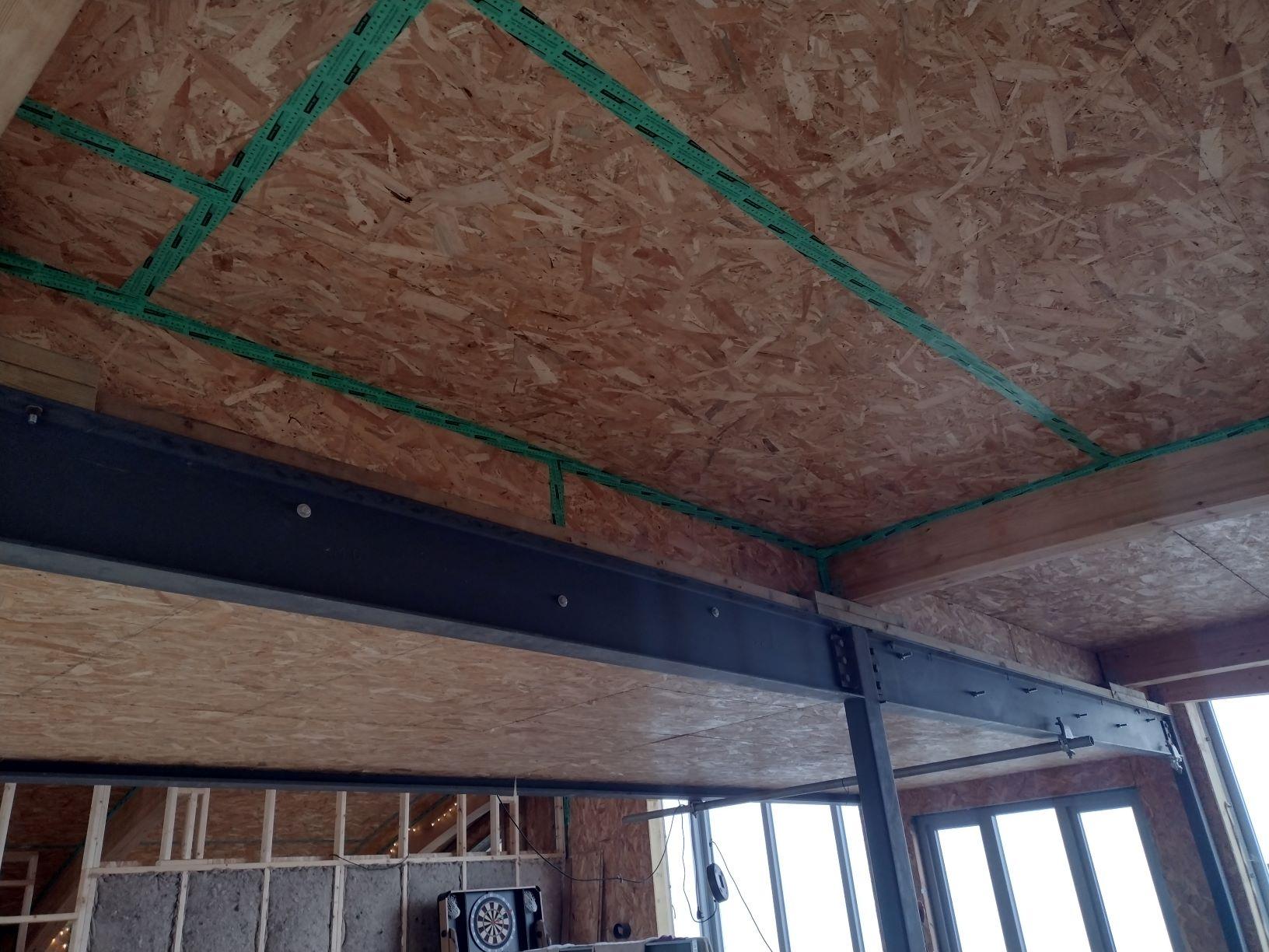

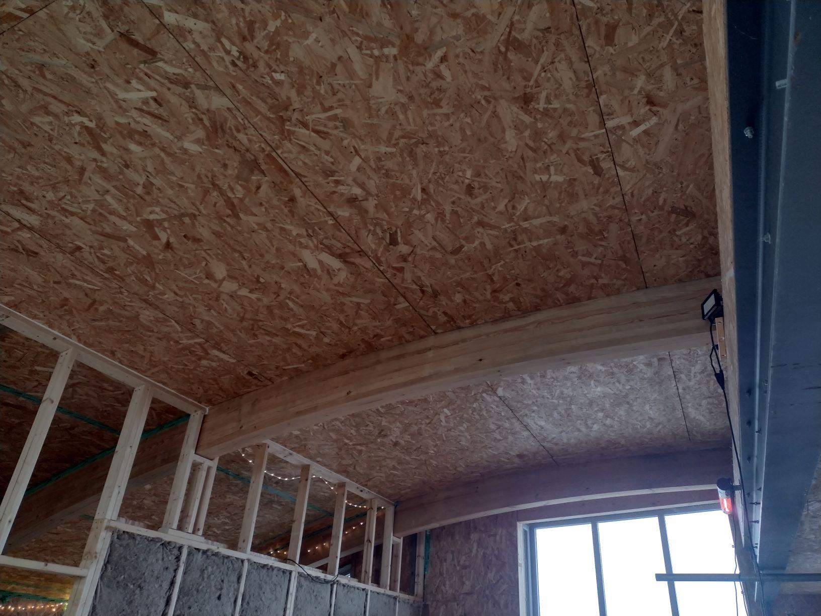

SimonD Posted January 27, 2022 Posted January 27, 2022 I'm currently looking to get the electrician in soon to do the 1st fix electrics but we're really struggling with the lighting design so don't quite know exactly what we want. We have a vague idea but some areas like the huge vaulted curved ceilings, we could actually do with experimenting with various lighting arrangements first. Can anyone recommend a strategy to get the 1st fix largely done that leaves flexibility for finalising lighting design, but won't cause too much frustration with the sparky? Many thanks.
nod Posted January 27, 2022 Posted January 27, 2022 If you are paying on a day rate He will be happy to help you design and move lights around If hes on a price He will expect a drawing and be able to crack on 1

ProDave Posted January 27, 2022 Posted January 27, 2022 As long as the electrician is doing "loop at switch" wiring, which is pretty normal these days, then all you need to decide right now is how many light circuits in each room, and then in your vaulted ceiling room just leave a long length of the switched light feed cable(s) ready to be positioned before the ceiling covering goes on, once you have decided what you want. Decision time is just before plasterboard or other ceiling covering goes on. 1 1

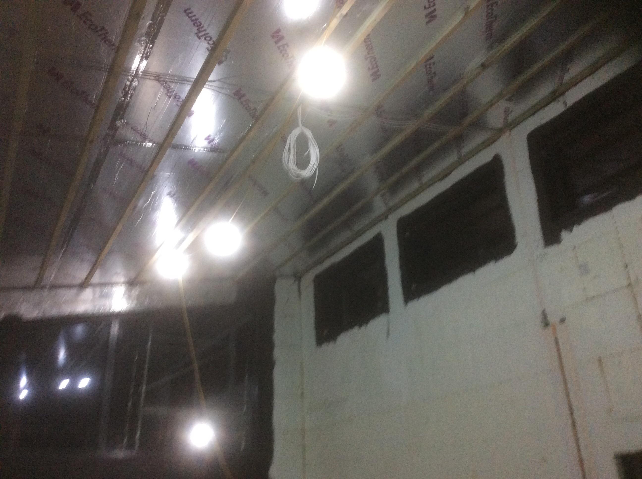

cwr Posted January 27, 2022 Posted January 27, 2022 (edited) 2 hours ago, SimonD said: I'm currently looking to get the electrician in soon to do the 1st fix electrics but we're really struggling with the lighting design so don't quite know exactly what we want. We have a vague idea but some areas like the huge vaulted curved ceilings, we could actually do with experimenting with various lighting arrangements first. Can anyone recommend a strategy to get the 1st fix largely done that leaves flexibility for finalising lighting design, but won't cause too much frustration with the sparky? Many thanks. Exactly the same predicament we're in right now, electrician starts on Monday, boarding 2 weeks later. Going for recessed spots in our vaulted ceiling (anyone got some nice pics of what they've done?) and will ask electricians to runs wires in straight lines between them to buy us a couple of weeks in case we change our mind on how many to go in, albeit committed to only having them in front of where the wires are. Edited January 27, 2022 by cwr

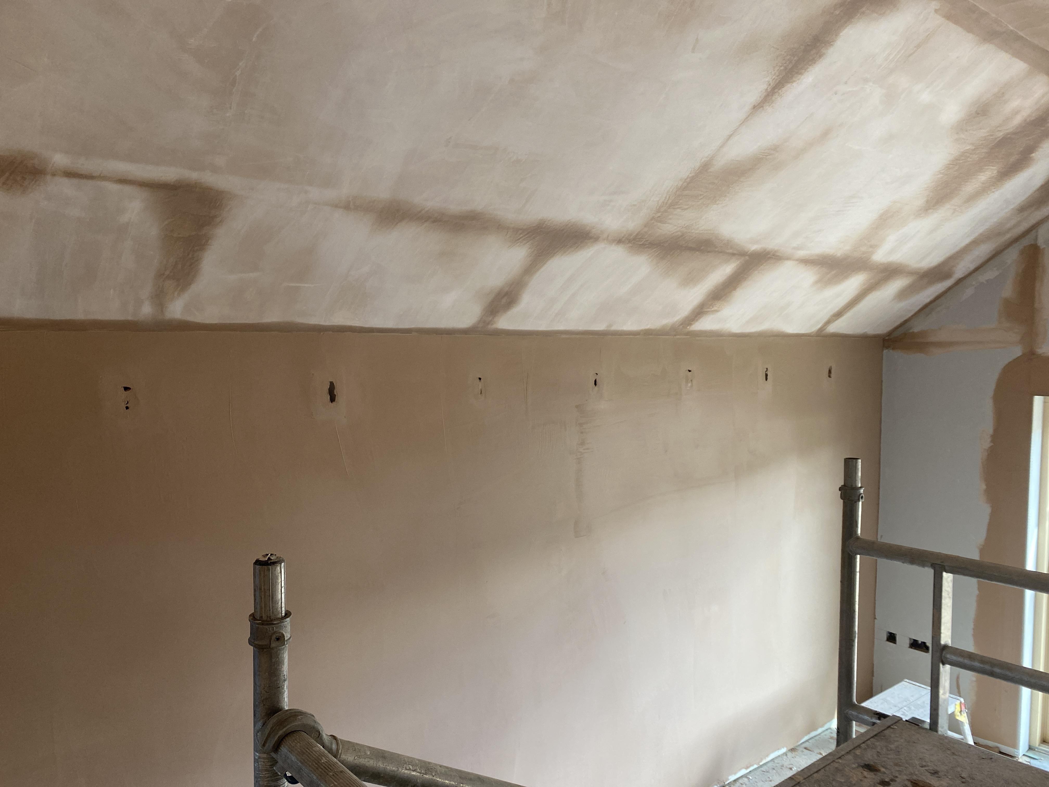

Russell griffiths Posted January 27, 2022 Posted January 27, 2022 (edited) Cables run but location to be confirmed. Probably about 10 minutes before the ceiling goes up. ??♂️ Excuse the crappy pic. Phone really didn’t like those lights. Edited January 27, 2022 by Russell griffiths 1

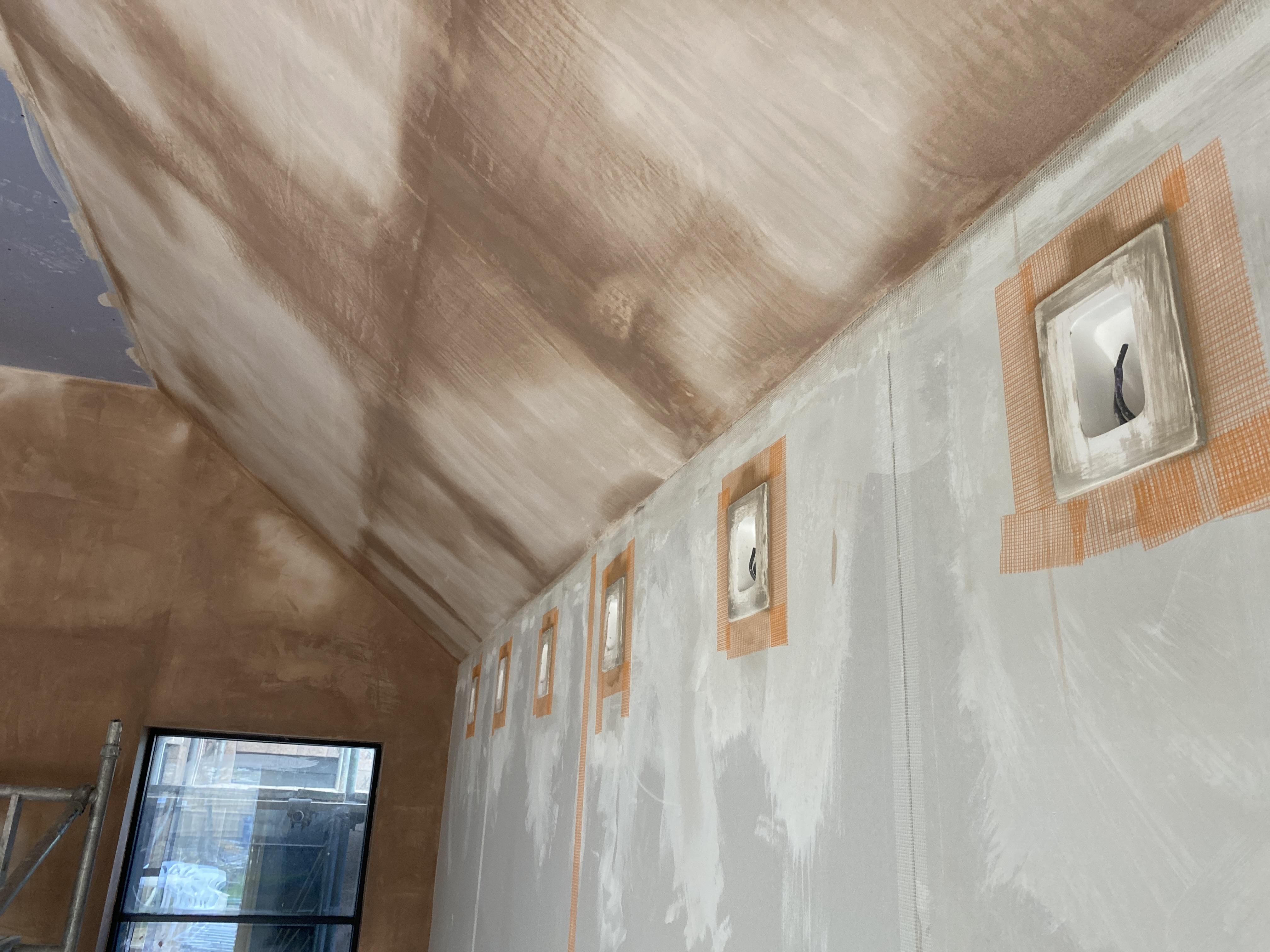

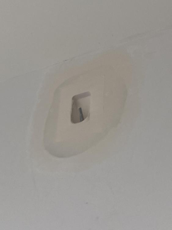

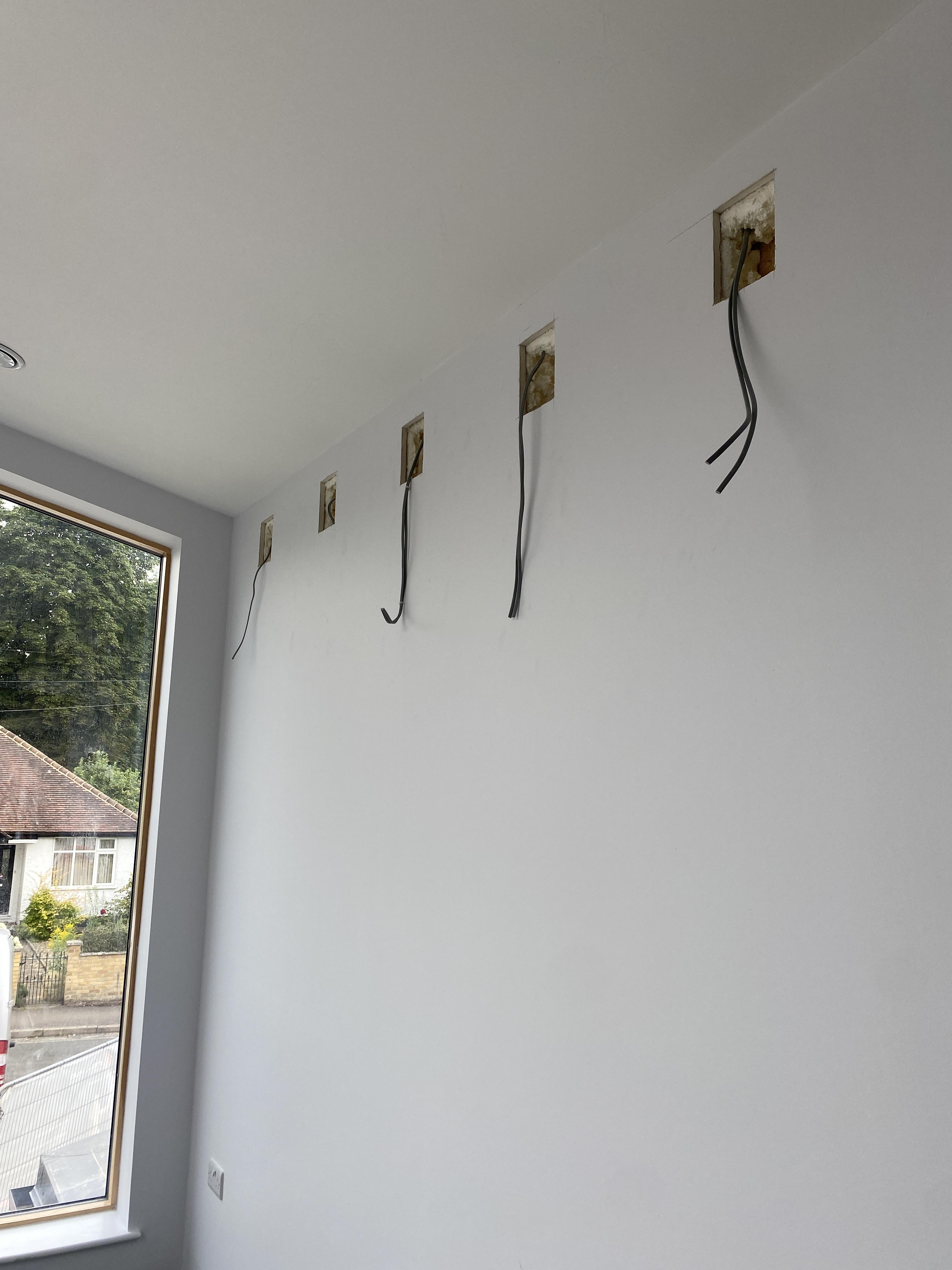

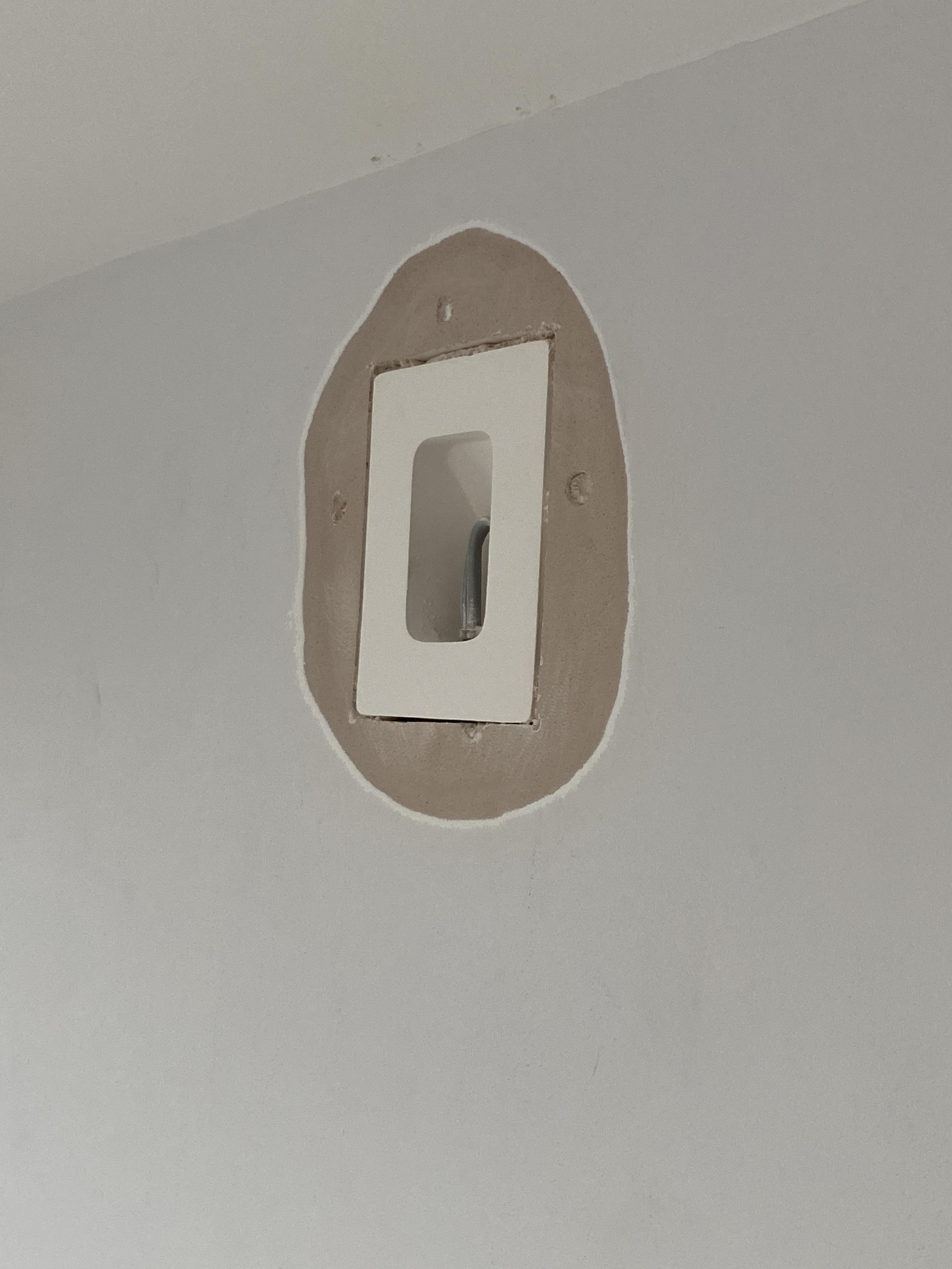

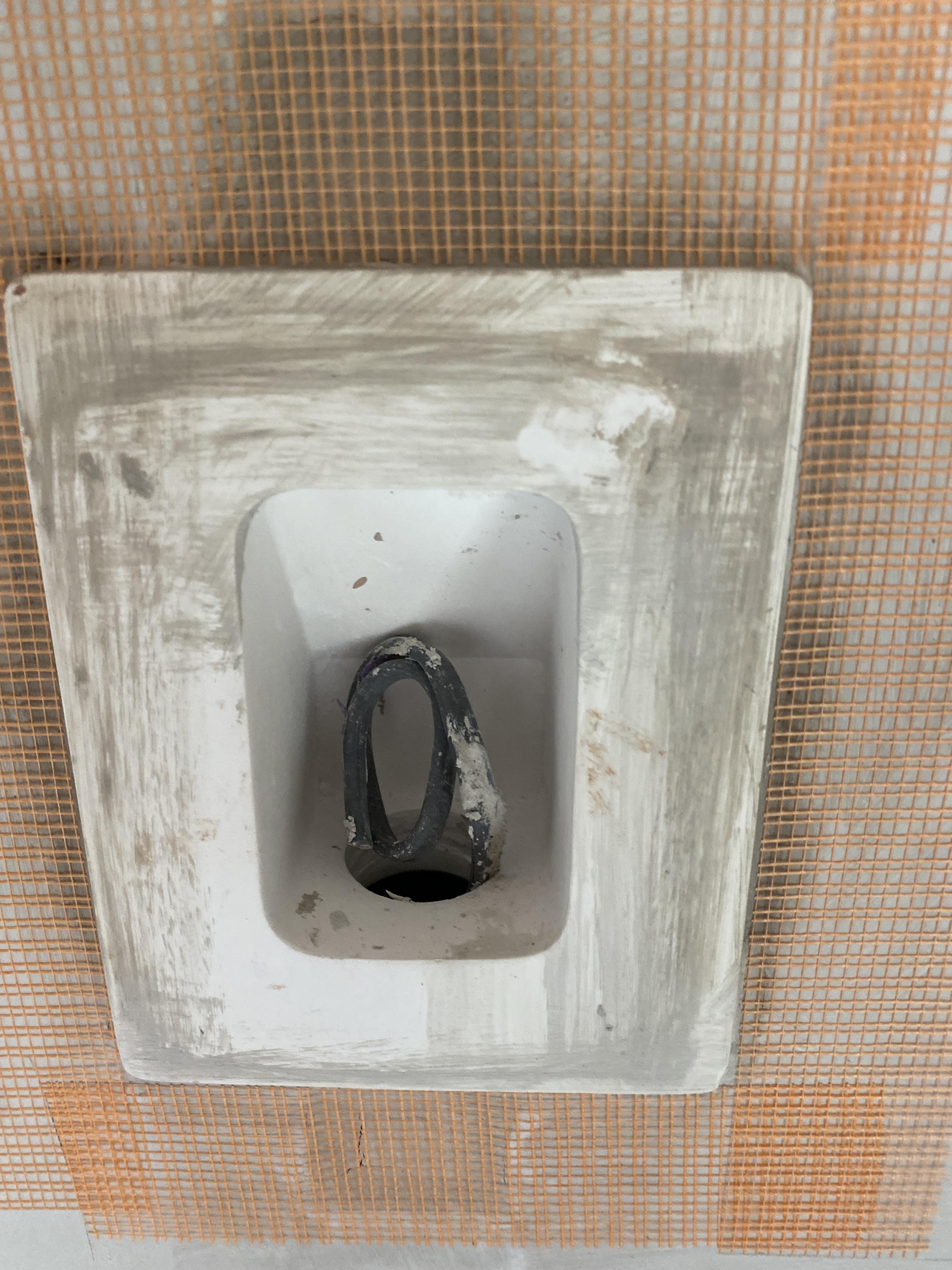

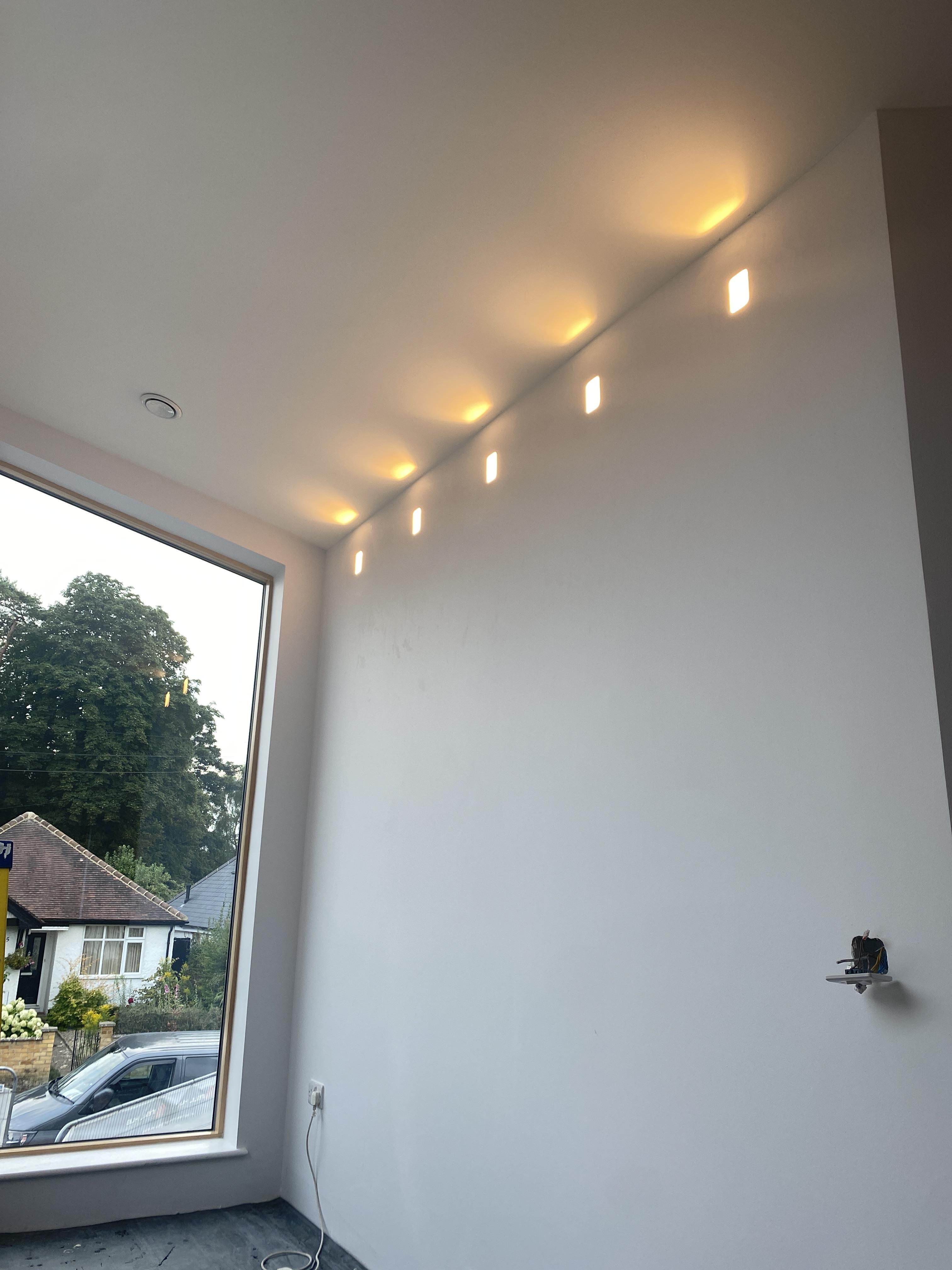

Nickfromwales Posted January 27, 2022 Posted January 27, 2022 (edited) 9 hours ago, SimonD said: I'm currently looking to get the electrician in soon to do the 1st fix electrics but we're really struggling with the lighting design so don't quite know exactly what we want. We have a vague idea but some areas like the huge vaulted curved ceilings, we could actually do with experimenting with various lighting arrangements first. Can anyone recommend a strategy to get the 1st fix largely done that leaves flexibility for finalising lighting design, but won't cause too much frustration with the sparky? Many thanks. I'm doing the lighting design for one of my current clients builds, which also has a tall curved ceiling. I've suggested recessed wall uplighters to wash the ceiling area with enough upward light to allow sufficient ambient light to make its way down lower in the room, with the idea being to have light but not to see the source ( or as near as damnit ). No pics of that one yet, sorry, but here are some of the same I installed on another project. Edited January 27, 2022 by Nickfromwales 3
Nickfromwales Posted January 27, 2022 Posted January 27, 2022 (edited) Edited January 27, 2022 by Nickfromwales 2

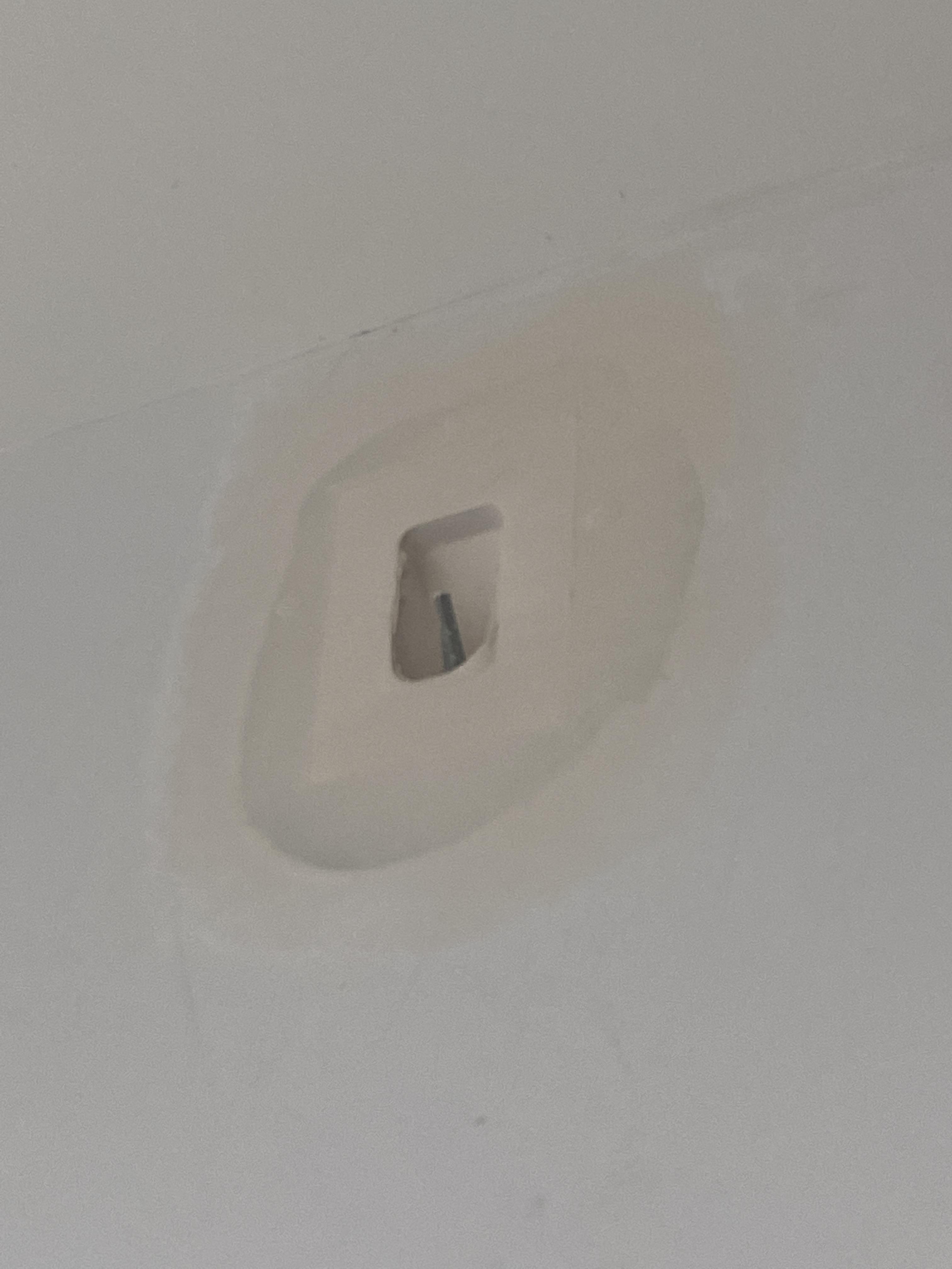

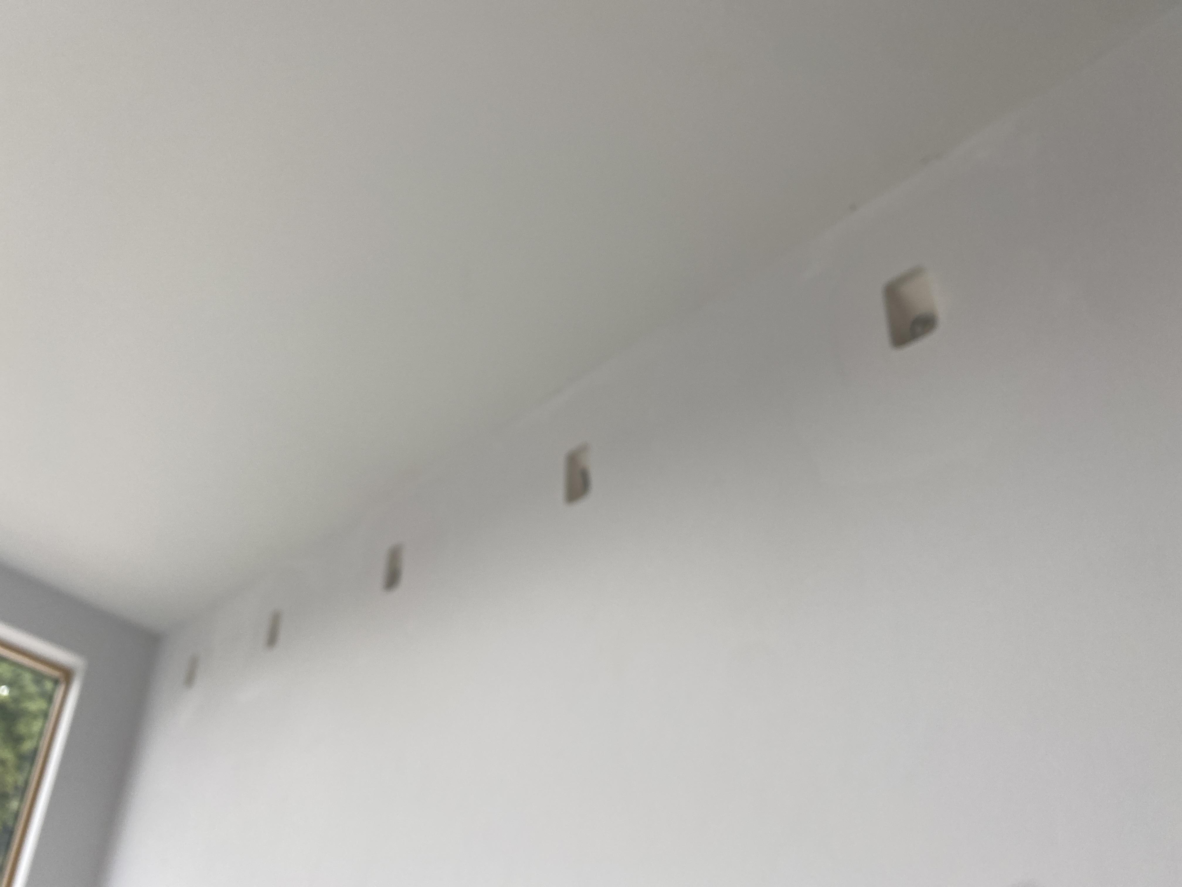

Bramco Posted January 28, 2022 Posted January 28, 2022 10 hours ago, Nickfromwales said: I'm doing the lighting design for one of my current clients builds, which also has a tall curved ceiling. We have a big kitchen/dining/living space with vaulted ceilings and have specified a hidden led strip along the wall/ceiling join that will throw light upwards. We'll also make this dimmable in sections, so the kitchen space, the dining space and the living space. There'll also be 3 dimmable pendants over the kitchen island. We'll add some floor lamps in the living space. You have to get the housings for the leds in place before plastering of course. Simon 2

SimonD Posted January 28, 2022 Author Posted January 28, 2022 19 hours ago, JohnMo said: Huge and bulb replacement, means scaffold to do it safely. Think carefully how you will maintain once furniture is in place. Low level up/down lights work well and are maintainable. Yes, good point, our ceiling is at 3.6m

SimonD Posted January 28, 2022 Author Posted January 28, 2022 (edited) 11 hours ago, Nickfromwales said: I've suggested recessed wall uplighters to wash the ceiling area with enough upward light to allow sufficient ambient light to make its way down lower in the room, with the idea being to have light but not to see the source ( or as near as damnit ). That's exactly what I'm aiming to do. From my reading of lighting design books, it's ambient light that's so important in good lighting design. I also still have the remnants of a medical condition that causes me problems in bright direct light, so when I'm in houses that use lots of downlights, especially led ones, I get headaches. They also seem to create dark areas all over the place if they're not well positioned. In my ceiling space I've got some 'shelves' that I built into the knee walls above the steels that will serve the purpose of flooding indirect light from one direction, those recessed lights or something similar you show would be ideal on the opposite walls, plus, I'm looking to have led concealed strips along the glulam beams where they meet the ceiling. I just need to also decide where and what I need for direct lighting in kitchen/dining and the living area, as well as what would work best in the stairwell and the landing area. The other area I'm struggling with is how bright the indirect lights need to be and have been buying led strips and other lights, including using work lights to test it out. Pics to illustrate the space: Edited January 28, 2022 by SimonD
