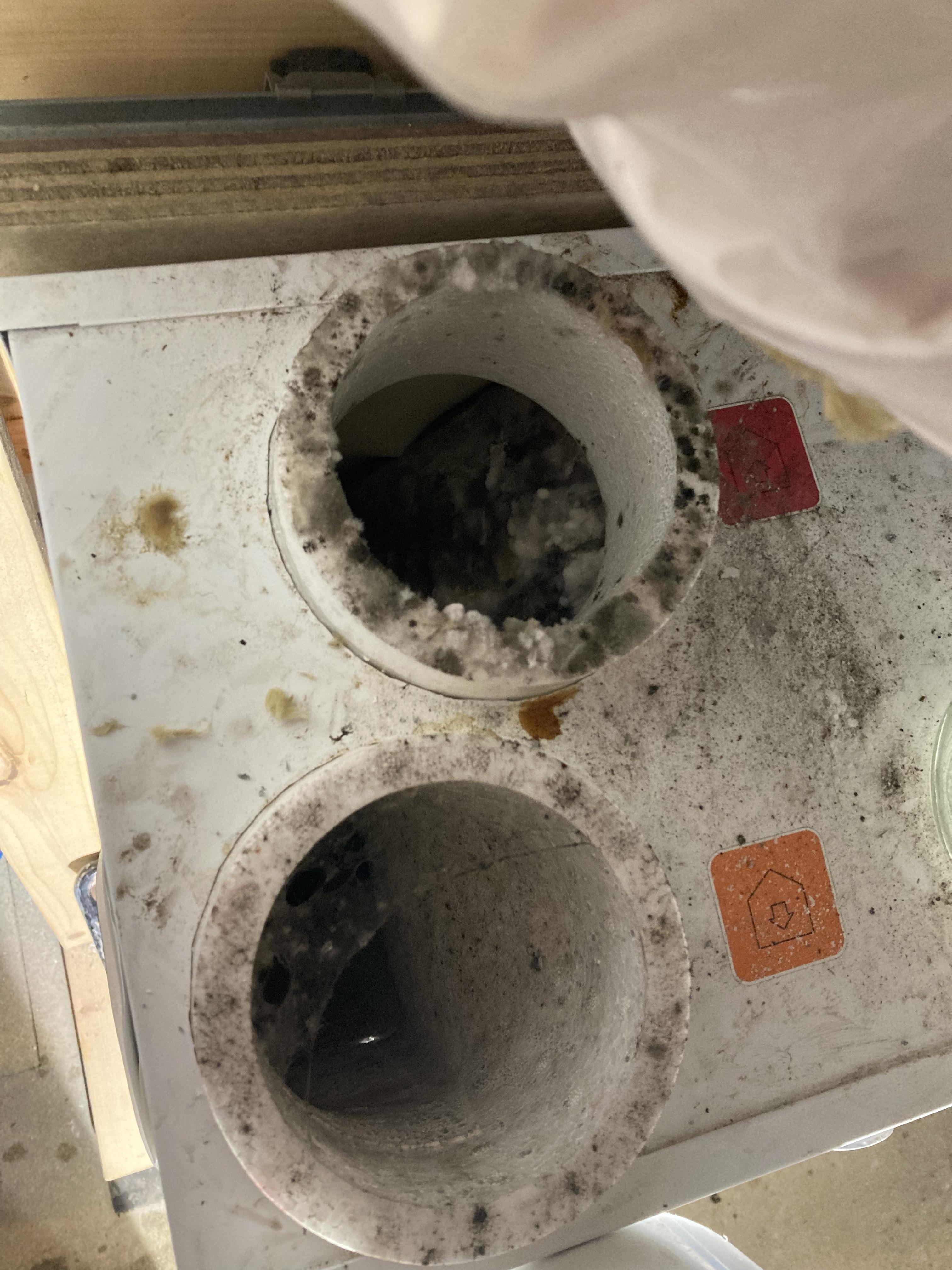

Death of MHRV unit
The system was finished and commissioned in January 2021 by professionals who commented on our excellent pipe fittings and general first fit of the whole house ventilation.
In August to unit set itself in summer override and was continuously working on boost. When the weather cooled down, it didn't stop the boosting but the summer override light has switched itself off.
We tried the 'turn it off and back on' trick but it didn't work.
As the weather was fine we left the unit turned off for a few weeks but it would not turn back on after that.
We contacted the makers and they said it could be the PCB or even the fan motors could have ceased. Long lead time on parts meant that it was left turned off again.
Two weeks ago we were woken up by dripping inside the vertical ducts and we discovered that all the pipes were full of condensation, water and black mould and that the unit is full of fluffy white mould. Many ducts junctions were leaking and we had to disconnect the ducts and block the vents to try and dry it all out.
Is it all completely ruined? what can we do next? how do we get rid of all that mould? What do you think?
Blimey, that's looks a mess. Who was the manufacturer? And was it installed by them?
Welcome to the forum. That's very unhappy-looking MVHR system you have there!
How long did you leave the MVHR system turned off, and how have you been ventilating the house during this period? How was it left with the supplier? Did they advise what you should be doing while waiting for parts? It also seems odd that no effort was made by them to identify exactly what had gone wrong.
I genuinely have no idea whether the unit is salvageable. It's possible that you can clean it out and disinfect it sufficiently that it can be used again, but getting at the insides of the distribution pipework in the rest of the house may be an issue.
Do you have a semi-rigid system? If so, is it circular in cross section? It's possible that with a lot of time and energy you could clean and disinfect the insides of such ductwork (I vaguely recall someone once talking about duct cleaning a few years ago), but it may not be a job you can do yourself.

Have you braved opening the front panel of the unit? I'd be particularly keen on seeing how well the condensate drain is working - or not. Just brace yourself for more mould which might require the heat exchanger removing to allow a thorough clean.
I'm sure you can save this.
Edited by MJNewton
MJNewton,
I tried opening the front of the units, removed all the screws but it won't budge at all, I suspect is it somewhat corroded to the main box due to the amount of water inside it.
