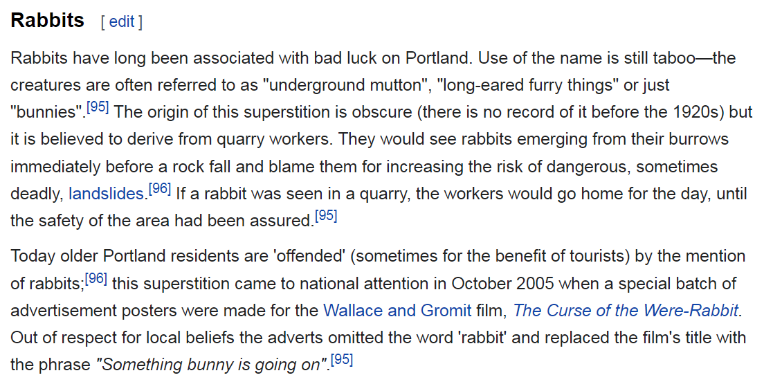

The problem with Portland is it gets very windy.
Having lived in Weymouth, Portland has many more problems than just wind.
Have refrained for mentioning the unmentionable.
Edited by SteamyTea
You mean - - - Bunnies?
No wonder the MVHR has broke.
Used to have a car sticker that said:
"Keep Portland Weird"
(and I know it is a US import)
