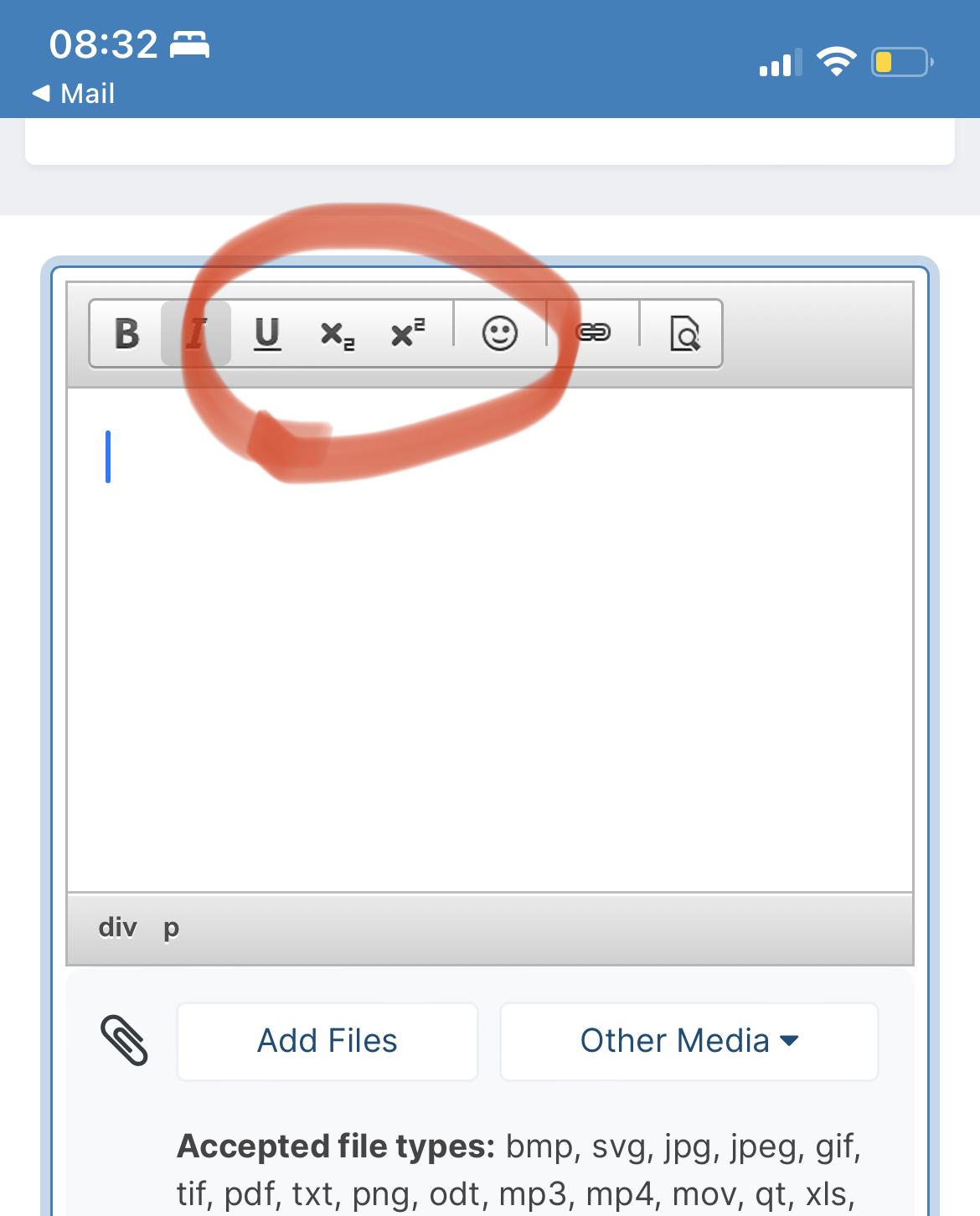

Nickfromwales Posted October 30, 2022 Share Posted October 30, 2022 1 hour ago, SteamyTea said: It is a 6 kWp arrary, the p means peak and a 15 kWh battery system. [6kW / an hour = 1.667 J and 15 kW / an hour = 4.167 J] What if we don’t have a swanky keyboard? Can’t see any options on my iPhone keyboard for uppies and downies, but haven’t looked very hard as usual! Link to comment Share on other sites More sharing options...
PeterW Posted October 30, 2022 Share Posted October 30, 2022 11 minutes ago, Nickfromwales said: What if we don’t have a swanky keyboard? Can’t see any options on my iPhone keyboard for uppies and downies, but haven’t looked very hard as usual! Don’t need to.. it’s on the editor on the top bar so you can do it from there… Link to comment Share on other sites More sharing options...
PeterW Posted October 30, 2022 Share Posted October 30, 2022 Same as the degrees ° is on an iPhone when you press and hold the zero … 😁 1 1 Link to comment Share on other sites More sharing options...

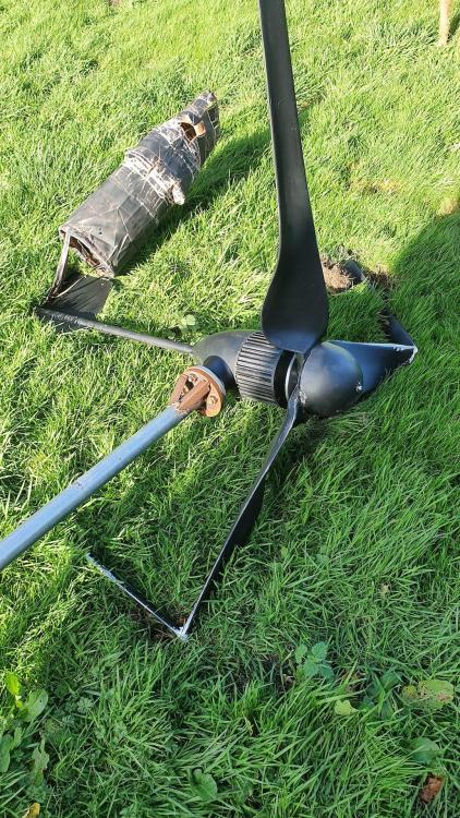

Ultima357 Posted October 16, 2023 Share Posted October 16, 2023 On 30/10/2022 at 08:58, ProDave said: A small turbine is something I am still thinking about. Everyone says it will be disappointing. But I still feel I want to play with more types of renewable power and an tempted to take a punt on this for not a lot of money. https://www.vevor.co.uk/wind-turbine-c_10731/vevor-wind-turbine-generator-kit-12v-wind-power-generator-300w-w-mppt-5-blades-p_010372870276 I am sure someone will be along to dissuade me..... Did you ever do it and did it work? Just been researching them but they don't seem to be worth the outlay. Most seem to recommend separate inverter for grid tied systems. Link to comment Share on other sites More sharing options...

Hastings Posted November 26, 2023 Share Posted November 26, 2023 Small wind turbines are only really best suited to houses where there is no affordable grid connection - which from a commercial perspective is probably not enough places in UK. PV in northern latitude winters produce little output in many places so a turbine is a good option compared to getting grid connected (I was quoted £250,000 for a 2 mile installation). My 1.9kW PV array (same latitude as Glasgow) does the job in summer but produced only 270Wh today and we're not even in Dec/Jan yet. Link to comment Share on other sites More sharing options...
