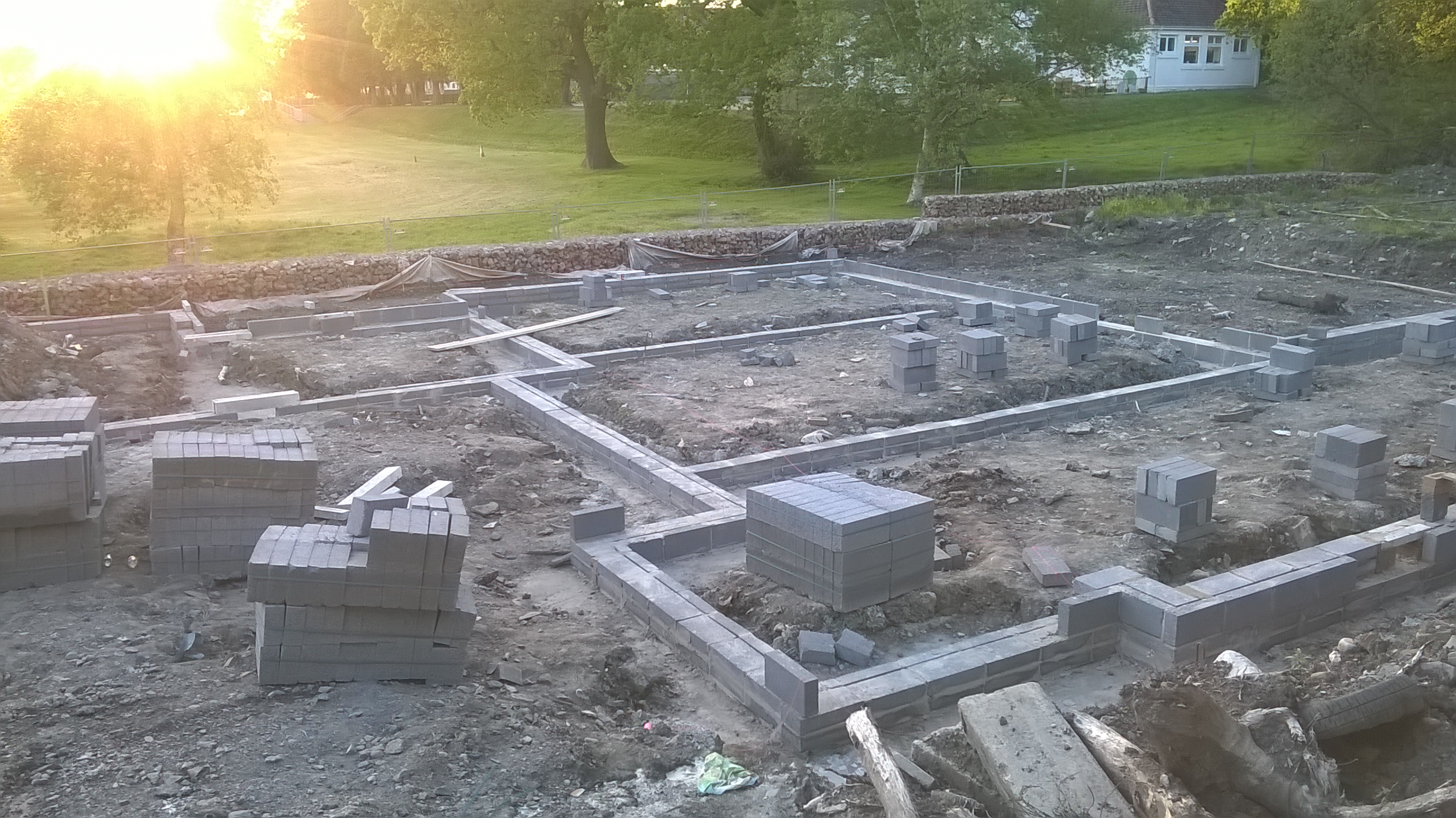

DNA Posted May 4, 2017 Author Share Posted May 4, 2017 Hi Guys, well into my blockwork now - see my 'sunset over blockwork' piccy below. I went for a 325mm solid wall Oz07 because it was just easier than setting out a cavity wall and then just filling it in. Hardly any price difference really as my cavity has to be 125mm (70mm insulation + the usual 50mm) which is ideal for a 102mm block. Also its pretty much a self regulating size - 102mm block upright + 2 x 215mm blocks on flat as Prodave said +10mm joint - automatic 325mm wall. Next course then just alternate the positions of the two skins for an automatic cross bond. Still didn't get to the bottom of the services under block and beam issue Nick but I suspect your right. I've just left some openings for now till I can confirm it but have to find a way of not putting the meter boxes on the front elevations like the gas and elect installers want. Link to comment Share on other sites More sharing options...
PeterW Posted May 4, 2017 Share Posted May 4, 2017 39 minutes ago, DNA said: 70mm insulation + the usual 50mm What insulation are you using as that's borderline building regs values. Link to comment Share on other sites More sharing options...
DNA Posted May 4, 2017 Author Share Posted May 4, 2017 Hi Peter aircrete internal and with 75mm kingspan gives us 0.2 with hard plaster finish. Might move to insulated board if needed but not decided yet. Happier to put my money into high quality triple glazing right now. Link to comment Share on other sites More sharing options...
Nickfromwales Posted May 5, 2017 Share Posted May 5, 2017 Be VERY particular around the joist sockets if they penetrate the cavity so you reduce draughts as much as possible. Ventilation heat loss will soon negate any benefit your 3G windows offer . I'd have a good sit down with your builder to discuss methods surrounding these and other such penetrations, such as soil and wastes etc. If you look after these things now, it'll serve you very well later down the line. Also, have you considered single room ventilation with heat recovery for the bathrooms? Link to comment Share on other sites More sharing options...
