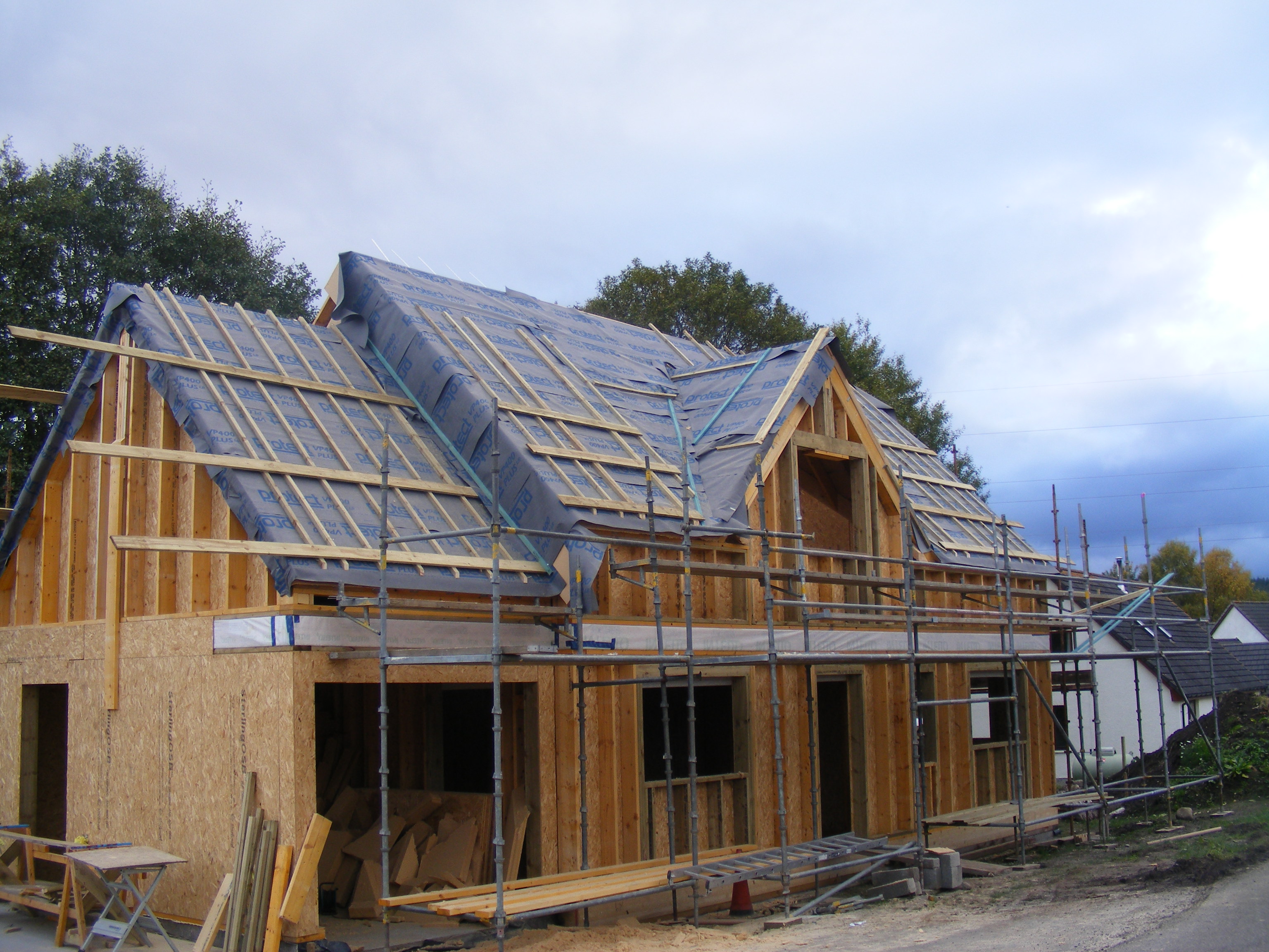

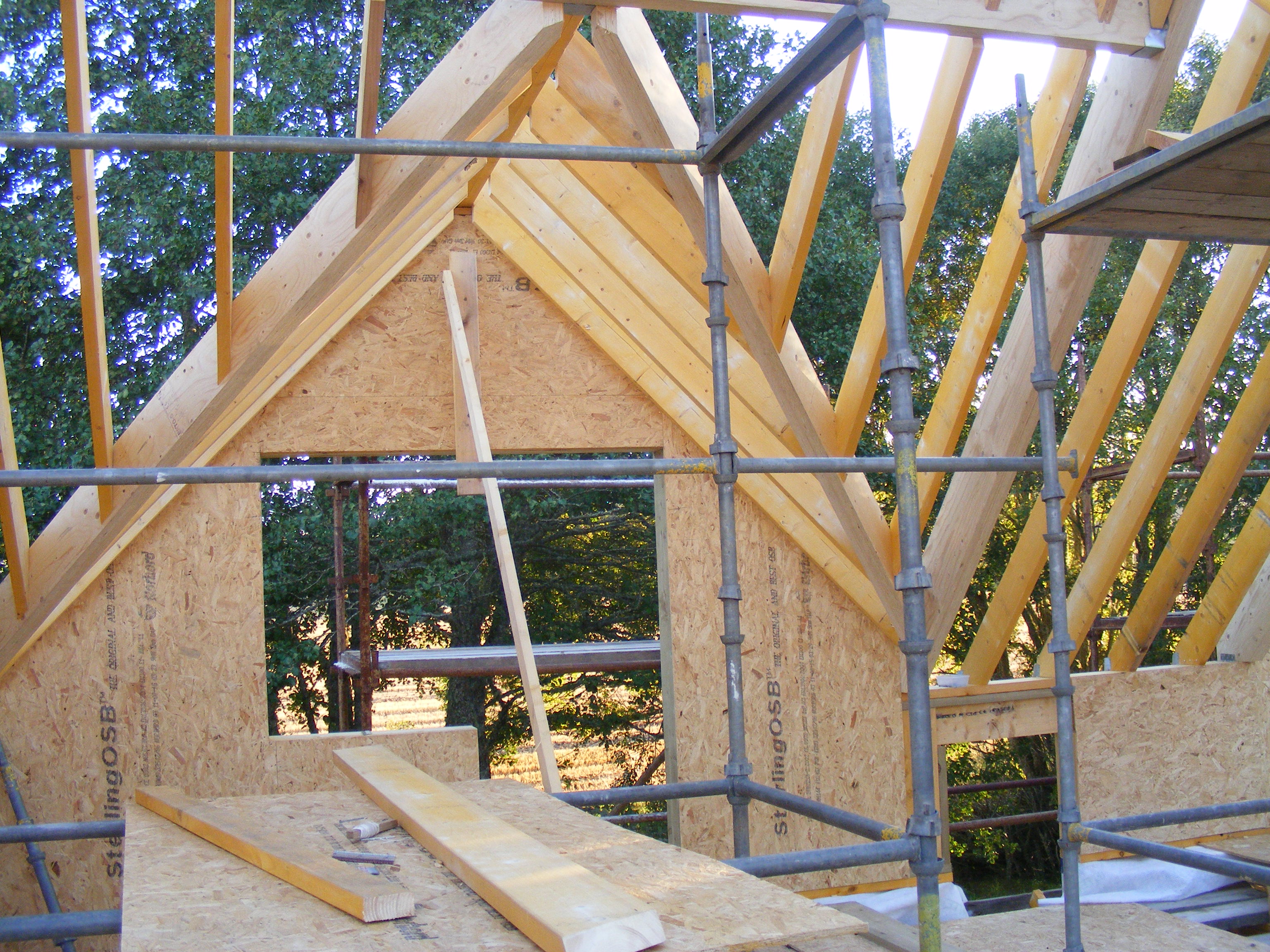

I couldn't find a drawing that showed it well, so pictures and a description is better.
It's a cut roof framed on site, hung from a bog Kurto ridge beam, using 195 by 45mm timbers for the rafters.
That then got clad with 100mm wood fibre board acting as a sarking board (a BR requirement in Scotland) and then a non tenting breathable membrane, counter battens then tile battens then tiles.
Later It was insulated from the inside using Frametherm 35 fitted from below, then a layer of OSB
Finally it will get covered in airtight membrane, battens to form a service void, then plasterboard. That's what I am working on at the moment.
Originally I was going to use blown in insulation, until I found out the cost.  I then worked out Earthwool Frametherm 35 had the same insulation U value, was less than half the price, and was a DIY job rather than having to get someone in to blow in the insulation, so I could do it at my own pace bit by bit.
