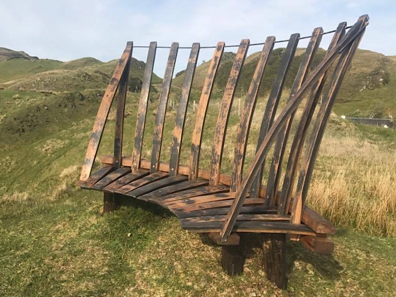

Cpd Posted April 20, 2017 Share Posted April 20, 2017 I am building an outdoor seat made from old oak barrel staves (photos when completed) its to be sited on top of an exposed cliff top and exposed to the full force of all weather including salt laden winds, does anyone have a "real life" good recommendation for an oil that i could use to keep it looking good and give it some protection, it will be out there all year round... thanks in advance. Link to comment Share on other sites More sharing options...
Barney12 Posted April 20, 2017 Share Posted April 20, 2017 By far the best oil for exterior oak furniture is a good quality teak oil. Nothing wrong with Barrettine products: http://www.wood-finishes-direct.com/product/teak-oil Link to comment Share on other sites More sharing options...
Barney12 Posted April 20, 2017 Share Posted April 20, 2017 (edited) P.S. Its also not a bad idea to add a clear wood preservative first before the teak oil. Something like: http://www.wood-finishes-direct.com/product/wood-preservative If you can find a way to soak for 24-48 hours the parts that come into contact with ground that will help further. Edited April 20, 2017 by Barney12 Link to comment Share on other sites More sharing options...

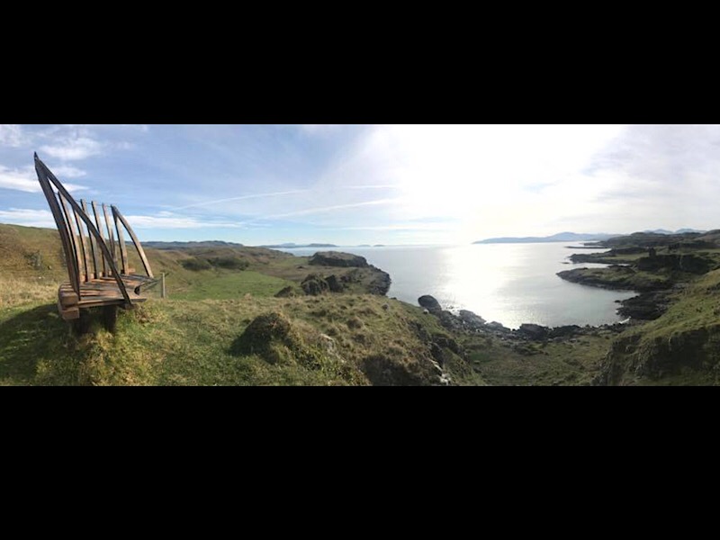

Cpd Posted May 3, 2017 Author Share Posted May 3, 2017 Garden seat oiled and put in place. 4 Link to comment Share on other sites More sharing options...

Cpd Posted May 4, 2017 Author Share Posted May 4, 2017 @Nickfromwales its ok mate its not the back garden so you dont have to do anything dramatic, its only the front garden looking westerly..... the veiw through the property from the back garden is not nearly as good...... Link to comment Share on other sites More sharing options...
Stones Posted May 4, 2017 Share Posted May 4, 2017 15 hours ago, Cpd said: Garden seat oiled and put in place. Not too shabby a view! Might I suggest a giant wind farm in the background to really enhance the natural beauty of the landscape? Link to comment Share on other sites More sharing options...
