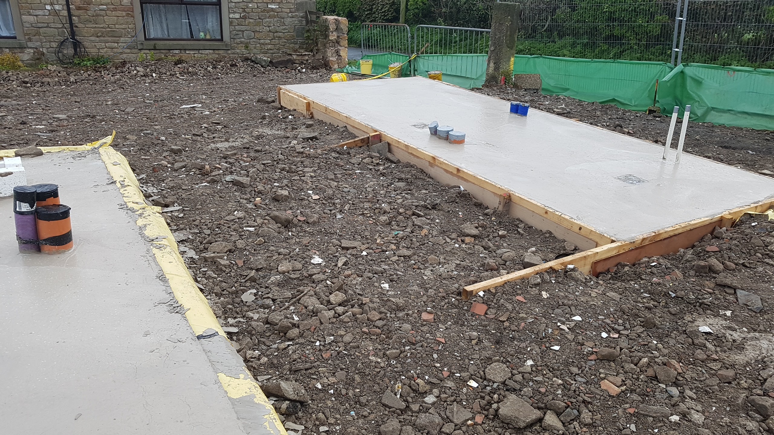

The question: how do I arrange the MVHR ducting between two buildings?
The Answer: dig a trench, line it with concrete, and shove the pipes in with as much insulation in as you can (wrap it it in some spare EPS300?)
The excuses first: We came too late to ebuild to start our planning with passivhaus in mind. It took us a full year to realise the implications that choosing MVHR would have. It took a further few months to realise that we needed to site the plant room in our piggery. Have a
look at this.
The Piggery (the plant room) is on the right. There are two six inch ducts and a spare ready for the MVHR unit. The house slab (on the left) shows the ducts entering the heated envelope. The Piggery will also be heated to PH standards. Each of the ducts has two 45 rest-bends underground and have been capped off  - until I stop sucking my teeth wondering how to bodge this one.
Problem: how to duct the in and out airflows underground without causing condensation
My guess at an answer is something along the lines: run a concrete-lined trench between the two buildings to contain the pipes. Lag the Hell out of them. Make sure I can inspect the trench to check for water ingress, and make sure I can drain any condensate out of the MVHR pipes themselves.  Maybe even make sure I can visually inspect the inside of the MVHR pipes? My fingertips say that this last bit is  desirable, but probably not essential.
My worry is that we will have to insulate the pipes as they come out of the trench and return to each building, and that will have to be insulated just as well as the rest of the pipe. In other words, the trench will be the easy bit. I can just see myself under the foundations lagging the pipes right up to the bottom of the strip foundation.
Still, if I can't take a joke, I shouldn't have started this should I?

@SteamyTea, the house doesn't have room for the MVHR unit - well it does, but it takes up too much space overall.
@jack, is this what you mean?
@Ferdinand, [gap] nothing much for a while: bike storage, concreted base for an outside work area. But my cunning long term plan is to link the two buildings (four piles already exist between both ends of the piggery and the house so we can link the two buildings)

Slightly confused - if the pipe is 6inch (150mm), and the duct is going to be min 125mm - and that type of duct is rigid - how do you get the duct through? Or are you using the 6inch pipe as the duct?
Personally, I would revisit putting the unit in the house - I would never be happy running air ducts outside underground - aside from the condensation risk, you'll likely never stop worrying about it or tying yourself up in knots trying to find a workable long term solution that doesn't having you checking the duct every 3 months.

Just to check - the MVHR itself is in the piggery, so the ducts connecting the 2 buildings would be be at a more stable and relatively constant temperature flow at around 16 to 20C. Surely the risk of condensation is reduced significantly IF you insulate the ducts underground?
In my install the ducts after the MVHR have shown no issues at all (admittedly they are both inside the thermal envelope), but the cold supply from outside the building to the MVHR has been problematic and I ended up cutting out the supplied foil-backed fibreglass insulation and fitting in Armaflex - great stuff, glued to the duct so a much better solution.
Havea look at the Armacell website - they offer external-grade insulation that might offer an answer.
