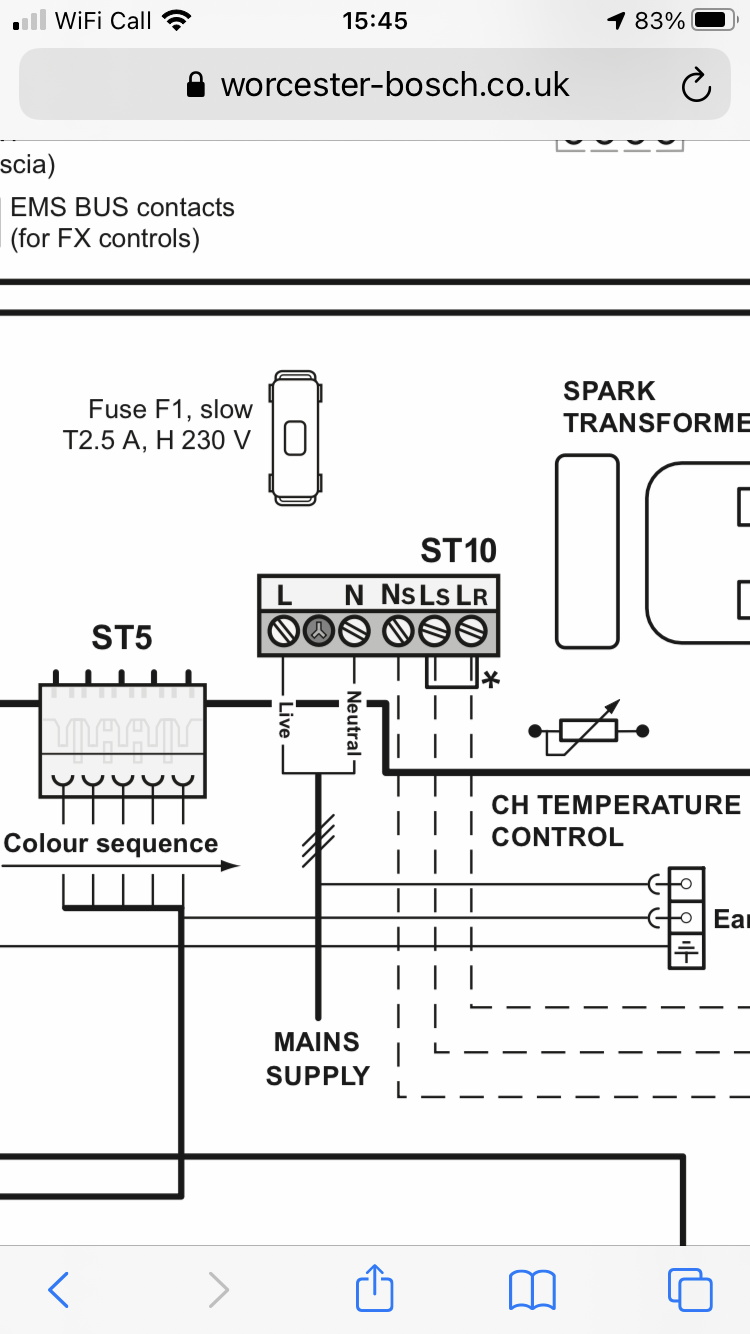

TonyT Posted December 24, 2021 Posted December 24, 2021 (edited) No still figuring it out as my boiler thermostat use a 2 core bus connection, so need to see if there is something I can connect to at the boiler. Edited December 24, 2021 by TonyT
Nickfromwales Posted December 24, 2021 Posted December 24, 2021 39 minutes ago, TonyT said: No still figuring it out as my boiler thermostat use a 2 core bus connection, so need to see if there is something I can connect to at the boiler. Does it not have a regular stat connection as well as the bus connection? Have you checked the Mi’s?
TonyT Posted December 24, 2021 Posted December 24, 2021 Not sure, winding down at the moment. it’s a Worcester Bosch sense 2 thing
TonyT Posted December 24, 2021 Posted December 24, 2021 Yes it does, need to check it will override the existing stat.

Nickfromwales Posted December 25, 2021 Posted December 25, 2021 19 hours ago, TonyT said: Yes it does, need to check it will override the existing stat. You just re-fit the LS>LR link to use bus only.

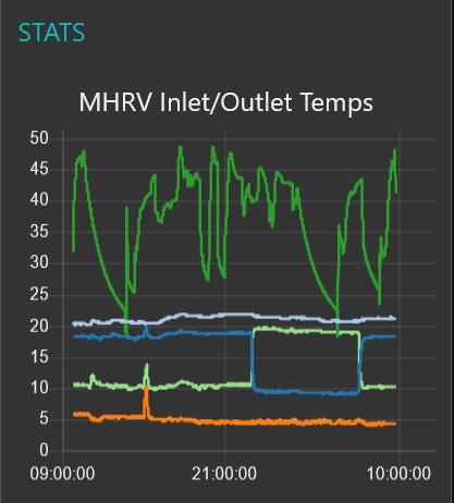

Ajn Posted January 24, 2022 Author Posted January 24, 2022 On 26/12/2021 at 10:58, joe90 said: But our time lag on heating is so long timing does not work, my heating very rarely comes on so timing does not work, mostly it comes on at night when temps drop and we benefit during the day. We have found the same. The dark green line on the chart is the UFH feed temp (note: the feed to our "single story annex" bit of 95sqm comes from the main building of 230sqm and I have no control on what the children are doing) The other lines are, grey - Vent extract temp, blue - vent supply temp, light green - vent exhaust to outside temp, orange - vent outside inlet temp. As an experiment at the moment at night we do a bypass on the MVHR to see if it makes sleeping better. I am a window open man which does not go down well with the other half when we are on the ground floor and only have a patio type door in the bedroom. This period of bypass does not seem to affect the heat loss and its is dependent on external/internal temps to be active. However I still feel the need for some sort of variable timed control on the UFH as just moving around during the day needs a lower temperature than sitting in the evening and sleeping needs a lower temp still. On 26/12/2021 at 12:11, tonyshouse said: How long does it take to heat up from say 18C to 21C? Our floor takes about 3 hours to take the room from 18 to 21C. On 26/12/2021 at 09:56, JohnMo said: Just got lots of holes to fill and paint, but that's a job for the new year. I would not be allowed to remove any of the supplied controls. I can bypass or suplement with as many "toys" as I like BUT if I stop waking up in the morning then the installed system has to be useable.
JohnMo Posted January 24, 2022 Posted January 24, 2022 "I would not be allowed to remove any of the supplied controls. I can bypass or suplement with as many "toys" as I like BUT if I stop waking up in the morning then the installed system has to be useable." But that's the point, the supplied control made the system work badly. Huge temperature over/under swing. Timers would have to set 12 hours offset from time I wanted things to happen. I have single thermostat in the hall (always on), which calls for heat, or shuts off heat. Bedroom thermostats to make temp lower than the rest of the house, set at 17/18, it works great, they are not allowed call for heat. Set at 19.5, I get a plus or minus 0.5 degree swing, whatever is happening outside. I have no need to mess with the mvhr settings, it just runs at a set speed 24/7, except when boost is on. 1
