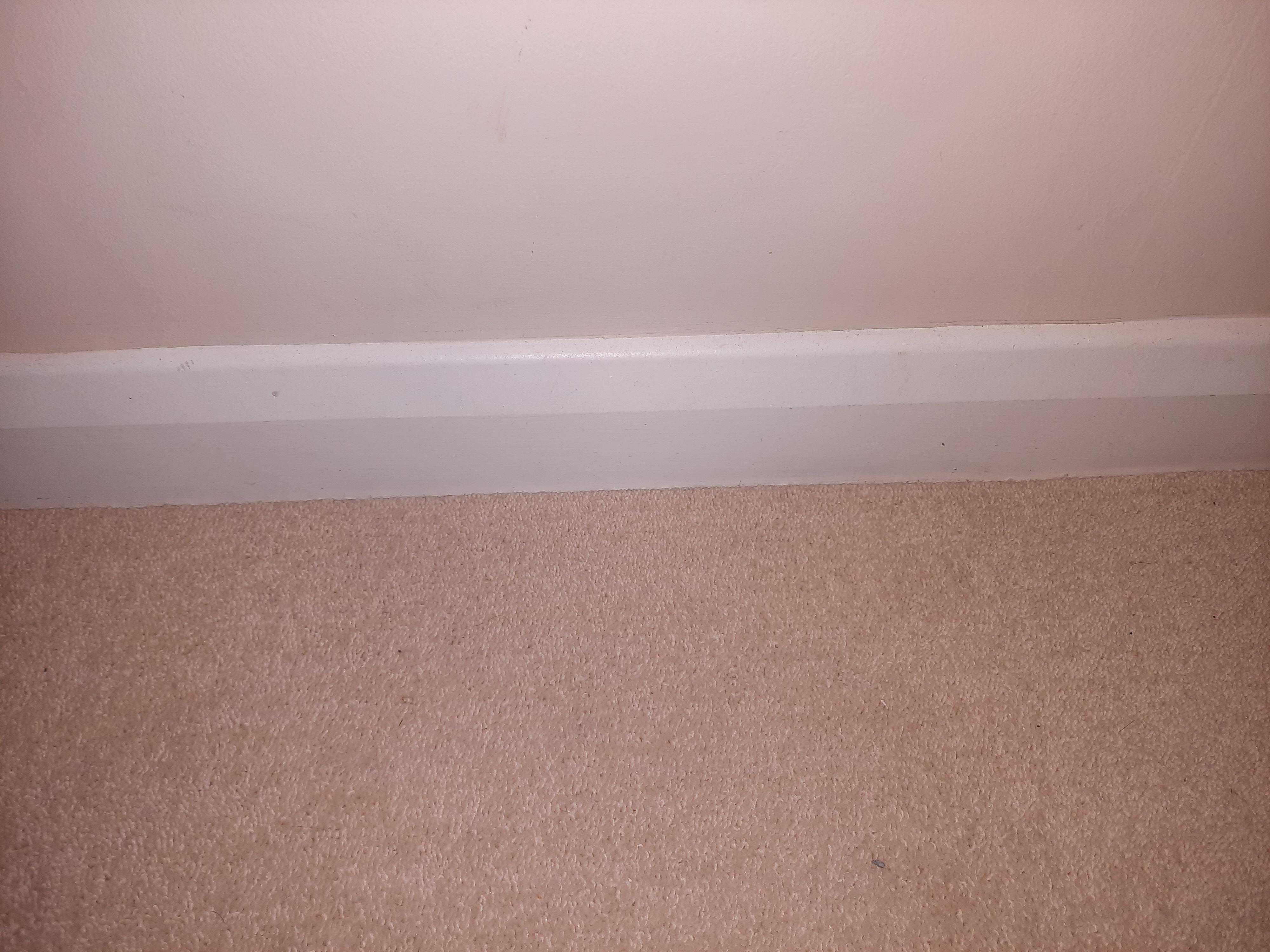

Roundtuit Posted December 2, 2021 Share Posted December 2, 2021 I'm guessing that the beading is there to cover a gap between skirting and floorboard. Personally, I'd have taken it off and filled the gap first, then the carpet could have been fitted neatly at the edges. Not sure you can really blame the fitter for that. The two-tone stuff looks like a join, maybe with the pile running the wrong way. If they had to put a join in, they really should have made you aware. 1 Link to comment Share on other sites More sharing options...
TryC Posted December 2, 2021 Author Share Posted December 2, 2021 4 minutes ago, Makeitstop said: Bubbles? I cant see why they are unable to stretch it due to cold. What'll happen exactly? The entire thing looks a bit like you've had "could'nt give a f**k types in here. bubbles...like if my carpet needed CPR, i could give it cpr, you can see it go up and down like a chest compress. I had the carpet do this in other rooms that we had fitted by other installers (sent by the same carpet company), and I was beginning to think it was normal to have them - although, we didn't have these issues at all when we last had carpet fitted which was so 20 years ago. I don't know what it is, all the couldn't give a F types seem to be coming me lately. I'm having no real luck with the trades of late! They just said the carpet is stiff due to the cold and that the room should be warm to warm up the carpet??? Link to comment Share on other sites More sharing options...
TryC Posted December 2, 2021 Author Share Posted December 2, 2021 (edited) 4 minutes ago, Roundtuit said: I'm guessing that the beading is there to cover a gap between skirting and floorboard. Personally, I'd have taken it off and filled the gap first, then the carpet could have been fitted neatly at the edges. Not sure you can really blame the fitter for that. The two-tone stuff looks like a join, maybe with the pile running the wrong way. If they had to put a join in, they really should have made you aware. i didn't know there was a beading there, yes, i painted it but I just painted it without noting there was a beading. As I said, I never thought the carpet would be fitted the way it has, it had carpet in there before and it wasn't an issue for the fitter back then? they managed to curl it under or whatever they did and make it good. when i took up the old carpet, it was firmly fitted to the floor and was not easy to uplift. I felt the carpet leave the grippers and heard it so, but with this new one, i could probably peel this thing back easily. Edited December 2, 2021 by TryC Link to comment Share on other sites More sharing options...

ProDave Posted December 2, 2021 Share Posted December 2, 2021 So multiple issues The unneeded beading should have been removed first, before the skirting was painted and before the carpet was fitted. the fitter should have advised this when he came to measure. If the carpet needed a bit patched in with a join, was it an unusually large room with one dimension longer than the roll width of your chosen carpet? could you not have found a carpet with a roll width wider to avoid a joint? Did the supplier not suggest this? And I don't buy the can't stretch it theory. did you actually see them using a carpet stretcher? 1 Link to comment Share on other sites More sharing options...
TryC Posted December 2, 2021 Author Share Posted December 2, 2021 (edited) 12 minutes ago, ProDave said: So multiple issues The unneeded beading should have been removed first, before the skirting was painted and before the carpet was fitted. the fitter should have advised this when he came to measure. If the carpet needed a bit patched in with a join, was it an unusually large room with one dimension longer than the roll width of your chosen carpet? could you not have found a carpet with a roll width wider to avoid a joint? Did the supplier not suggest this? And I don't buy the can't stretch it theory. did you actually see them using a carpet stretcher? i visited the online store, a guy came to measure, quote, i bought they came over the course of several months and sending no less than 6 fitters (for the 3 jobs in waves) as some fitters came without the correct stuff at times (i.e., no underlay, no plates, no ...carpet), having expected me to provide it for some reason? (no, I don't have a secret carpet stash in my house). If you are suggesting the area where it is two-tone colour is a patch join - no, I didn't even know they would do this, I would of thought they would have measured up and provided me with the right sized carpet before fitting. Is my understanding of your meaning correct?? Edited December 2, 2021 by TryC Link to comment Share on other sites More sharing options...

Temp Posted December 3, 2021 Share Posted December 3, 2021 Bit late but.. Normally the grippers are fitted about 8-10mm away from the skirting not right against it. The carpet is hooked over spikes on the gripper then tucked down into that gap. See this vid.. Skip to 1:48... 1 Link to comment Share on other sites More sharing options...
TryC Posted December 3, 2021 Author Share Posted December 3, 2021 6 hours ago, Temp said: Bit late but.. Normally the grippers are fitted about 8-10mm away from the skirting not right against it. The carpet is hooked over spikes on the gripper then tucked down into that gap. See this vid.. Skip to 1:48... yes! the grippers were fixed to the floor like this originally (two of these fitters, just used the same ones installed), even though I paid for new grippers in the package, the fitters said they were still good to use and so used them - or maybe they were being lazy and didn't want to remove the old and put in the new I am not sure? I did ask, they said the grippers are good for 20 years and I said that carpet they are removing is 20 years old already (!). They carried on regardless and used the old one. Yesterday's install, they just used the same grippers too, but put new ones where there weren't any i.e., the fireplace - which came well after the carpet many years later. Never had an issue, with the carpet around the fireplace lip, it was in there snug, because it went right over it I suppose, but now, if you press it, the carpet goes up and down. I do distinctly recall there being a little gap between gripper and the carpet - for sure on your comment about being tucked into that gap, that is what I thought it would be done like, as what was done in the carpet that was replaced! tuck and tidy! I am not having much luck with tradespeople in general it would seem. I think once I get this once sorted, I hope for better luck with tradespeople in the New Year! Link to comment Share on other sites More sharing options...
Ferdinand Posted December 3, 2021 Share Posted December 3, 2021 By that last photo the bead is for the wooden floor. If you want one, the neatest fix I can see is to replace the bead with a larger bead say 7-8mm bigger to cover both the edge of the carpet and any damage you do carefully taking the old one off. Attach the new one with a bead of silicone, having painted it first if required, and it will then be removable with a knife next time. You will need something to hold it in place briefly whilst the silicone sets. Link to comment Share on other sites More sharing options...
TryC Posted December 4, 2021 Author Share Posted December 4, 2021 so, an update with the carpet. The shop wants me to remove the beading before they will re-fit as this is something they do not do. I just don't understand why this is now a problem, if the previous carpets was OK with this and now suddenly it is a problem - the carpet they replaced was in place for 20 years and we had carpet in before that in-situ for about 10. So 30 years no issues, but now they are blaming the beading in place that is properly (most likely) older than me! I really don't understand. Anyway, now I have to remove this beading that looks very much in place - how I don't even know. I don't even know what is hidden under the beading or what it is covering, if it isn't there just to cover a gap between the skirting and floorboard. The two-tone carpet, they said is because the carpet has been rolled up and upright for 6 months or what not, that it will come out and is not a fault (i was never told this could even happen, I didn't know it would happen). I pointed out I was not a carpet expert and would not know this. They said I need to give it a week before they can decide whether to replace it or not. Link to comment Share on other sites More sharing options...
ProDave Posted December 4, 2021 Share Posted December 4, 2021 i would roll back the carpet from the edge, remove that bead (get a handyman in if you can't do it yourself) and you will probably need to re paint the skirting. Then get the carpet fitters back to resolve it. With the bead gone, they will not have an excuse for it not fitting properly. The damaged backing to the carpet is probably not an issue, it is not often they lay with a stock edge against a wall, usually all sides of the room are trimmed to fit and that less than perfect edge will have been cut off. 1 Link to comment Share on other sites More sharing options...
