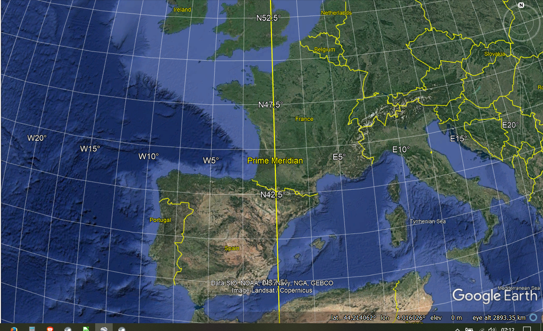

SteamyTea Posted November 24, 2021 Share Posted November 24, 2021 3 minutes ago, Bonner said: Just for my understanding, where is the border? I was always told that if you draw a line from Bristol down to Weymouth, then anything west of that is the South West. I once heard a radio program where they referred to Oxford as in the South West. When I lived in Bournemouth (west of Salisbury), it was always refereed to as Southern England, and was on the South Coast. Much of this is to do with how the UK is orientated on a map. It is easy to assume that where I am, 5°W is above France, but it is actually more than halfway across Spain. Link to comment Share on other sites More sharing options...
