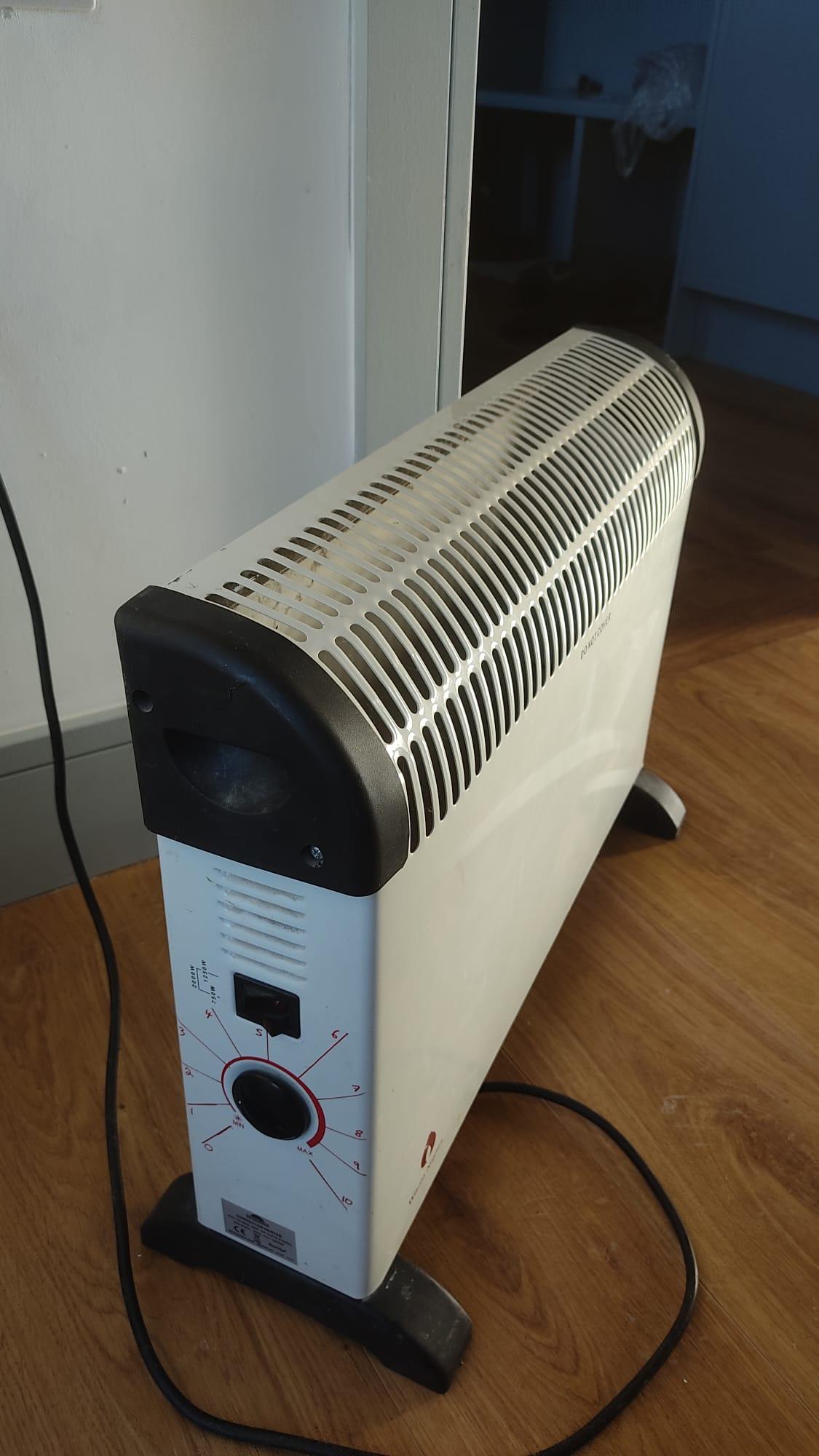

Space heating is done by one of these, sitting in the hall. I'd like to claim it was cheap but I it found buried in my parents shed. My hitech upgrade was taking a red marker and adding some divisions to the thermostatic dial.

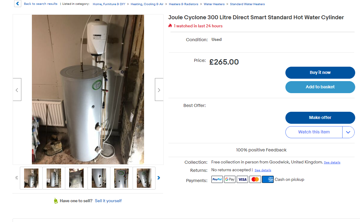

This is the same as ours. No complaints with the cylinder so far.
https://www.cylinders2go.co.uk/shop/renewable-energy/300-litre-telford-tempest-heat-pump-cylinder-twin-immersion-version/
Would future proof for an ASHP if you're committed to that route.
However they are nudging the price of one of these which already has a heat pump and will take care of your ventilation too. (Like the Ecocent that @SteamyTea mentioned)
https://www.ebay.co.uk/itm/284146848717?hash=item422878d3cd:g:9j4AAOSwMWhhg-F5
