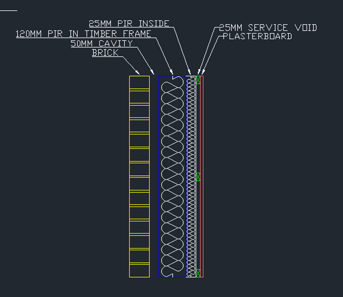

benben5555 Posted October 24, 2021 Author Share Posted October 24, 2021 (edited) Would this be the correct detail? Funny thing is according to the Celotex website 120mm between the studs only gives a U-Value of 0.25. But add another 25mm internally and it jumps to 0.16. Edited October 24, 2021 by benben5555 Link to comment Share on other sites More sharing options...
ProDave Posted October 24, 2021 Share Posted October 24, 2021 Define your requirements and design to that. Are you intending to buy a timber kit from one of the established suppliers? If so I hit a brick wall as soon as I mentioned taking one of their standard offerings and adding more insulation. They ended the conversation. Instead I got it designed by a competent architectural technician who knew his stuff and stick built by local builders. If you end up over sheeting the inside of the frame, you then batten in line with each frame member, to make your service void. Link to comment Share on other sites More sharing options...
dpmiller Posted October 24, 2021 Share Posted October 24, 2021 If a TF supplier doesn't have the flexibility to give you what you want, you want a different supplier. Whilst everyone has their standard packages, I had no problem getting pricing on options to suit my requirements... Link to comment Share on other sites More sharing options...

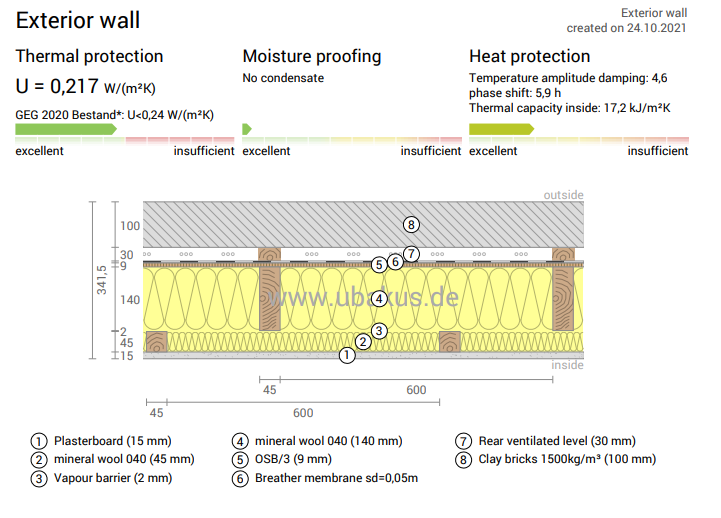

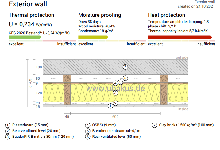

Iceverge Posted October 24, 2021 Share Posted October 24, 2021 I echo what @Thorfun said. Open panel, self insulate. Then add a vapour membrane + 45mm insulated service cavity and nail the airtightness. It's cheaper and more effective than adding more insulation. Easy improvements from here would be to increase to Frametherm 035 or 032 and then to increase to a wider main stud. Blown cellulose for the final win. Link to comment Share on other sites More sharing options...
Iceverge Posted October 24, 2021 Share Posted October 24, 2021 What the timber frame manufacturers suggest get through the regs using the absolute minimum amount of timber and in factory labour. I would like to see any results of anyone getting a satisfactory airtightness result from this construction. I'm happy to be challenged on this if anyone knows better. The timber is exposed to the full variables of relative humidity within the building as there's no vapour barrier. With a rigid insulation like PIR how does the subsequent expansion and contraction of the studs not lead to a leaky structure and moisture laden air coming into contact with the back of the OSB sheathing? How does the structure cope with PIR shrinkage? It also has poor heat protection for the timber clad areas. (brick exterior takes care of a lot of this otherwise) Link to comment Share on other sites More sharing options...
benben5555 Posted October 24, 2021 Author Share Posted October 24, 2021 Thanks for the information. It's useful to have knowledgable people to speak to! Firstly, I have no idea what 'heat protection' is! Secondly, what would you suggest is better than PIR? Mineral wool as shown on your detail? Is there not an issue with 'slump' with mineral wool when used vertically as it is not self supporting? Also I'm not questioning what you have shown there in that detail but why does the vapour barrier go between the insulation layers, and not between the plasterboard and the first layer of insulation? And in terms of the service cavity what is electrical cable clipped to? I'm guessing it needs to be run against the plasterboard to avoid overheating? Link to comment Share on other sites More sharing options...
