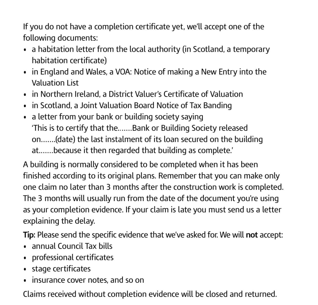

ToughButterCup Posted October 21, 2021 Author Posted October 21, 2021 8 minutes ago, pocster said: ... I thought you simply ‘finish ‘ get BCO out then 3 months to submit - and that’s it . ... Yes, @pocster , you were asleep as usual ?. The BCO route is one way of indicating you are finished. However, there are several others as detailed below Here's the relevant bit from the form you have to complete; Quote .... If you do not have a completion certificate yet, we’ll accept one of the following documents: • a habitation letter from the local authority ... • in England and Wales, a VOA: Notice of making a New Entry into the Valuation List [several others relevant to NI and Scotland deleted] .... A building is normally considered to be completed when it has been finished according to its original plans. Remember that you can make only one claim no later than 3 months after the construction work is completed. The 3 months will usually run from the date of the document you’re using as your completion evidence. ... (Form VAT432NB , Notes to questions, pages 6 and 7) This is the key issue The 3 months will usually run from the date of the document you’re using as your completion evidence. Here's a photo Oh, that word 'usually' (above): needs to be read in conjunction with the notes provided in the main VAT thread. 1
Pocster Posted October 21, 2021 Posted October 21, 2021 2 minutes ago, ToughButterCup said: Yes, @pocster , you were asleep as usual ?. The BCO route is one way of indicating you are finished. However, there are several others as detailed below Here's the relevant bit from the form you have to complete; This is the key issue The 3 months will usually run from the date of the document you’re using as your completion evidence. Here's a photo Oh, that word 'usually' (above): needs to be read in conjunction with the notes provided in the main VAT thread. Ah ok . I’ll go back to sleep for another 2 years . ? ?
ToughButterCup Posted October 21, 2021 Author Posted October 21, 2021 1 hour ago, ProDave said: Stick to your guns that you submitted the claim within 3 months of the date you were made to believe the valuation to have been done .... The reply to @pocster immediately above applies. BUT. I recognise the importance of the pinned post written by @newhome A Guide to the VAT Reclaim Process , where she says Quote A while ago HMRC started to apply different criteria to determine when a house is complete. The claim forms have not been updated to highlight this so this change of policy caught out many people including accountants who prepare claims regularly for clients. HMRC appear to have refused claims from people who have occupied their houses before completion, finished the build whilst the house was occupied, then obtained the completion certificate at some point and applied for the VAT reclaim within 3 months. The difference in our case is we haven't finished the build (and won't for some time to come) but have still applied for the VAT refund before '... the finish according its original plans ...' (HMRC VAT Form VAT431NB; Notes, page 6 and 7). In simple terms, once we were informed of the date of occupancy, we have tried to honour the letter of the guidance.

jamieled Posted October 21, 2021 Posted October 21, 2021 (edited) The three months being from the document date seems quite clear apart from the 'usually ' bit. Can it be quoted back to them? Edited October 21, 2021 by jamieled Duplication of others posts above 1
