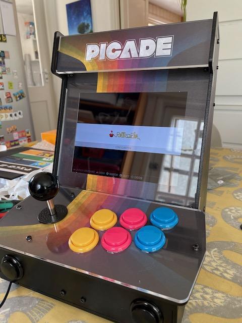

C16521C7-5EF2-4F51-8CC8-8FA3B2147CC2.thumb.jpeg.5adec77fcc81de6bb21f397eba466eb1.jpegThe Raspberry Pi is a brilliant little powerful computer. It’s uses are endless. I have a few around the house. During lockdown I built a cocktail arcade cabinet powered by a Pi4. I also built a small portable one for my nephew for his Christmas. I have another one that runs some software called Pi Hole which means we don’t get any internet adverts. I also have another one that has a DAC attached to it that I can stream music from my NAS or from Spotify. I have a fairly expensive Hi-Fi DAC and the Pi based one sounds as good to my old ears.
