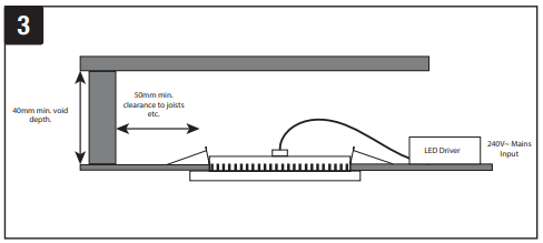

Hilldes Posted October 8, 2021 Share Posted October 8, 2021 (edited) I have a 25mm service batten in vaulted ceilings. I've bought a few of these lights for evaluation: https://www.screwfix.com/p/aurora-slim-fit-fixed-round-led-downlight-500lm-9w-100-240v/1906p Above have alloy body and given off a nice diffused light, but are non dimmable. The CEF ones Nick quoted are a good price, but spec does not say if they are dimmable. If anyone knows of similar recessed shallow flat panels that are dimmable, please share a link. The alternatives are these which are dimmable, are switchable warm/cool white and also give off a nice diffused light: https://www.screwfix.com/p/lap-indopro-fixed-fire-rated-led-downlight-satin-nickel-450lm-9w-240v/8969x ...but the above need to be tested in the void available as they are bang on the depth limit. P.S. VCL is the taped surface of PIR for us. Edited October 8, 2021 by Hilldes 1 Link to comment Share on other sites More sharing options...

Hilldes Posted October 8, 2021 Share Posted October 8, 2021 3 hours ago, TonyT said: Would it be easier to increase the thickness of the timber service batten? I think you are right, I've not done a calculation, but I suspect going from 25mm deep battening to 50mm would not lose that much headroom/usable floor area. Right now, roofing batten (25mmx50mm) is though substantially cheaper than alternatives. Link to comment Share on other sites More sharing options...
MortarThePoint Posted October 8, 2021 Share Posted October 8, 2021 5 hours ago, Hilldes said: I have a 25mm service batten in vaulted ceilings. I've bought a few of these lights for evaluation: https://www.screwfix.com/p/aurora-slim-fit-fixed-round-led-downlight-500lm-9w-100-240v/1906p Looks to need a minimum 40mm void depth though (extract from manual PDF at bottom of Screwfix specifications tab) This one is thin but can't see a void spec and could be low quality: https://hartingtonheath.com/product/i-lumos-led-6-watt-round-recessed-lighting-panel-ultraslim-ceiling-light/ Link to comment Share on other sites More sharing options...
