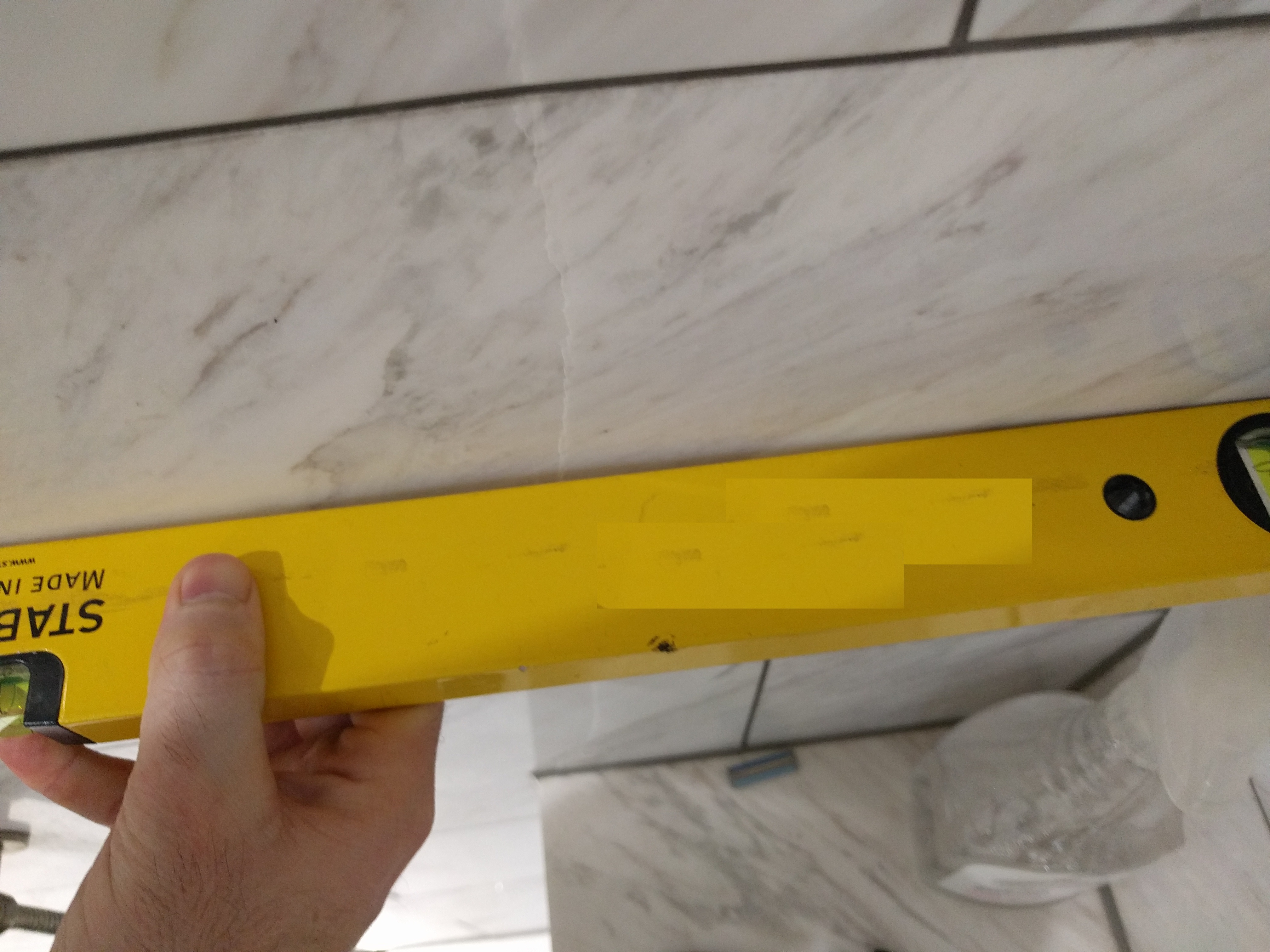

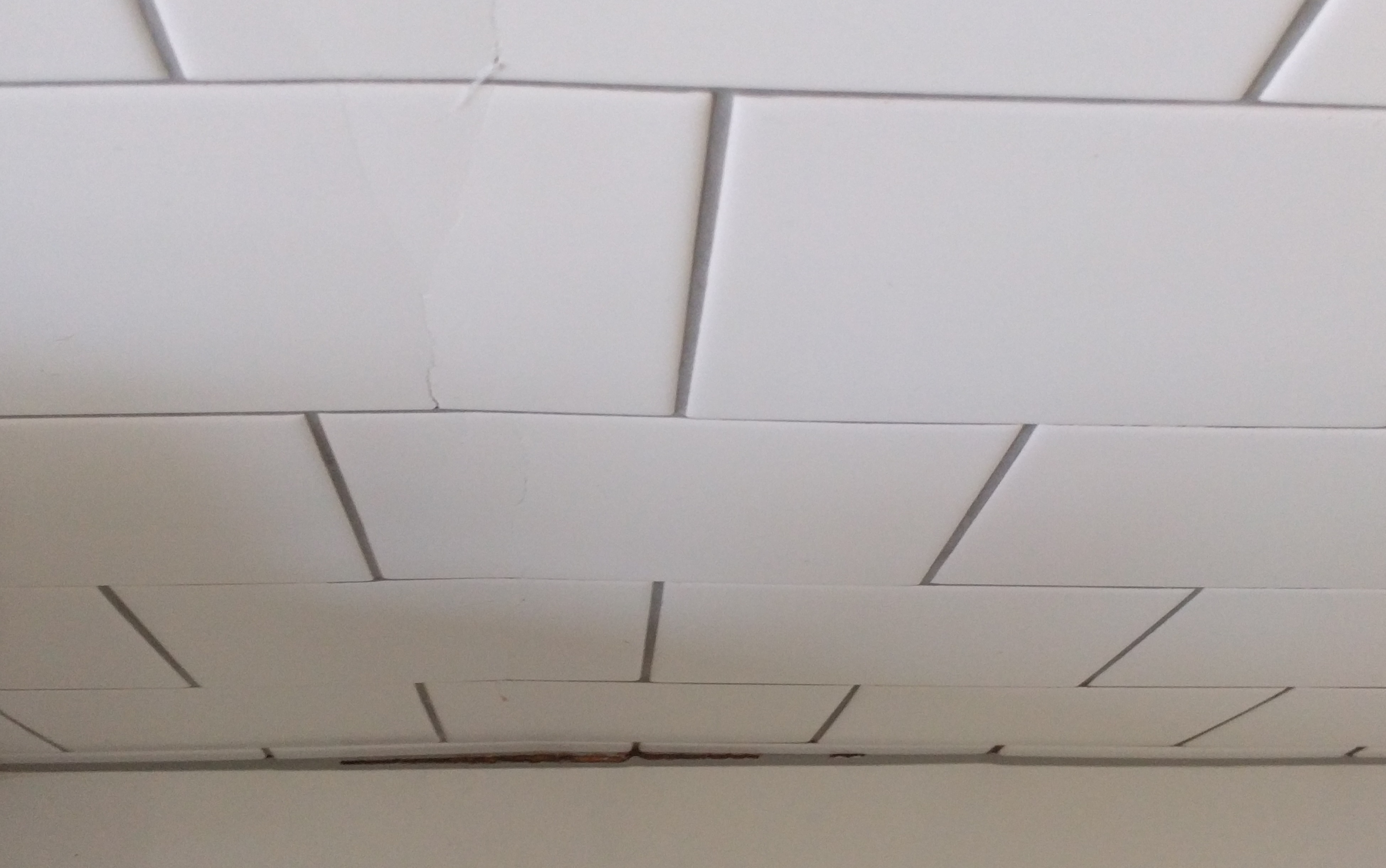

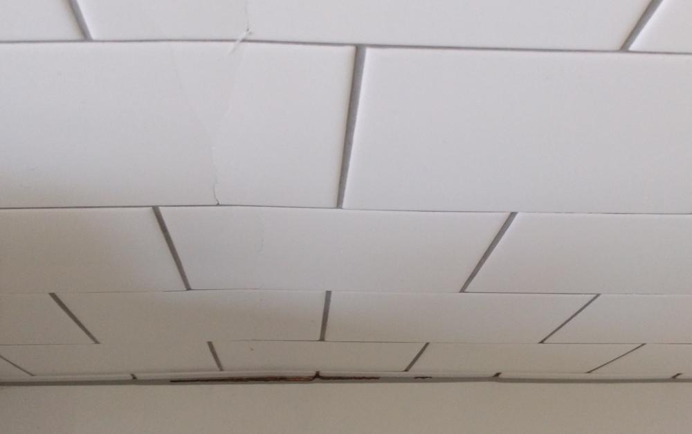

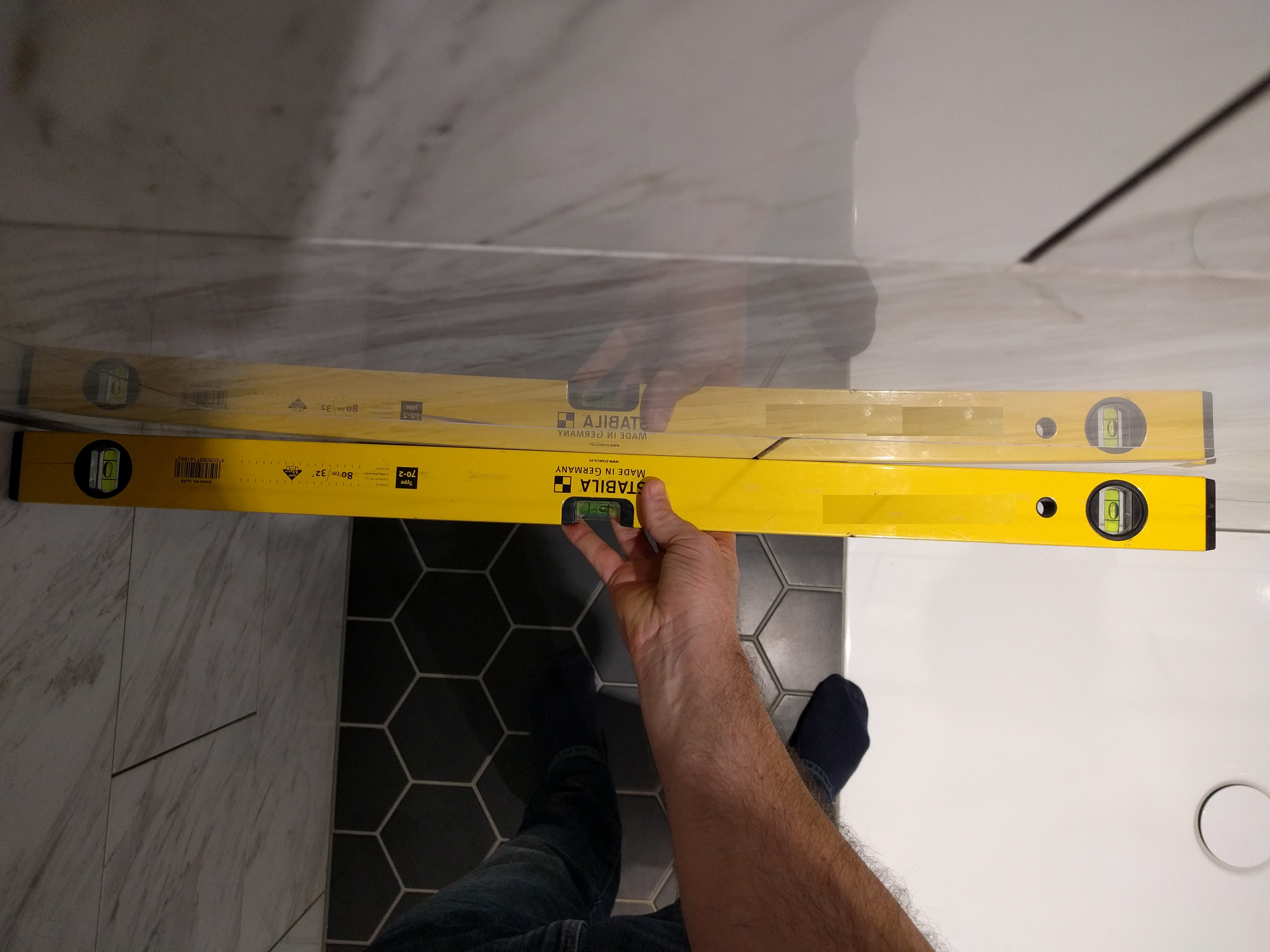

A few months after we moved in, I noticed that we had vertical cracks through the marble tiles in our ensuite.  Shortly afterwards, I noticed that in fact there were vertical cracks in all of the bathrooms.  The cracks follow the lines of the board joints underneath.  We have Hardibacker or some other sort of tile backer board in these areas.
I initially wondered whether it was the house settling along the line of the bathrooms, but the pattern just doesn't fit, plus there's no similar cracking anywhere else in the house.

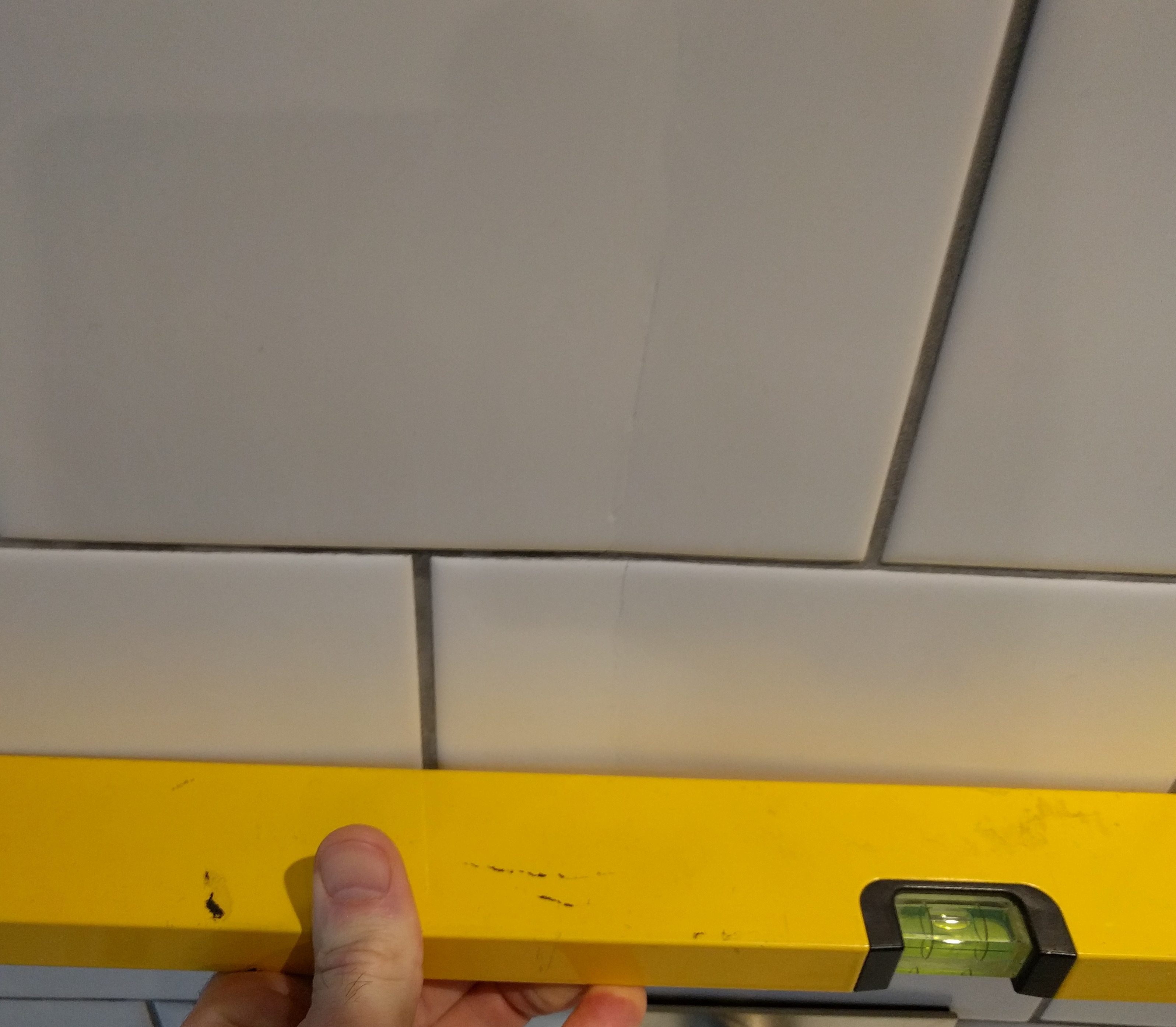

I was about to start chipping out the tiles today to replace them when I noticed how much the walls have bowed in these areas.  A couple of examples:
Crack in marble:
Crack in tile:58dfc1b84ce9f_Crack2.thumb.jpg.bc142e06ad35f0e871b83a751c93329f.jpg
Bowed wall:
I did initially wonder whether it was to do with water, but it's happened even in the second ensuite shower, which hasn't yet been grouted and has never been used.
My next guess is that the adhesive (flexible cement-based for the marble, as recommended by the supplier) has wicked into the hardibacker and caused it to swell and bow.  It just seems like a lot of bowing for that sort of material.
I'm about to start chipping away at the cracked tiles to replace them, but I'm a little concerned that I don't know the cause.  I'm also slightly worried about leaving the bowed sections as they are, but short of tearing everything down and starting again, I can't see what else I can do!
Help please?  :S

That's pretty strange. Our bathroom was clad in travertine over Hardi backer board with no issues.
I'm wondering if your joints weren't done on studs? Is it the centre of a sheet bowing out or the edge bowing in?
Edit: Looking at that last picture it looks like the centre of sheets bowing outwards. Were they screwed to all the studs or just along joints?

I wasn't there, but pretty sure the joints were done on studs.
As far as I can tell, it's the centre of the sheet bowing out.
Posted (edited)
I suspect they didn't screw the Hardi to the middle/all the studs.
Got a metal detector/stud finder (eg to look for the screws)?

how soon after the walls were built did it get boarded and tiled?
My only thought would be that maybe the studs have shrunk and pulled the screws through the board?? it is a bit worrying that it has happened so often though.
I think you have got to take at least the broken tiles off and do some investigation.
+ one to a strong magnet just to see how many fixings are behind the in tact tiles

Another vote for it being a problem caused by fixings.  I think there is a very good reason that our resident expert plumber/bathroom fitter/heating engineer gets a bit focussed on using lots and lots of fixings!
My experience with slight movement in our house has been that there is a small (perhaps 0.5mm) shrinkage of the skim plaster away from most of the windows, and a dozen or so pops in the skim where screws are, plus a very fine crack that appeared in a joint between two bits of plasterboard high up in the entrance gable (since filled and repainted and now seems fine).
The main area where there was shrinkage was the additional MDF covered thin "stud" wall I added to build our walk-in wardrobe.  That stayed in one ~4m long, ~2.2m high piece, but shrank away from the ceiling and wall joints on either side by around 1mm.  My guess is that it's because I didn't leave enough time for the timber to stabilise inside the house before I built the wall.  Since filling and re-painting it it's not moved at all.
It's hard to see how shrinkage in the structure could force the board to bow out that much if it was secured well to the walls.

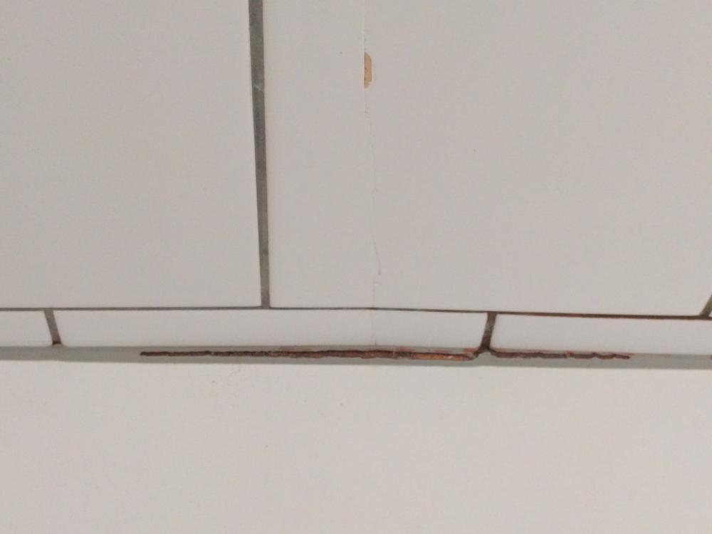

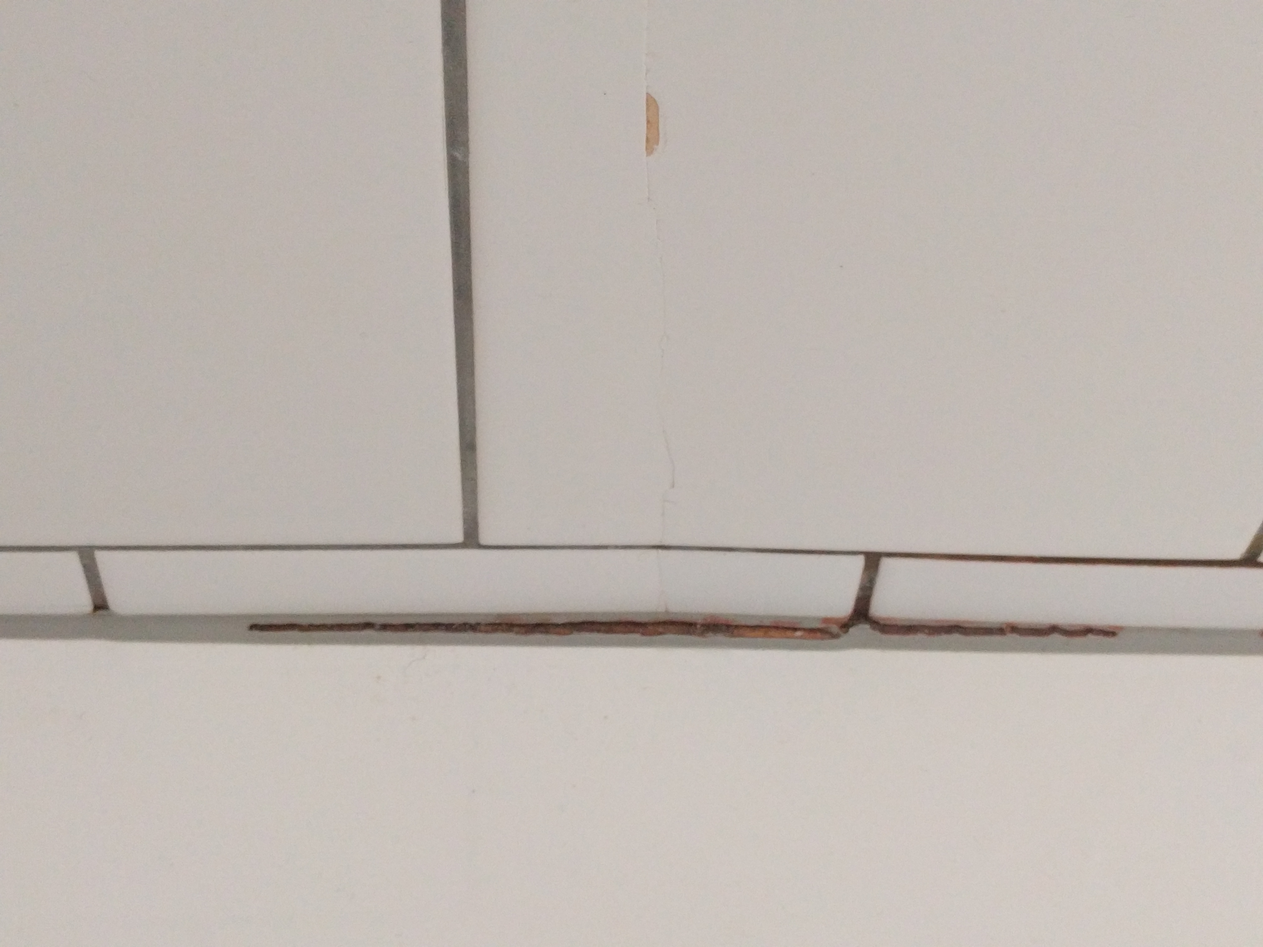

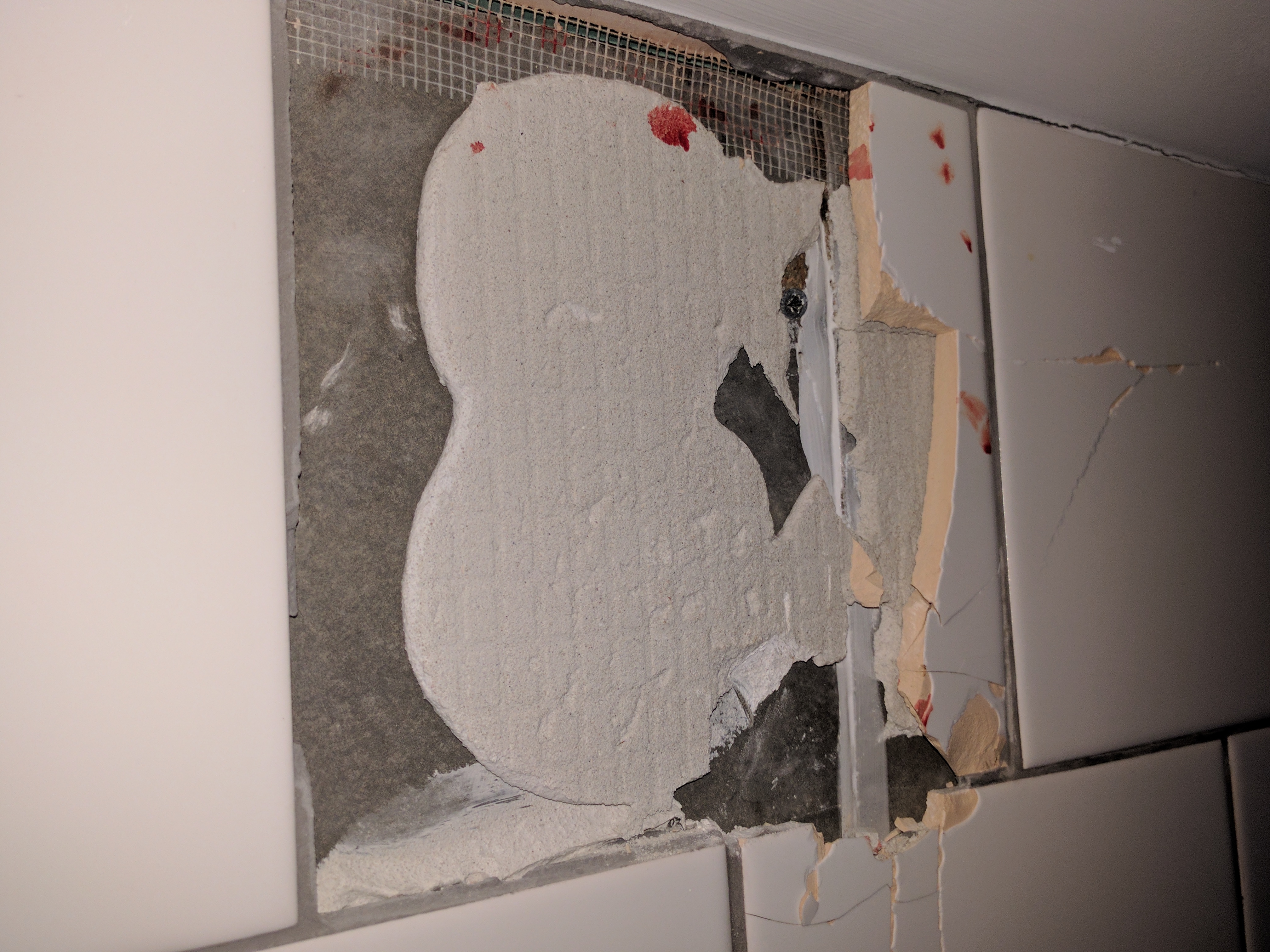

I've taken off a tile on a crack and this is what I can see (ignore bloodstains - spent 20 seconds trying to find dirty water that I thought was leaking in before I realised I'd cut my fingertip!):
The board is darker than it looks in the photo, but it's clearly some sort of cement board.
By way of background (and this is all from memory), I came home from work one day to find they'd used water-resistant plasterboard where the showers were.  I said I wanted something stronger and more permanent, so we agreed I'd pay for them to take this down and replace it with proper waterproof backer board.  This looks very dark to me - darker than the tile backer board we used under the floors a bit later (again involving an argument about what had been agreed in advance - please, please make note of everything that's agreed both upfront and along the way, and put it in writing, either in a site diary or by emailing the person involved as soon as you've had the conversation!)
I wonder whether what's been used isn't a tile backer board but is instead some sort of cement board that isn't rated for this sort of application?
Another comment: I can't get a photo, but I was able to take off an access panel and get at the inside of our built-in bath (white tiles in second pic above).  I can just see where the edge of the board is joined to the frame.  It looks like a couple of screws have partly pulled through the board (which is the same grey stuff as above).  The structure here isn't quite the same as the rest of the walls, as the tiler did it.  The verticals on the built-in bath are a lot further spaced than the studs everywhere else, which actually could emulate quite well the structure if fixings haven't been used on the studs between the edges of the board.
Still a bit of a mystery what's caused the swelling, even if the fixings turn out to be the problem.  While two of the three showers have been used, one hasn't been and it has the same problem.  It therefore isn't (or isn't just) moisture from use that's problem.
Next step is to get hold of a magnet or studfinder and see what I can learn about fixings.

In the last pic I can see some sort of straight strip / joint. What is it?
Also, how the hell can we see a drywall screw head, and even worse it looks proud of the adhesive? The tile adhesive has been blobbed on too, rather than solid bed. :/. None of the affixed area should be void of adhesive.
Take the tiles off jack, as otherwise this is just guess work tbh. Seeing that regular plasterboard screws have been used is not good.

If you mean the vertical white strip, it looks like a line of sealant of some sort.  White mastic that's been squeezed into the joint, I guess.

If that is a join in the boards should there not be more screws visible. At least one in the corner and some along the top plus maybe another along the join.

Not sure if it's just the angle of the photo or not, but that tile adhesive dob looks pretty thick, almost as thick as the tiles.
I'm no expert at tiling, but I've always used a toothed spreader to lay a complete covering of adhesive, to a fairly constant thickness, with the grooves allowing the tiles to be pushed down to the right depth to be flush with each other.  Not sure of the right way to work, but I've tended to cover enough for a row and a bit of tiles at a time, rather than just dob stuff on for each tile.

Get one elevation stripped of tiles and adhesive. Then simply push against the backer boards to check for movement / fixings etc. Let's find out how many screws and where before we speculate any further. ;)
Fwiw, I've blobbed tiles on many a time, but only in instances where they've been on horrendously uneven walls and I've had to pull the wall plumb and straight ( large shower cubicle etc ) so it can be done. I always use cementitious adhesive in theses cases, NOT ready made acrylic stuff, as the latter can only be applied 5mm thick at most as it just doesn't set, literally for weeks, otherwise.
If you have a non-porous background like cement board then you should not be using acrylic full stop, and the same goes if it's a porcelain tile as the moisture just doesn't have anywhere to go.
Same applies again if the area has been tanked, regardless of tile type.

No, definitely some sort of cement board.
Yes, it's a definitely a join between the boards.

Yes, it's pretty thick.

For the marble, we definitely used flexible cementitious (Topps Tiles branded stuff, I believe).  The supplier was pretty adamant about the importance of using that.
I'm not sure about the other tiles, but reasonably sure he used the same stuff.  I know that whatever he used was bagged.
One more data point that for me actually adds to the mystery - this is what the interface with the shower tray at the bottom of the crack looks like:
That picture makes it looks slightly worse than it is in real life.  The close-up is a bit more accurate:
This looks to me like the stud that the crack is along has pulled away from the tray.  The only other option is that the entire tray has moved with the bowing of the wall, which seems unlikely.  Again, I wasn't here when the tray was put down, but I believe it was put onto a plywood base and glued down pretty extensively with Sticks-Like-Sh*t adhesive.
