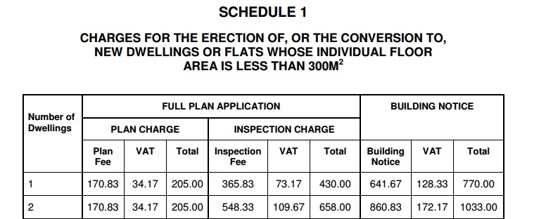

If I decide to go Full Planning Application way (for 2 houses) , I will pay .£205.00 plus £658.00  (please see picture)
Does it include site visits of building inspector ?
and just need to find insurance (is it building insurance, or how it it called?)

Yes my understanding is you would pay £205 + £658 and that includes site visits. Best plan is to conclude each site visit by asking when he wants you to call him back for the next one. If he finds anything that needs fixing or if he suggests a work around send him a letter to confirm what was agreed verbally.

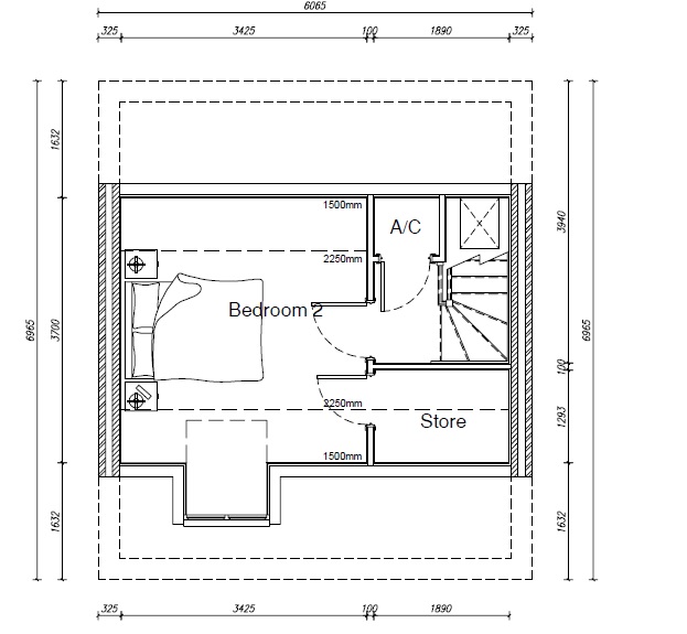

I'm trying to figure out External Floor Area (for the warranty quote)
Ground floor and first floor are ok, not sure about the second floor, with the roof, not sure witch number to use . There is a dormer window too there. Could someone please help?
Thank you
Hi
Rule of thumb is that if the ceiling height is less than 1m it is not counted as floor space.

Hmm, not sure how height it is, can't see this number on the plan.
M
Its via Buildsafe for the warranty.
Height will be on the elevations, and it won't usually be marked ! What happens is they put the scale at a printed page size on the plans (1:50 at A3 etc) and then you just use a scale rule to read it off.
If you use 2.4m for ceiling, and 250mm per floor depth, for the purposes of estimating you won't be far out.
Ground floor 6,965m x 6,065m = 42,24m2
First floor 42,24m2
Second floor 6,065m x 3,7m= 22,44m2
GEA = 106,92m2
I hope I'm right :-)
