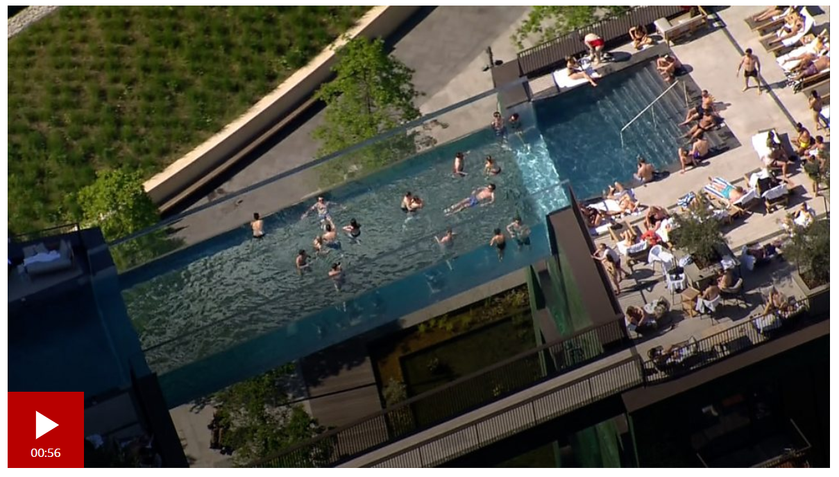

Ferdinand Posted September 3, 2021 Posted September 3, 2021 On the house, I would pause once the weather goes, and do some careful thinking / analysis in the time before Christmas and restart next spring. I think there is a lot of detail that is best sweated now, rather than when you have to change it later. Read some of the site blogs. For the pool, have you considered a natural swimming pool? You don't need heating; you just need not to be a wuss. Though that diving ledge looks dodgy at first glance: 1

ukjamie Posted September 3, 2021 Author Posted September 3, 2021 1 hour ago, Nickfromwales said: Let’s see what the OP says will be the plan for the pool and then we can properly rip into him lol. ? 1 hour ago, Nickfromwales said: Let’s see what the OP says will be the plan for the pool and then we can properly rip into him lol. ? Had this in mind...
