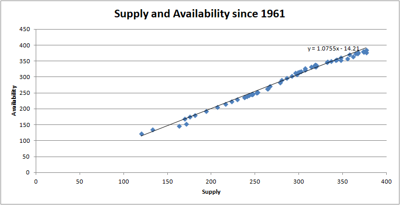

SteamyTea Posted August 29, 2021 Share Posted August 29, 2021 Rather than speculating, here is some historical data from the ONS. For the last 60 years, the UK has almost always (3 day week and other industrial action being the exception) managed to over supply by 7.5%, on average. In recent years this oversupply has got larger. I don't believe that is a coincidence and it is only armchair speculators and keyboard worrier that think they really know what is happening. Link to comment Share on other sites More sharing options...

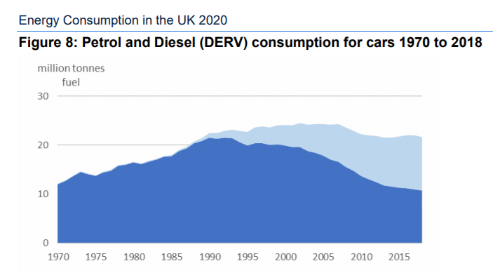

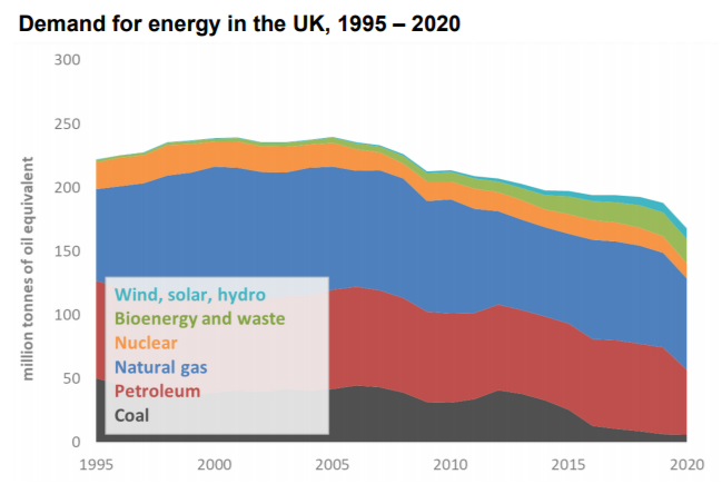

ProDave Posted August 30, 2021 Share Posted August 30, 2021 14 hours ago, Ferdinand said: Given that nuclear regulation is independent and statutory, I think that "Chernobyl incoming" is a little overwrought. I note that we have 2 gas power stations mothballed with 2/3 the capacity of Hinckley Point C, and that energy demand has been significantly falling for 20 years now. https://assets.publishing.service.gov.uk/government/uploads/system/uploads/attachment_data/file/1007132/DUKES_2021_Chapters_1_to_7.pdf That's an interesting graph, but must be total energy not just the electricity generation? But it shows we were only able to phase out coal because of reduced demand, NOT because the coal generation has been replaced with an equal capacity of something else that is less polluting. Link to comment Share on other sites More sharing options...
