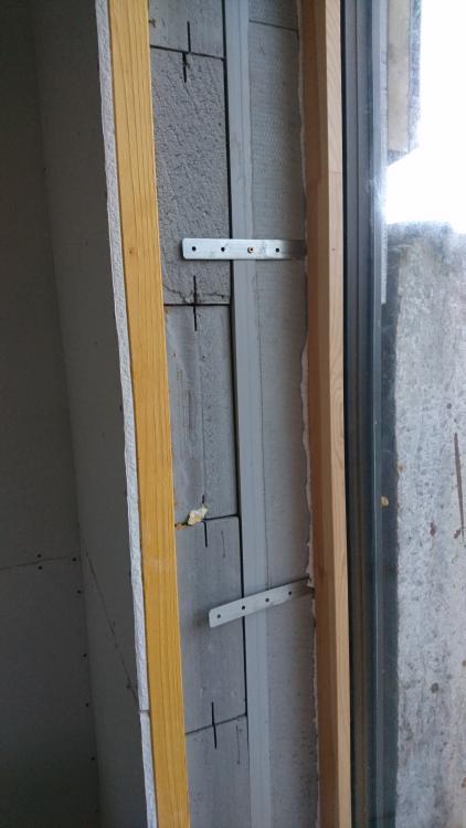

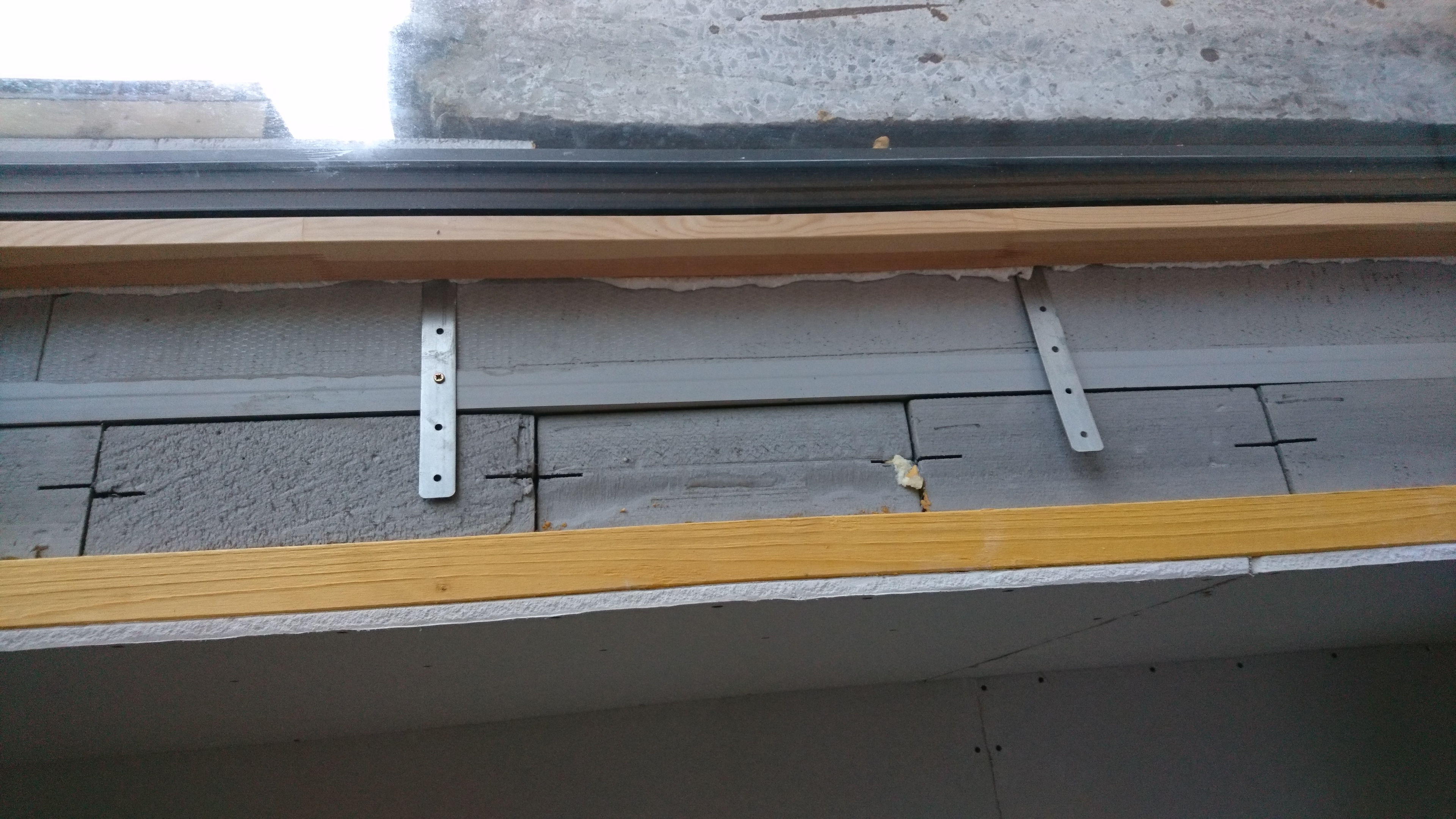

Looking for some suggestions as to the best way to plasterboard the window reveals. As some will know, the window company screwed up the order and all the windows were 20mm too large, which has in turn messed up the detail at the reveals. Anyway - we are where we are.
It's easier to show a pic - what would folks suggest is the best way to complete this detail? The brackets are a bit of a problem, more so because the windows are too big and sit closer than I want to the wall but as much because they interrupt the continuous surface which will warp the gyproc. My thinking was - 6mm ply screwed into the vertical reveal which, using packers, should give a level surface (or only ply the sections between the brackets), then screw the gyproc into that.
Is there an option to partially 'dot and dab' the part closest to the window and screw the other side into the batten?? If so, what would I use to stick the gyproc to the insulation?
All thoughts welcome! Thanks, Jamie
First thought is why are the brackets not fixed? what holds the windows in?

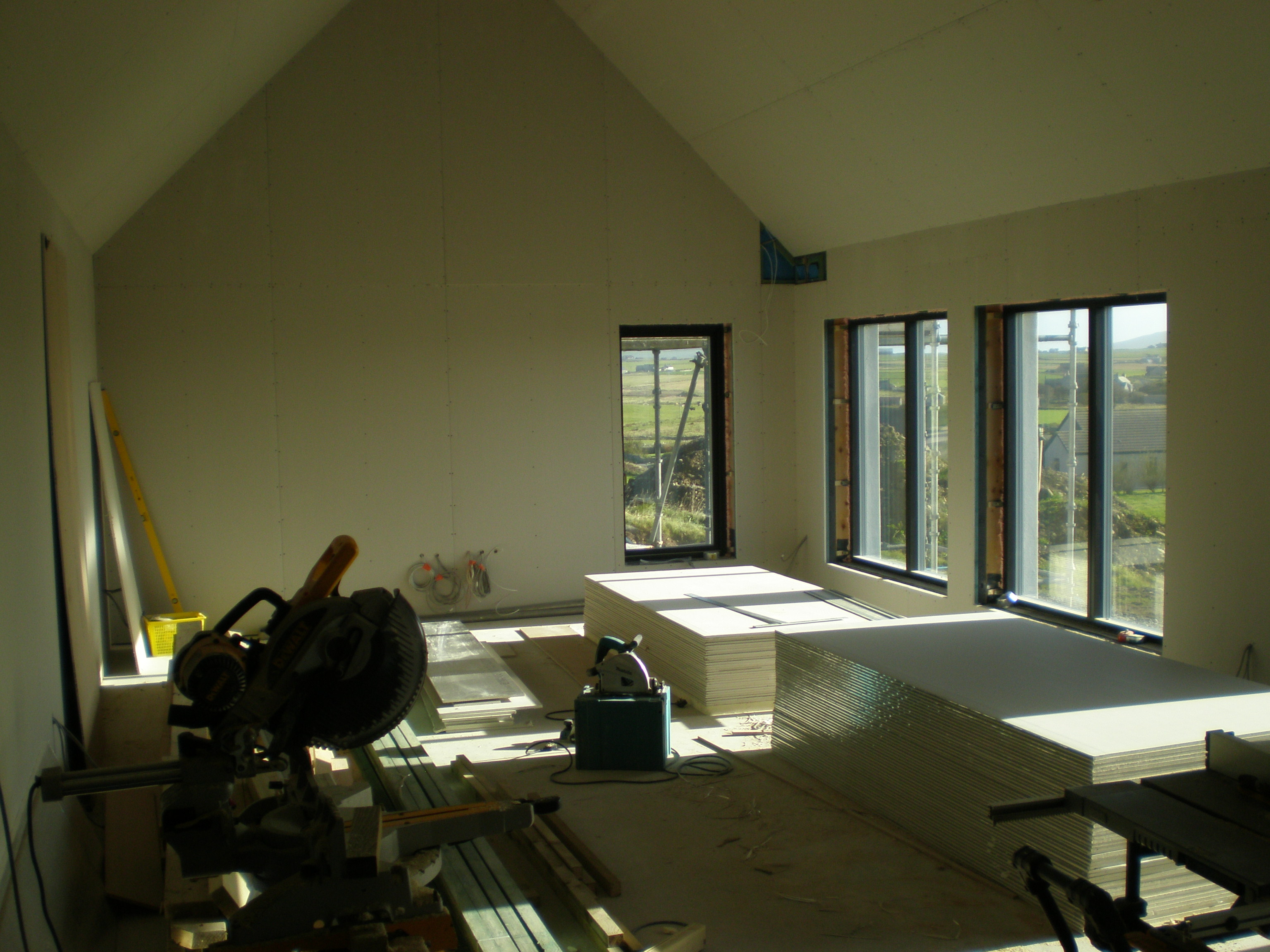

Funny enough this is a similar detail that that I have been working on recently. It's a bit different in my case as it's TF, but the window reveals are clad in Kingspan and the windows then fixed with brackets.  The "complication" in my case was twofold, one the brackets were individually packed with little squares of plywood, so that left an uneven surface to fix plasterboard to. and secondly the screws through the brackets, the heads sat so proud of the bracket.
My solution, was replace the individual packing pieces with a continuous sheet of ply on the inside of the window reveal. This then just leaves the fixing plates a little proud of the plywood and it's thickness is pretty insignificant. And to solve the screw issue, countersink the holes in the fixing plate and replace the screws.
In my case I can fix with long plasterboard screws through the kingspan into the timber frame. I am not sure what you would screw into, so some form of adhesive might be the way to secure the window end.
Ah!  Bad example!  They are all screwed into the plastic on the sides bar that one and screwed directly into the concrete lintel at the top.  On that side alone  there are 5 brackets.  It's seen 60mph winds this winter and never budged :-}
I like the counter sinking to help bring the screw heads down. Once I've done that I'll put ply between the brackets screwed and adhered to the plastic then screw the gyproc into that.
Any recommendations for ply to XPS? More to just help keep it together than the primary method of fixing.

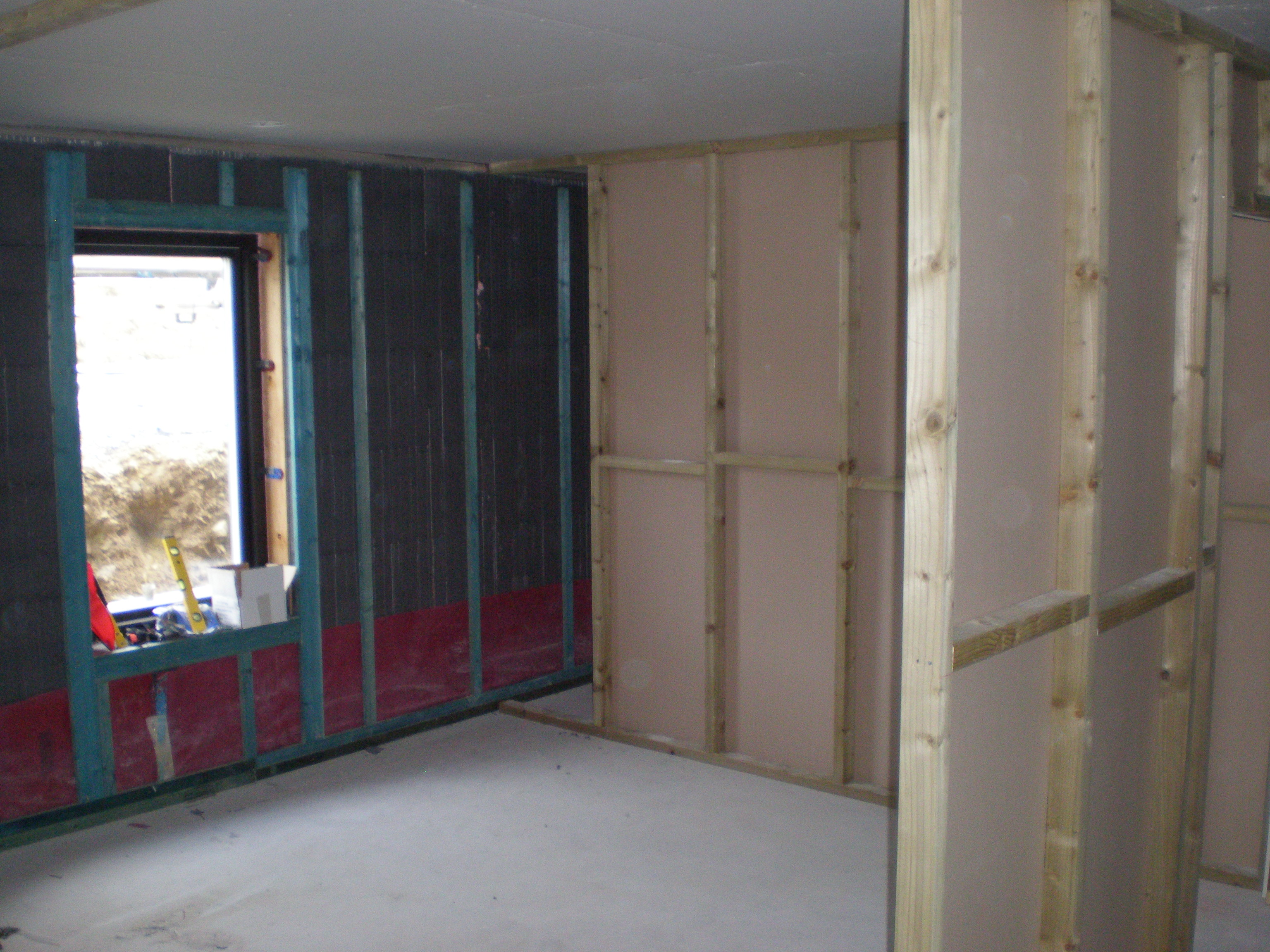

Appreciate these are not the best of pictures (didn't take any specific snaps of this detail) but this is how our window reveals were finished:
Battens were used on the inner face of the ICF block to square off the window opening.  The windows themselves were fixed with straps (packed as required) off the timber formers which closed the opening in the ICF core.     Lengths of batten were then cut and fitted (again, packed where required) between the straps so that there was a solid and level point of fixing at both ends of the reveal to screw the plasterboard onto.
I would just adopt the same method but use the 6mm ply you have already identified.
