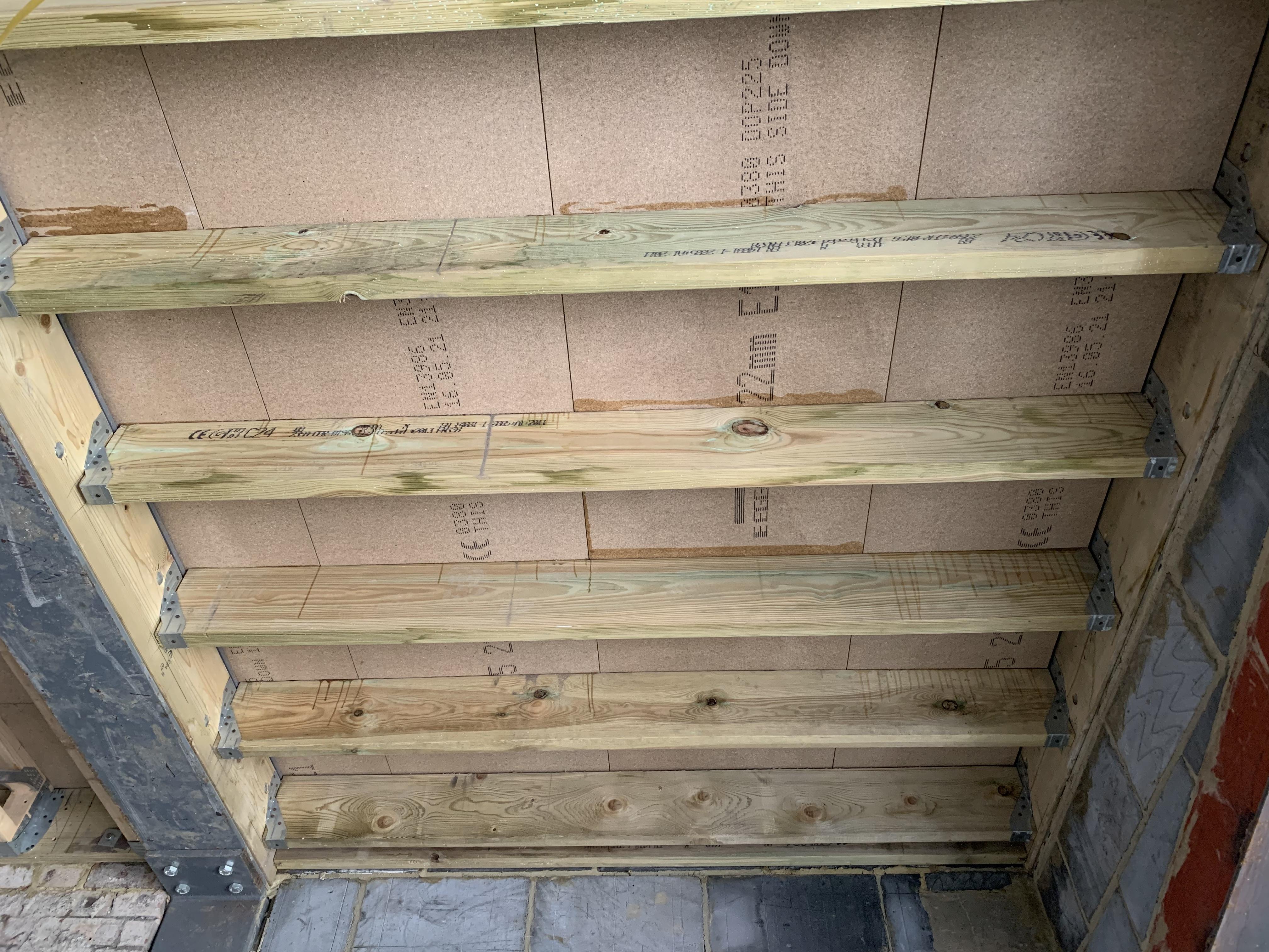

Adsibob Posted September 4, 2021 Author Share Posted September 4, 2021 (edited) Update: builder agreed to redo two rooms where he hadn’t put glue between floor joists and chipboard. That hasn’t been done yet, but will happen soon I’m told. In the meantime: 1) I bought him loads of the blue floor tite screws and told him to use those instead of the regular screws he’s using; and 2) he’s done another room, this time he has clearly used glue in the right place but I remain concerned that it is the wrong glue. The video on caberdek’s site shows a glue that when it dries it foams slightly and dries like an opaque slightly off white colour, almost yellow. This glue has dried clear with no foaming, but maybe it is just Caber’s glue that does this, not Egger. See picture. They possibly also didn’t use two beads of glue as sometimes the glue has only dribbled out on one side of the joist. If I’m right about this, then it’s really just F-ing annoying. Getting closer to sacking territory. But given they have at least used floor tite screws this time, I wonder if using the wrong glue and possibly only one bead rather than two will matter? Edited September 4, 2021 by Adsibob Link to comment Share on other sites More sharing options...
Cpd Posted September 4, 2021 Share Posted September 4, 2021 I may have missed something but shouldn’t there be glue obviously leaking from between the joints in the chipboard? 1 Link to comment Share on other sites More sharing options...
Adsibob Posted September 4, 2021 Author Share Posted September 4, 2021 3 minutes ago, Cpd said: I may have missed something but shouldn’t there be glue obviously leaking from between the joints in the chipboard? Yes, you are probably right. This just gets from bad to worse. Link to comment Share on other sites More sharing options...
joe90 Posted September 4, 2021 Share Posted September 4, 2021 (edited) 11 minutes ago, Adsibob said: Yes, you are probably right. This just gets from bad to worse. I think you are right, my floor had foamed glue all over the place. It tends to foam when moisture is about, if your timber is very dry it may not foam. I had beads of foam above and below the joints and dribbling from the top of the joists. Then again if plenty of screws are used yours should be tight. Edited September 4, 2021 by joe90 Link to comment Share on other sites More sharing options...
epsilonGreedy Posted September 4, 2021 Share Posted September 4, 2021 2 hours ago, Adsibob said: Getting closer to sacking territory. If your latest photo is the example of your builder trying to do things correctly following your initial complaint, then yes time to part ways. He has not used the right glue because there is no evidence of any foaming, it looks like a thin contact adhesive. This is not just a caberdeck specific thing. When done correctly the fastidious self builder will spend an hour or two scraping the foam dribbles off the floor below. Link to comment Share on other sites More sharing options...
Mr Punter Posted September 4, 2021 Share Posted September 4, 2021 It was not so long ago that they did not use the PU foaming glue, just a PVA one on the t&g between the boards. Nothing on top of the joists and the boards were fixed down with Paslode nails. Most of these worked fine. I have had some floors recently done with PU glue on joists plus screws and have had some squeaks. Neither system is 100% but both are mostly good and squeaks can normally be solved by chucking in a box of screws. Just check it before you put down the floor finish. Link to comment Share on other sites More sharing options...
Adsibob Posted September 4, 2021 Author Share Posted September 4, 2021 26 minutes ago, epsilonGreedy said: If your latest photo is the example of your builder trying to do things correctly following your initial complaint, then yes time to part ways. He has not used the right glue because there is no evidence of any foaming, it looks like a thin contact adhesive. This is not just a caberdeck specific thing. When done correctly the fastidious self builder will spend an hour or two scraping the foam dribbles off the floor below. Extremely close to sacking him over this and generally inability to follow instructions. He told me he was not doing this this week and then he did it anyway. Only thing saving him from the sack right now is that I understand there is an extreme lack of labour these days. Link to comment Share on other sites More sharing options...
Adsibob Posted September 4, 2021 Author Share Posted September 4, 2021 19 minutes ago, Mr Punter said: It was not so long ago that they did not use the PU foaming glue, just a PVA one on the t&g between the boards. Nothing on top of the joists and the boards were fixed down with Paslode nails. Most of these worked fine. I have had some floors recently done with PU glue on joists plus screws and have had some squeaks. Neither system is 100% but both are mostly good and squeaks can normally be solved by chucking in a box of screws. Just check it before you put down the floor finish. You are probably right, but my concern is not just that there are no squeaks before floor finish goes down. I want no squeaks for the next 20 to 30 years. That's why I went with a product that has a "lifetime guarantee". I guess my only real option now is to double up on the floor tite screws. Egger also show that one can paint over the joins with their adhesive which appears to protect them from moisture ingress, so maybe we should do that as well. Link to comment Share on other sites More sharing options...
Cpd Posted September 4, 2021 Share Posted September 4, 2021 40 minutes ago, Mr Punter said: It was not so long ago that they did not use the PU foaming glue, just a PVA one on the t&g between the boards. Nothing on top of the joists and the boards were fixed down with Paslode nails. Most of these worked fine. I have had some floors recently done with PU glue on joists plus screws and have had some squeaks. Neither system is 100% but both are mostly good and squeaks can normally be solved by chucking in a box of screws. Just check it before you put down the floor finish. Your right that it’s not the end of the world @Mr Punter and plenty of extra screws should do the job, however it would really rile me that after repeated instructions the builder has ignored the request to to it the “proper” way. Not worth sacking him but all future work will need to be carefully monitored to make sure he is not taking the piss. Link to comment Share on other sites More sharing options...
Mr Punter Posted September 4, 2021 Share Posted September 4, 2021 A downside of the D4 glue is you get black hands for 2 days. The PVA is much less messy. As with all adhesives, the surfaces need to be clean and free of dust, which does not always happen on site. Typically you will be using a circular saw on an area of already laid floor to cut some boards, with the new stack of boards close to hand and and everything with a nice film of sawdust. Link to comment Share on other sites More sharing options...
Adsibob Posted September 4, 2021 Author Share Posted September 4, 2021 16 minutes ago, Mr Punter said: A downside of the D4 glue is you get black hands for 2 days. The PVA is much less messy. As with all adhesives, the surfaces need to be clean and free of dust, which does not always happen on site. Typically you will be using a circular saw on an area of already laid floor to cut some boards, with the new stack of boards close to hand and and everything with a nice film of sawdust. Is D4 always black? Is it possible they used another manufacturer's D4 glue that dries clear? Link to comment Share on other sites More sharing options...
Mr Punter Posted September 4, 2021 Share Posted September 4, 2021 1 minute ago, Adsibob said: Is D4 always black? Is it possible they used another manufacturer's D4 glue that dries clear? No the glue is snot coloured but your skin goes black after contact. Link to comment Share on other sites More sharing options...
