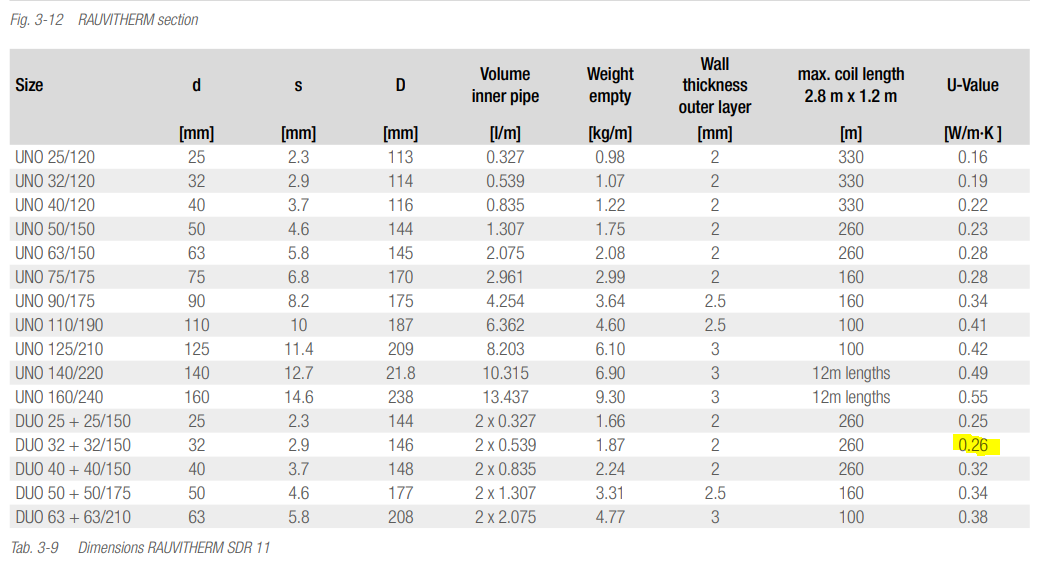

Clearly, having a warmish water flow in a pipe that needs to cross 10m of garden in the middle of winter is less ideal than something stapled to your heat envelope. But insulation is surprisingly good, and wrapping say 10m outside pipe in say 200mm worth of insulation.. surely that would only drop temp "a bit"?
I was told by the Installers the recommended Max distance from (a mono block) ASHP to UVC (not just the distance outside the house) is 10m.
I assume the manufacturers' COPs and SCOPs etc. are based on that Max.  I put my UVC quite central in the house so had a 20m pipe run, 15m of which is under the slab to the ASHP. To mitigate the extra length I used a pre-Insulated twin-pipe duct from Rehau - the Rauvitherm SDR DUO 32+32/150 with a claimed U Value of 0.26 W/m-K

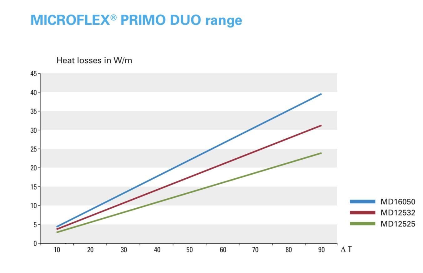

A quick hand calc suggests that with a flow temp of around 50°C and a ground temp of 8°C (I've used the twin-pipe duct for the underground portion of the run) the energy loss is around 11W/m (7.25W/m for a 35°C flow temp)
For your 10m run that suggests quite a small 110W loss when heating the cylinder, and less when space heating (assuming lower flow temp). So with a worst case COP of 2.5 that shouldn't be costing you more than 44W extra electricity into your ASHP. A small loss, but with you for the entire life of the installation.
Edited by IanR
Somewhat counterintuitive for me that the U-values go up with bigger pipes, but I guess more radiation surface = more loss rather than that the thickness of the actual insulation makes things better..
Larger pipes for same duct size means less insulation = higher U Value = higher energy losses.
OK maybe not. But. The thing I'm missing is - you say 44W extra usage, but presumably an ASHP isn't running all day, and it isn't 8C every day either, so I assume you're not saying this is effectively having a permanent 24/7 44W load on my electrical bill, but in that case:
Correct, the notional extra 44W is when the ASHP is heating the DHW Cylinder. So not for very long each day ie. 1 - 2 hours perhaps. A lower wattage, depending on flow temperature, for when the ASHP is supplying heat for Space heating, which may run for more hours per day depending on your property heat losses.
8°C is the ground temperature, which is fairly constant all year at 8°C - 10°C

The heat loss along a supply pipe could be significant. I once put in ASHP with 20m pipes. As well as the super expensive proper insulation, we surrounded it with surplus PIR filled cladding, before backfilling. Worked fine.
