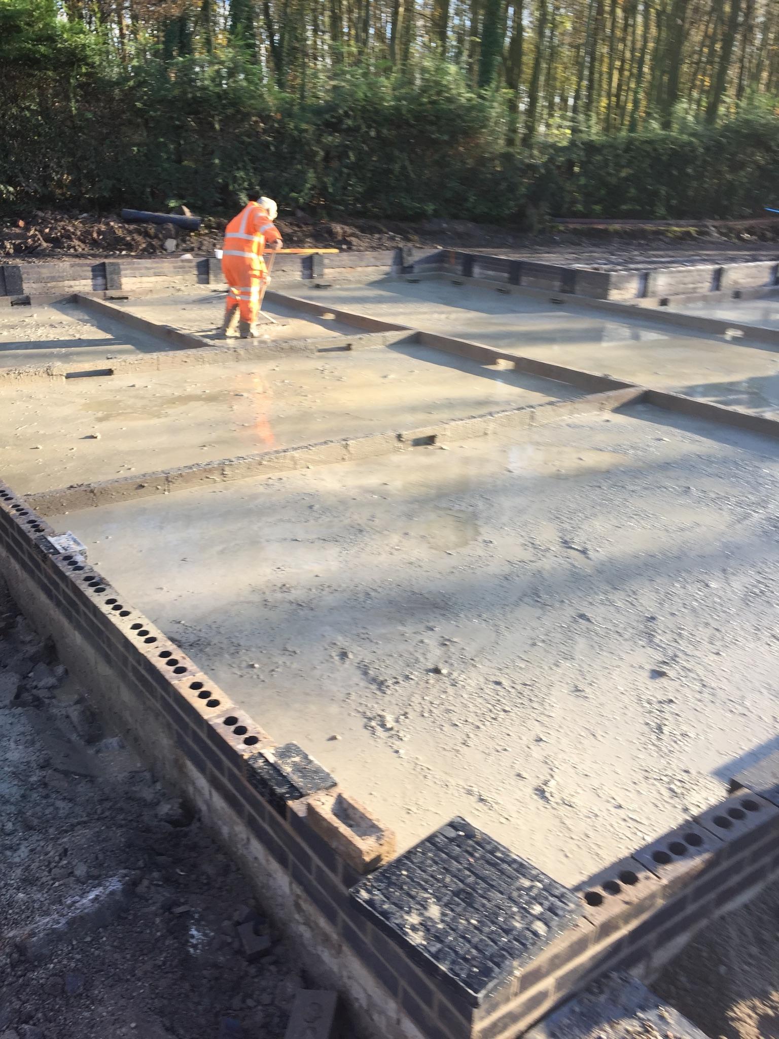

nod Posted July 23, 2021 Posted July 23, 2021 I’ve just been having this conversation today The sites I work on don’t even bother with hardcore Quick weed kill Done As I stated in my previous post Quite a while back I thought it was way over the top to put 6 cube of concrete under the BB and a drain But once it was on my foundation design I had little choice Probably the most miserable day of the job 6 cube in pouring rain Now After done the freak storms we’ve had I’m not so sure Our tank is only 10 metres away from the house We could easily end up with the contents under the house our next one is on clay also I will at least stone up under the BB Or May concrete and drain like the last one It was a days work and about 500 quid so not a lot in the grand scheme of things 1

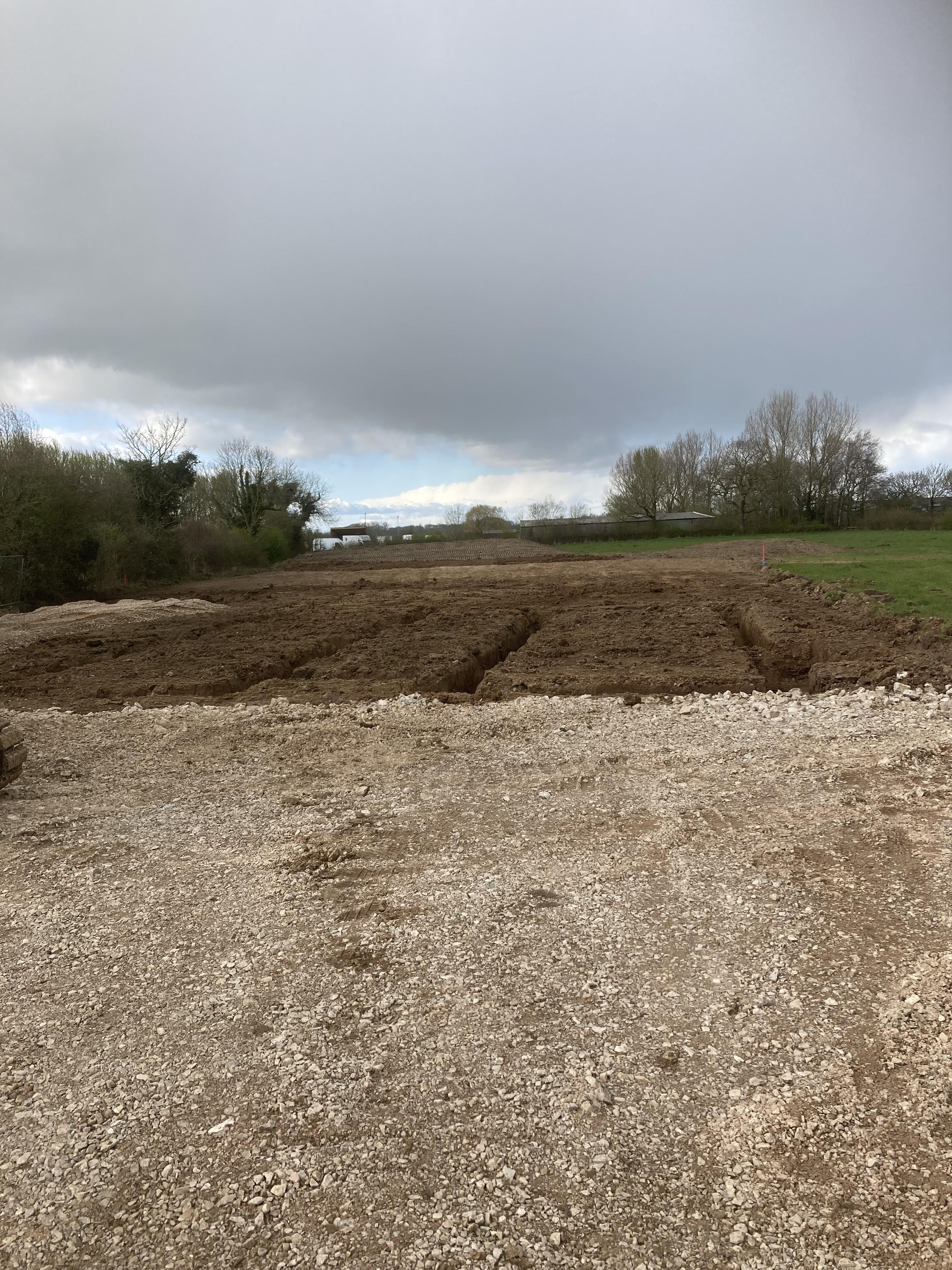

ruggers Posted May 16, 2023 Posted May 16, 2023 @nod or anyone, I'm having my site cleared and the foot print of the house plus 360 perimeter path around it down to clay level ready for setting out and founds dug. I haven't spoken to B.C yet but had some saying to stone the whole foot print in 150mm compacted crush stone then set out and dig through, and using the stone removed back on the drive area. Or to leave it as clay, build up to DPC, and dont put anything under the beam and block floor just leaving the air 150mm gap. I think I'd be looking at 80t of stone so £1000.. Whats the drain you refer to underneath?
nod Posted May 16, 2023 Posted May 16, 2023 No That would be a waste of money You will have to put some stone down for the lorries Just to get upto the foundations Get them dug Then get some stone around the perimeter and anywhere you will need to get a delivery crane BMs etc This is all that I did prior to concreting 1
ruggers Posted May 17, 2023 Posted May 17, 2023 This is exactly what i was going to do, i have the stone to the front for vehicles to drive in and park up to be loaded, i just wasnt sure if B.C ask for something under the beam and block, like stone or dry mix. It seems a waste to me if vegetations removed and its away from light, but i was unsure if there was another reason for it. Despite not wanting to due to cost, The only reason i was going to stone the footprint, was with it being a wet site and needing an 8t machine on to dig the mass fill founds, it could all get chewed up if it continues to rain on and off. I need the founds dug in the next few weeks to meet the pre 2022 regs cut off, currently its all graded nice and flat but its wet after just being completed and no land drains in yet.
nod Posted May 17, 2023 Posted May 17, 2023 On our first build we put concrete under the BB As there was a possibility of flooding There’s no requirement to put anything under there Most large site give the area a spray with weed killer then put the BB in 1
