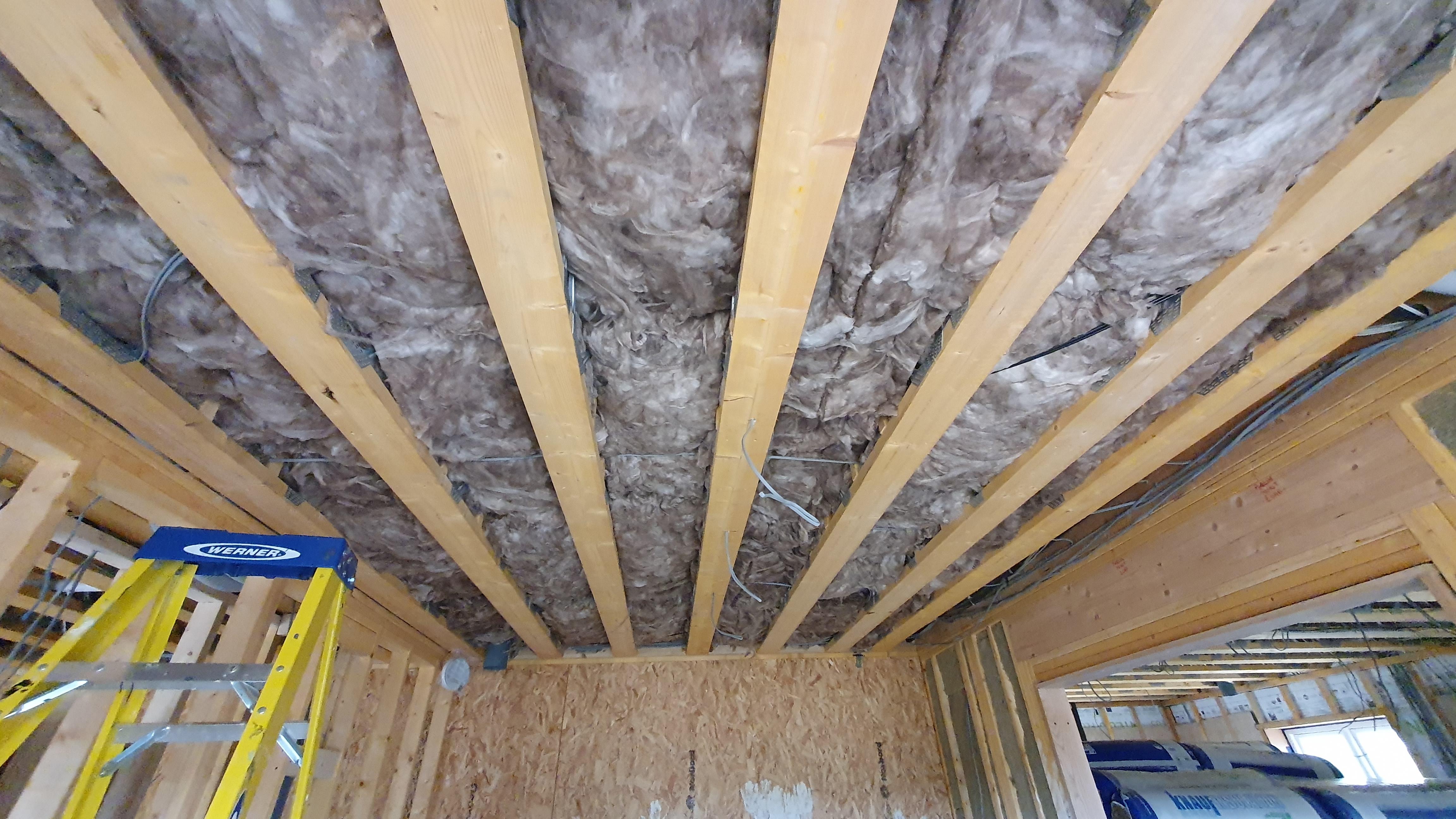

Anyone have experience of fitting mineral wool acoustic insulation to metal web/posi joists? How to keep it in place (suspended)? How to get it between the metal webs within a joist? And where do you put it relative to other services?
We have 253mm high posi joists at 400mm centres.

Just push that bad boy in and it will stay. I oversized my cuts slightly by 20mm and then pushed it in.
In the metal webs I cut strips the width of the the pozi and threaded it through.

Use 600 wide rolls and push it between the 400 centres Sitting on the bottom edge
You don’t need to go in and out of the webbing

Thanks all. The frame batts I have are for studs at 600mm centres so should be a snug fit. The product I have is Isover frame batts not as itchy as some but not great when working overhead.
 Is that because if you use an oversized width for 600mm centres, it will naturally push into the webs above the bottom chord of the joist?

We do
Most contractors prefer us to curl either edge up 100 mil

Put the insulation in after first fix mate.  Not an issue with posi joists.
