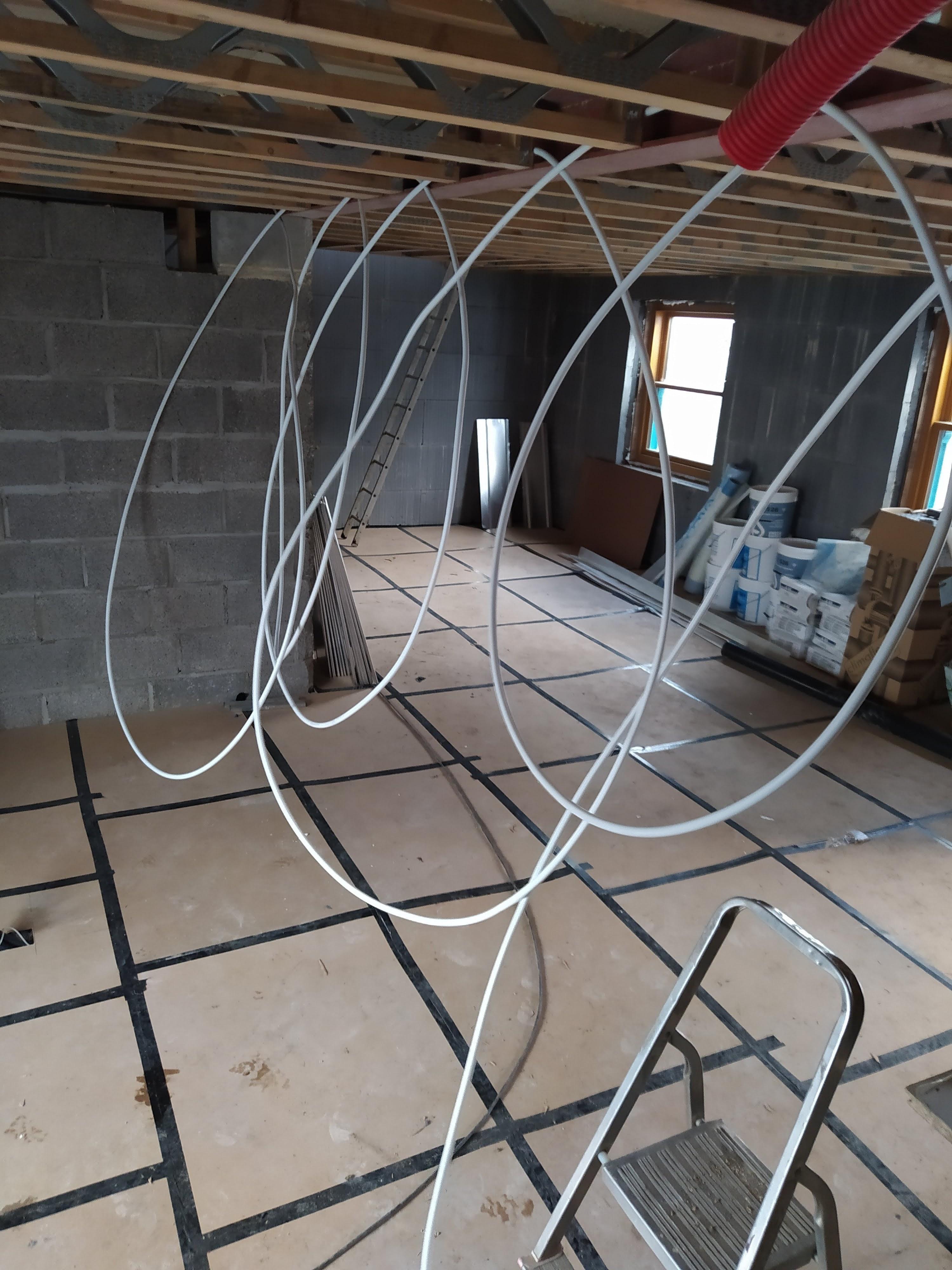

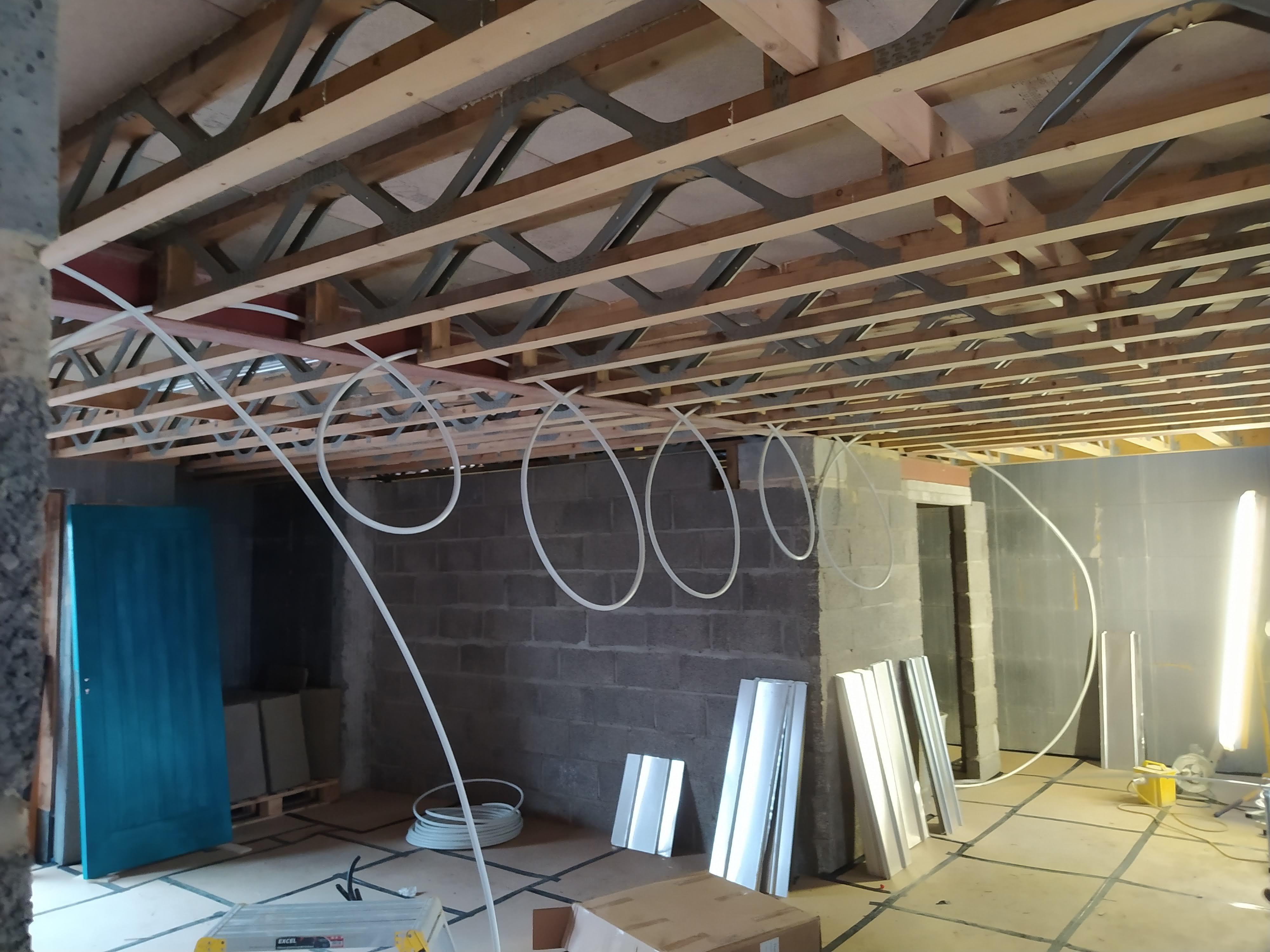

Thanks for the tips and pics @willbish. We had a play that involves a similar technique - thread the pipe straight through the line of joists in a straight line then withdraw a loop down a gap between two joists. See pic. This worked really well - the pipe was on the decoiler outside in the sun on a hot day. Will try for real in a few days (need to complete fire protection lining of the plant rooms - a separate thread). Plan will be to withdraw one loop then secure in spreader plates from below before pulling down the next loop. Then cut pipe from the decoiler and thread through for the return back to the manifold. Hoping the warm weather will return.

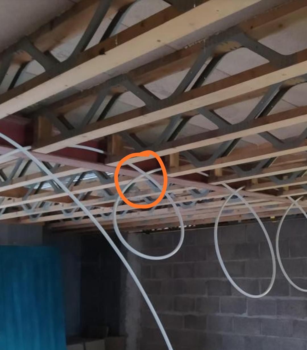

I tried this initially and ended up with kinked pipe. If you create a loop in each section whilst feeding through the joists you won't have such tight bends. See how my pipe crosses itself.
Go with this technique and it's a doddle ??

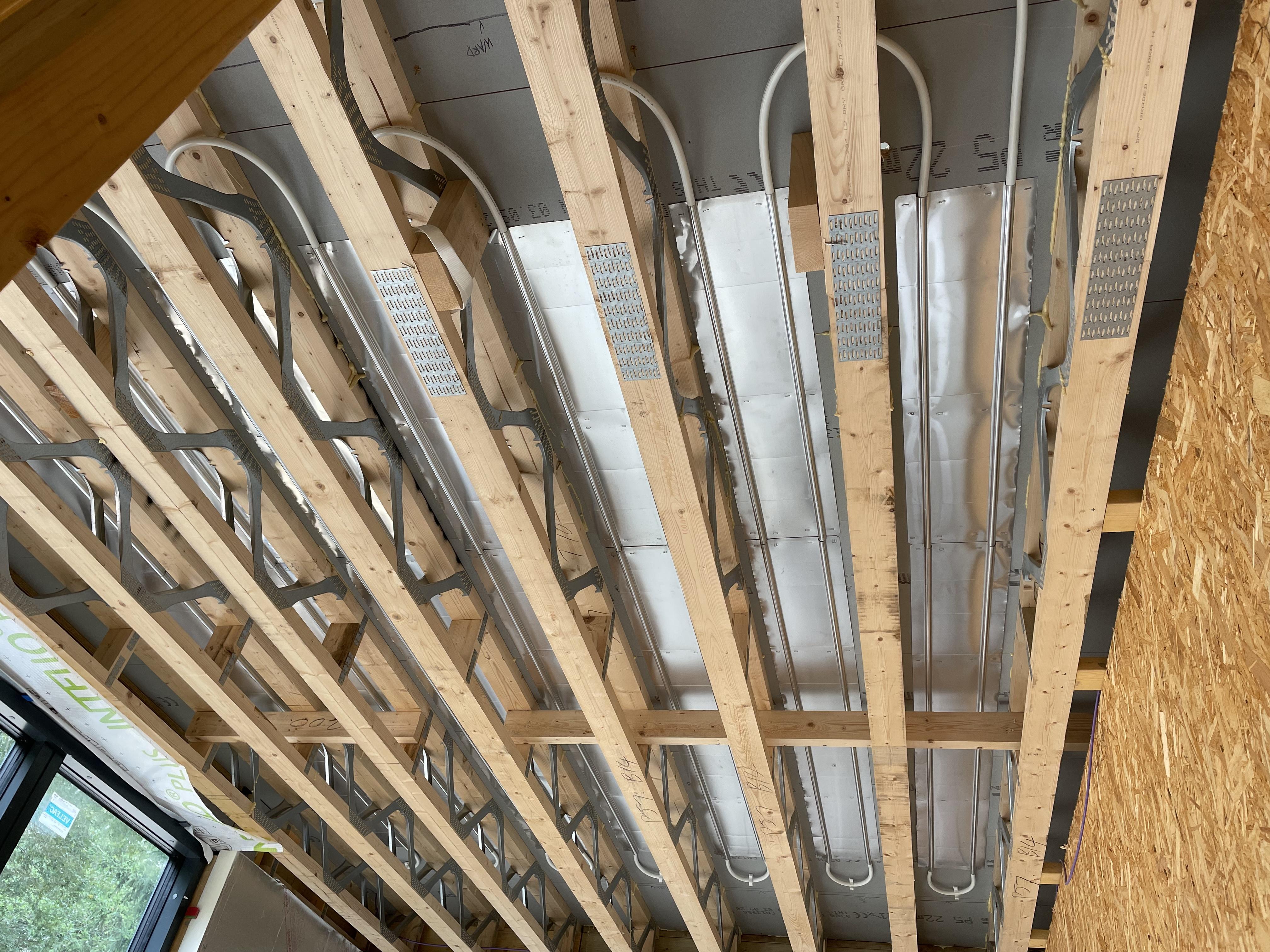

A quick update on threading pert-al-pert pipe through posi joists and fixing with spreader plates. Now completed the first section for real with loops pulled down between joists and not a single kink. Takes some time to plane the route to pull through and time consuming to complete the install. I did price up switching to Wunda over floor, but that added £5K and I suspect would not be much quicker in areas that require duo boards to be laid on to of Wundatherm.

Isn't there a section of 2x4 strongback missing in the last photo?
All the joists should be cross-connected to each other I think?

Thanks for pointing it out @Hastings. I’ll have a look at other areas of the house to compare.  All joists have noggins where they meet internal and external walls, but I’m not sure about the timber you refer to mid-joist. The joists were delivered as cassettes which May explain it.
@HilldesI'm just going by the official Posi installation pdf from their website that I used to install mine. Yours might well have different specs and method etc.
