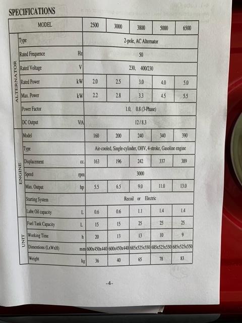

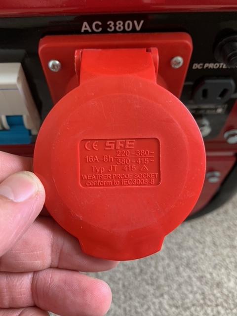

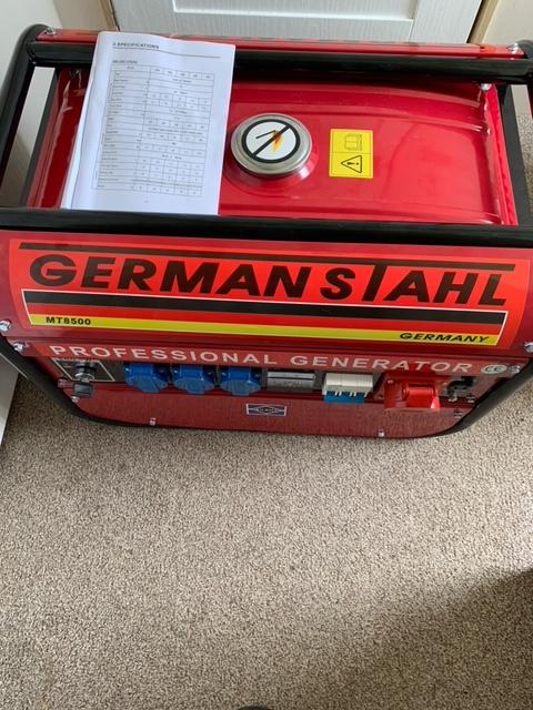

KTB Posted July 21, 2021 Author Share Posted July 21, 2021 1 hour ago, markc said: Caravan can be whatever you expect to run on electricity. If you have no electric heaters and only want to have lights, TV and boil a kettle occasionally then 16A is fine. Whats more important is the size of the generator KVA? Thanks Mark, it's this generator - Its a German model, with a really terrible manual - I need to change the connector too - Currently trying to source a wiring diagram We really only need to run the electrics for the gas boiler, the lights and a TV, daily hoover and shower, occasional kettle - all the rest is gas. Link to comment Share on other sites More sharing options...

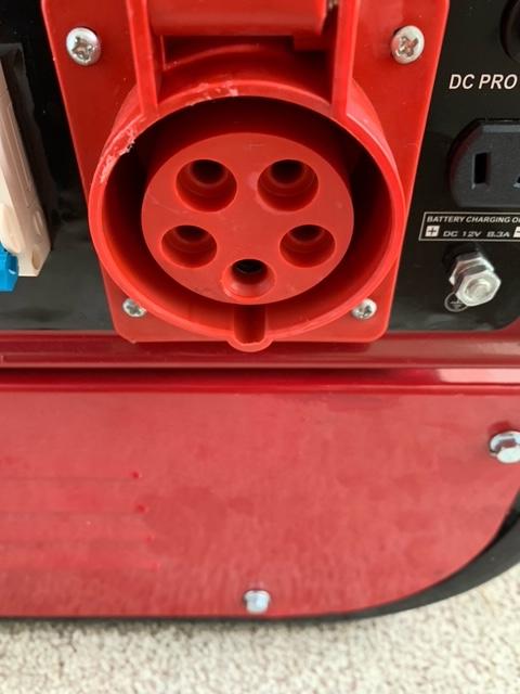

markc Posted July 21, 2021 Share Posted July 21, 2021 @KTB thats a decent gennie, I would keep the red 3 phase plug and split your usage on the caravan. Bit of faffing but would get the best out of the generator and prevent lights diming or tv problems while using shower etc. a sparky will know what i mean. Then again as this is only temporary, just get a 16a 5 pin 3 phase plug and pick up one phase and neutral. Link to comment Share on other sites More sharing options...
KTB Posted July 21, 2021 Author Share Posted July 21, 2021 3 minutes ago, markc said: @KTB thats a decent gennie, I would keep the red 3 phase plug and split your usage on the caravan. Bit of faffing but would get the best out of the generator and prevent lights diming or tv problems while using shower etc. a sparky will know what i mean. Then again as this is only temporary, just get a 16a 5 pin 3 phase plug and pick up one phase and neutral. Thank you Mark - I'll grab a plug later and give it a try 1 Link to comment Share on other sites More sharing options...
markc Posted July 21, 2021 Share Posted July 21, 2021 @KTB just make sure it is a 16a socket on the generator, i am assuming it is but cant be 100% certain from here Link to comment Share on other sites More sharing options...

KTB Posted July 21, 2021 Author Share Posted July 21, 2021 1 hour ago, markc said: @KTB just make sure it is a 16a socket on the generator, i am assuming it is but cant be 100% certain from here Yup, looks like it Link to comment Share on other sites More sharing options...
PeterW Posted July 21, 2021 Share Posted July 21, 2021 Ahhh yes it’s a Hong Weng Chinese Plug Company socket … Weatrer Proof..?? 1 Link to comment Share on other sites More sharing options...
markc Posted July 21, 2021 Share Posted July 21, 2021 11 minutes ago, PeterW said: Ahhh yes it’s a Hong Weng Chinese Plug Company socket … Weatrer Proof..?? haha, German Engineering at its finest Link to comment Share on other sites More sharing options...
ProDave Posted July 21, 2021 Share Posted July 21, 2021 3 hours ago, KTB said: Thanks Mark, it's this generator - Its a German model, with a really terrible manual - I need to change the connector too - Currently trying to source a wiring diagram We really only need to run the electrics for the gas boiler, the lights and a TV, daily hoover and shower, occasional kettle - all the rest is gas. That generator is less useful than you think, unless you want to drive a 3 phase load. I bought one from a man selling it out of his van, brand new, identical to that but a different silly name. Each of the 3 single phase outputs are a surprisingly small rating and you CANNOT connect them on parallel to get more load, so unless you are going to rewire the caravan with a 3 phase board to split the loads it will be very limiting. Once I realised how rubbish it was I advertised mine on Gumtree and sold it for more than I paid the man with the van. Link to comment Share on other sites More sharing options...
Nickfromwales Posted July 21, 2021 Share Posted July 21, 2021 4 hours ago, KTB said: Its a German model, with a really terrible manual - I need to change the connector too - Currently trying to source a wiring diagram Seriously ?!? Do NOT even THINK of running different phases in a caravan off that red outlet. Lethal advice, unless you go to a new 3ph CU with all RCBO's. Cheaper to buy a proper 1ph genny. Leave it well alone and sell off this boat anchor. ? 1 Link to comment Share on other sites More sharing options...
ProDave Posted July 21, 2021 Share Posted July 21, 2021 I think the one I had had a PEAK rating of 7KVA, but that is loading all 3 phases. So the peak load on one phase was about 2.3kVA not even enough to run a kettle. And that was the peak load, not continuous. If I recall it had a copy of a Honda engine powering it. as @Nickfromwales says dispose of it and buy the best single phase generator you can. Link to comment Share on other sites More sharing options...
Nickfromwales Posted July 21, 2021 Share Posted July 21, 2021 You'll be able to sell a tidy one on again. That other thing needs to be gotten rid of as is, eg less any bastardization etc. Link to comment Share on other sites More sharing options...

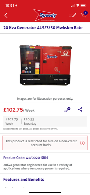

KTB Posted July 22, 2021 Author Share Posted July 22, 2021 16 hours ago, ProDave said: I think the one I had had a PEAK rating of 7KVA, but that is loading all 3 phases. So the peak load on one phase was about 2.3kVA not even enough to run a kettle. And that was the peak load, not continuous. If I recall it had a copy of a Honda engine powering it. as @Nickfromwales says dispose of it and buy the best single phase generator you can. Didn't realise it was a heap of junk - Thankfully, I just borrowed it from a mate - I'll get on the phone to speedy and hire a decent single phase one - Have an electricity install date of the 30th anyway Link to comment Share on other sites More sharing options...
KTB Posted July 22, 2021 Author Share Posted July 22, 2021 Looking at this one - Any good (connectors dependent) Link to comment Share on other sites More sharing options...
Nickfromwales Posted July 22, 2021 Share Posted July 22, 2021 That’s 415 again. Ask for one with a 32a single blue socket outlet if poss. As it’s short term, get one which just connects to the CU without arsing around 1 Link to comment Share on other sites More sharing options...
