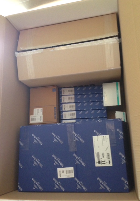

I love Megabad
We bought almost all of our bathroom fittings from Megabad, including Hansgrohe showers, Grohe taps, V&B loos and sinks etc . Their website is not the easiest to navigate (google translate plugin helps) but their prices are great, even after including shipping and the low euro exchange rate at present. Reutershop.de is easier to naivgate and has a few items cheaper so best to compare, it uses the same product codes so easy to find same stuff on Megabad.
Use one of the many online currency transfer people to dump the cash into the MB bank account and your gear is shipped immediately - you can also split shipments (for a small fee) if you have out of stock items  - they will automatically follow on.
But the real reason I love them is their Germanic packing - uber efficient. The outer box was millimeter perfectly sized for the contents...

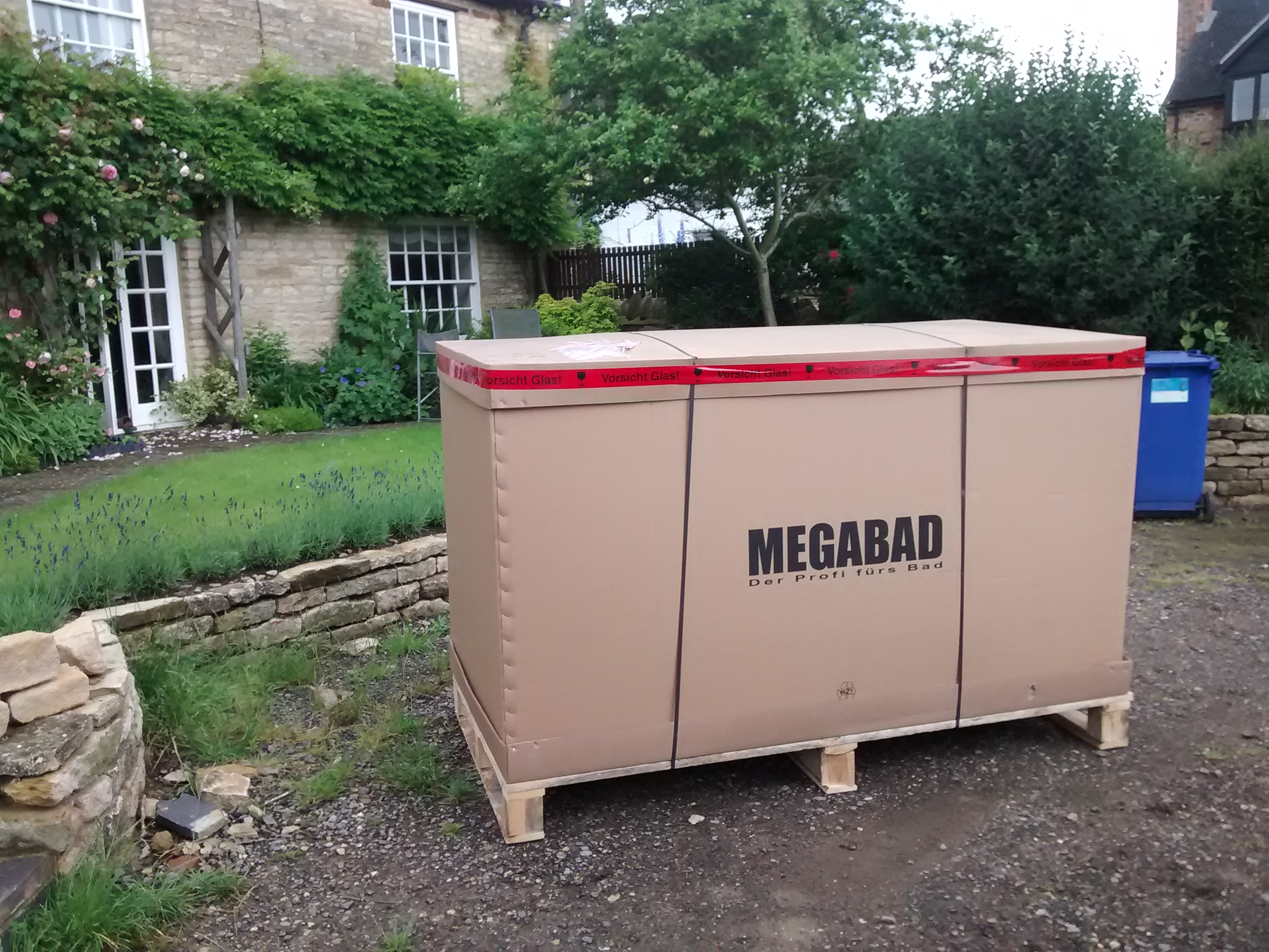

MB will also let you split a delivery if you need immediate shipping of in stock items or you can wait for everything to come in and get it in one lump.
Note, the courier (Dascher UK) will deliver by pallet truck and our first box was enormous and very heavy so we had to cover it in tarp to stop it getting wet until we had enough hands to empty it into the house.

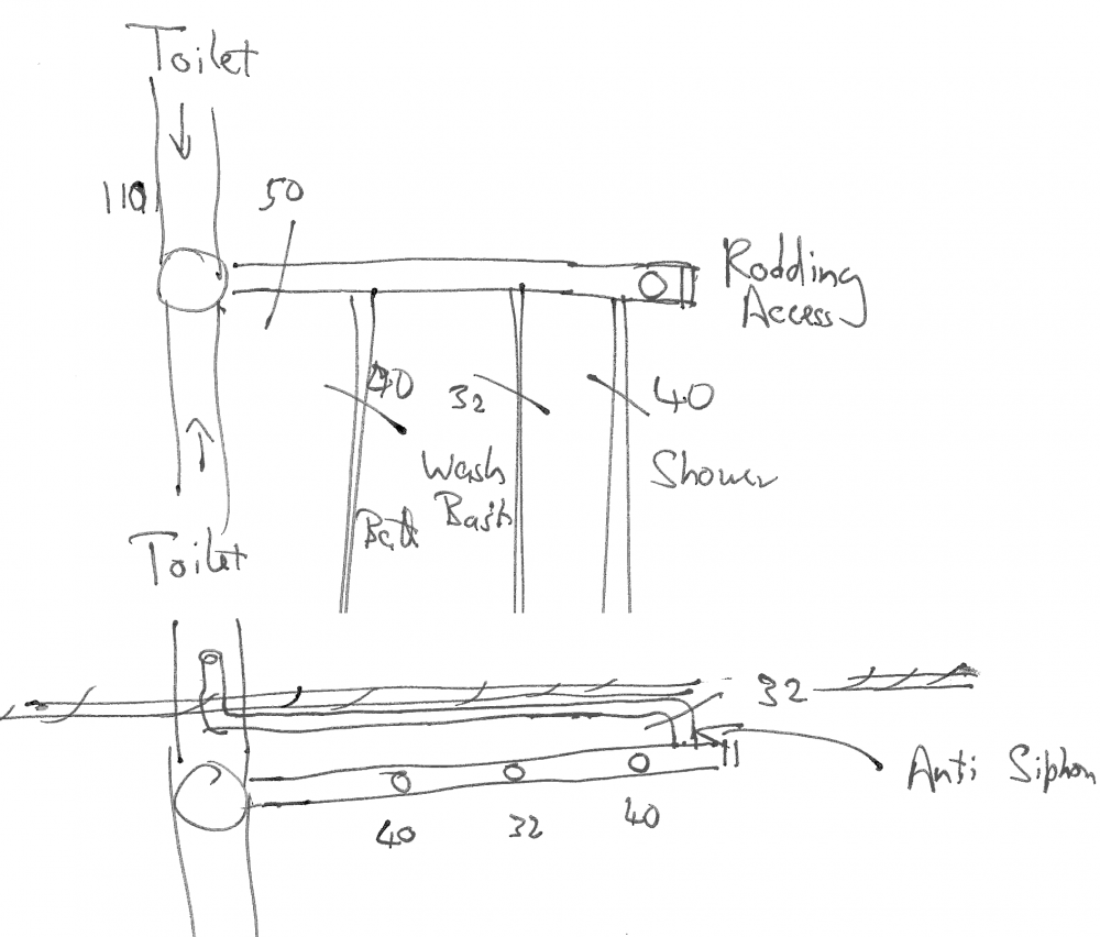

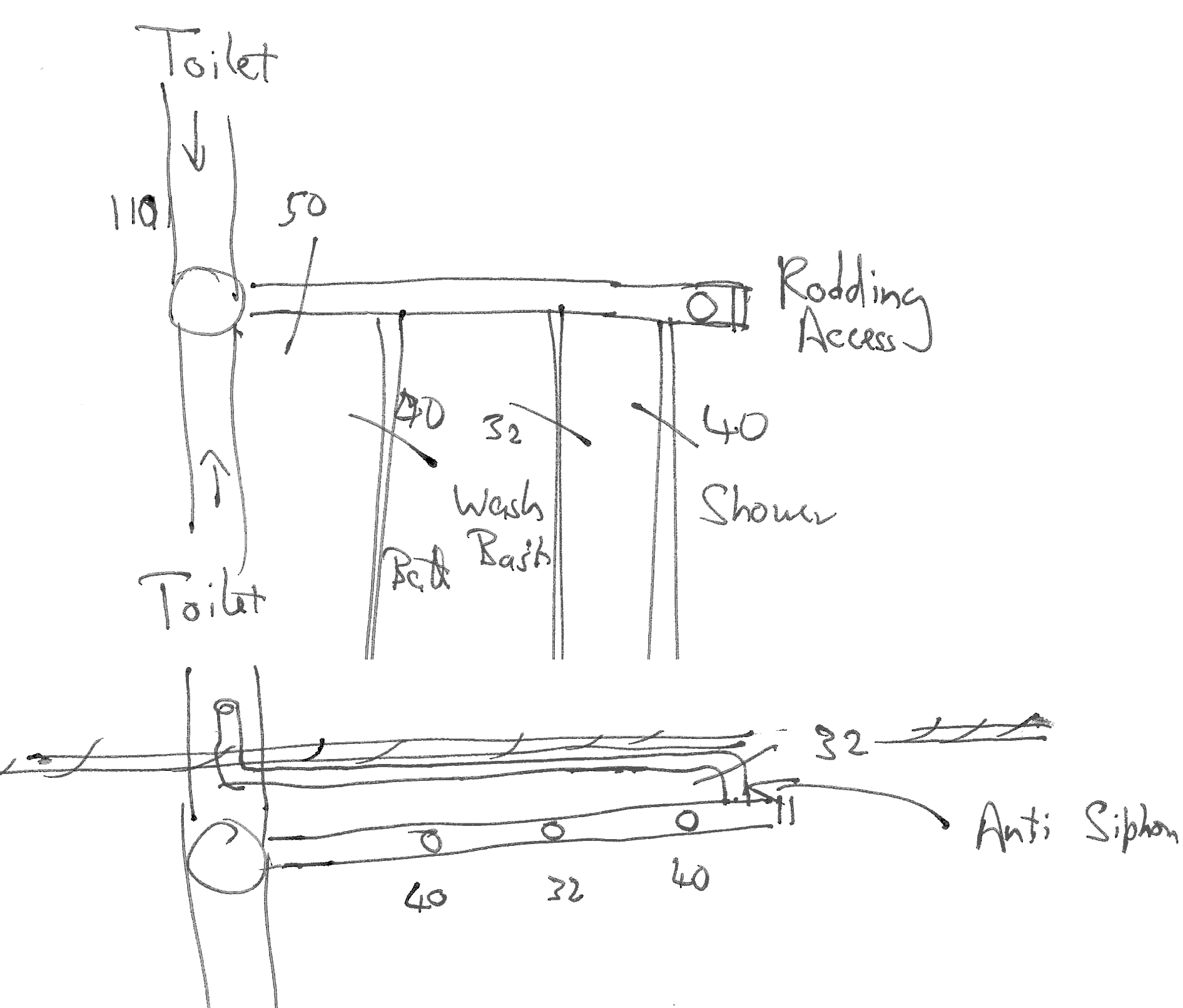

Nick, the challenge that we have is fitting the foul-water runs within the PosiJoists which prevents 45° runs, and that the bath, and (the adjacent BR en-suite) basin and shower have exposed or builtin traps so we can't use an anti-siphoning trap.  My 1980s solution would have been to add an anti-siphoning loop like the diagram below.  Is this still allowed / valid under BRegs. Any better suggestion?
Link to comment
Share on other sites
The kick back loop will be fine, but you'll need to take it up to attic height and fit a 50mm AAV which is accessible.
For the runs which you show T'eed in multiple times just use one of these with a 45 out of the middle to rectify you back to 90 degrees. That way you'll get the water naturally flowing to the stack plus you'll be able to get a narrow flexis rod through the tee and down the leg ( should you ever need to do so ). Generally best practice to use swept branches rather than flat T's as the latter create a wall which the water has to hit against before deciding which way to fall. That is quite problematic for shower and bath wastes as it massively reduces the natural flow velocity, but not so problematic for a basin.
Link to comment
2 hours ago, Nickfromwales said:
The kick back loop will be fine, but you'll need to take it up to artic height and fit a 50mm AAV which is accessible.
Thanks, I understand the swept bend issue, but on the ventilation loop, why do I need to take it up to an AAV in the attic?  As it happens, I can do this as three is a party wall that I can go up.  However, I would have just hooked back into the stack via a boss, but thinking about this the potential issue is spillover after blockage.  The lowest spillover point is the shower tray in BR1 en-suite, then the bath and then the sink.  Need to think a little more :)
