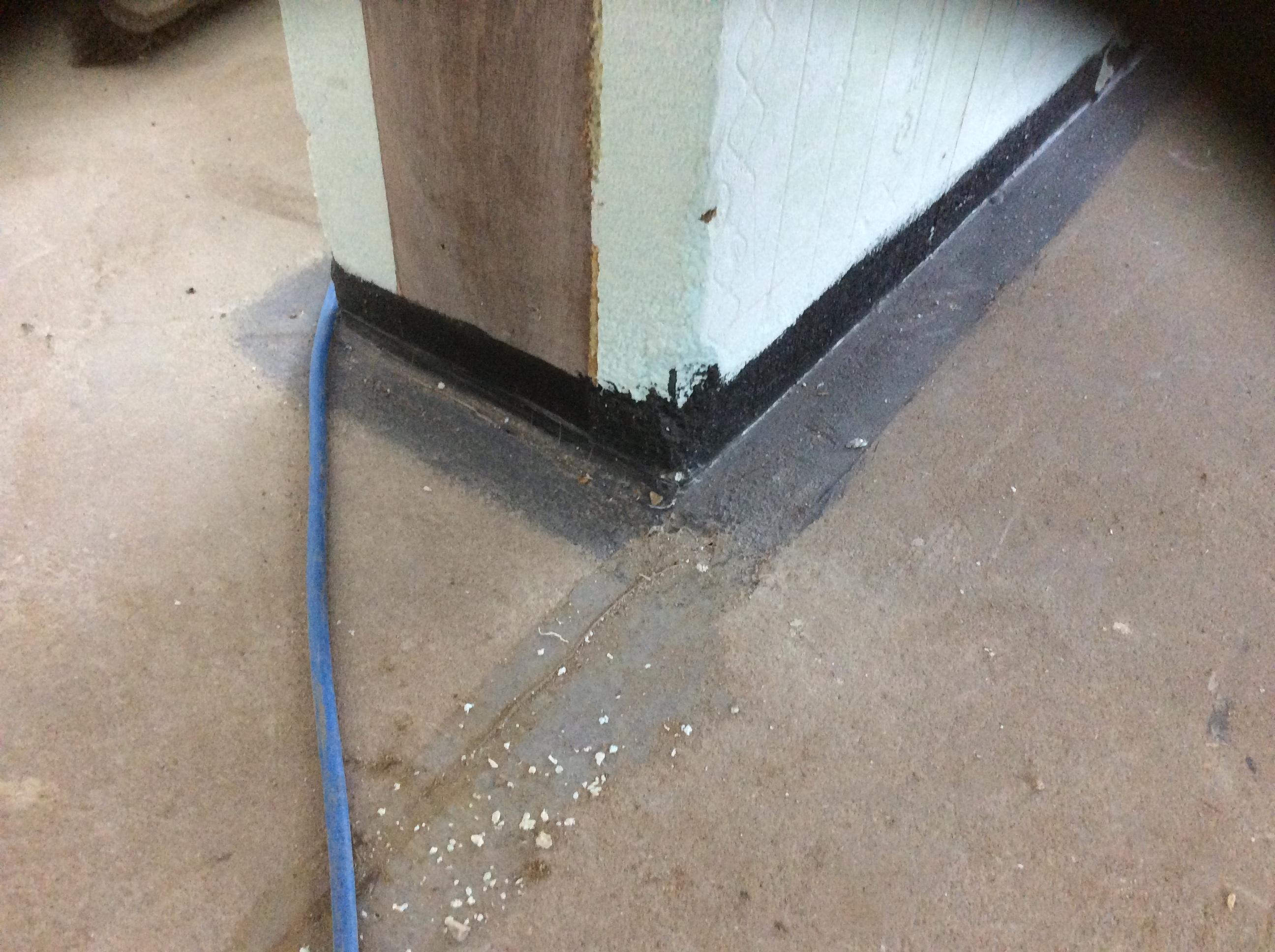

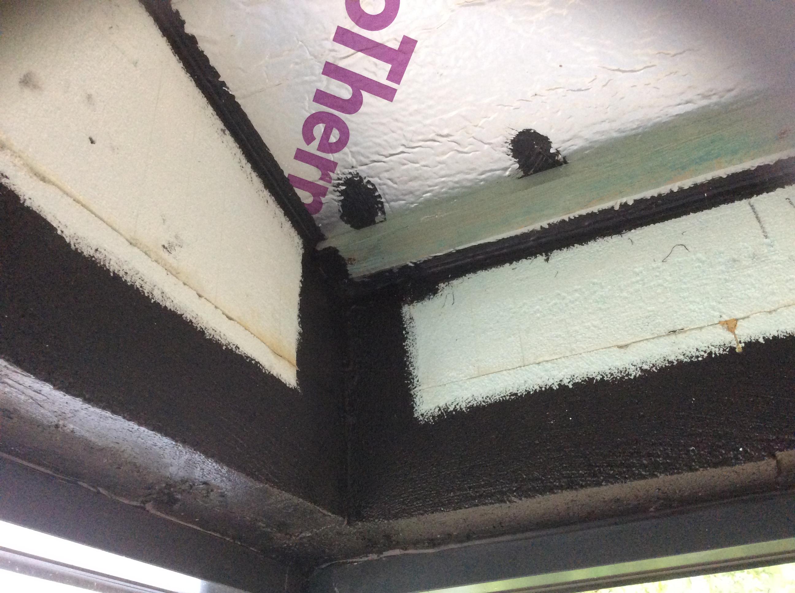

Russell griffiths Posted June 28, 2021 Posted June 28, 2021 I went a bit ott with mine but I got a good airtest the other day. Every gap and joint squirted with some form of sealant and then painted over with an airtight paint. 3 1
MortarThePoint Posted June 28, 2021 Author Posted June 28, 2021 9 minutes ago, Russell griffiths said: I went a bit ott with mine but I got a good airtest the other day. Every gap and joint squirted with some form of sealant and then painted over with an airtight paint. Looks comprehensive. What was the airtight paint you used?
Russell griffiths Posted June 28, 2021 Posted June 28, 2021 5 hours ago, MortarThePoint said: Looks comprehensive. What was the airtight paint you used? Various, I had a 25 ltr tin of gas tight paint left over so I used two coats of that, also blower proof paint.
