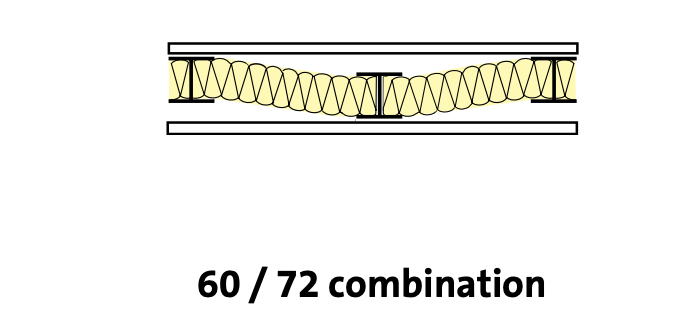

Adsibob Posted June 17, 2021 Posted June 17, 2021 On 16/06/2021 at 22:19, willbish said: Ditto. That was my reason for going all metal. 70mm track, 50mm staggered I studs. 15mm soundbloc both sides. Ply lined for landing cupboards and walk in wardrobes. Sorry to ask a really stupid question, but how do you make a 70mm track work with a 50mm I-stud? Shouldn't the track be only slightly wider than the stud, as suggested here: https://www.buildingmaterials.co.uk/50mm-i-stud-section-2700mm?mh_keyword=&utm_term=&utm_campaign=[LocationSet2]SmartShopping|PlasterboardAccessories&gclid=Cj0KCQjw5auGBhDEARIsAFyNm9EAKd--KgIIKas0jHqQ8TTmb7ouZ4-IfgiSRIyONWcfaih8m1Idz2oaAoy6EALw_wcB You can tell I've never installed a stud wall (metal or wood) before can't you!
nod Posted June 18, 2021 Posted June 18, 2021 9 hours ago, MortarThePoint said: Is that because there isn't a moisture resistant Habito? It’s mainly due to the amount of fixings Dryers handrails stalls etc Habito is very resistant to moister
Dreadnaught Posted June 18, 2021 Posted June 18, 2021 7 hours ago, Adsibob said: but how do you make a 70mm track work with a 50mm I-stud This is 60/72 but you get the idea… 1
Adsibob Posted June 18, 2021 Posted June 18, 2021 11 minutes ago, nod said: You can get a 52 mil track or use clips and a 72 Presumably @Dreadnaught’s suggestion improves sound isolation by ensuring there is nothing joining either side of the wall? 1

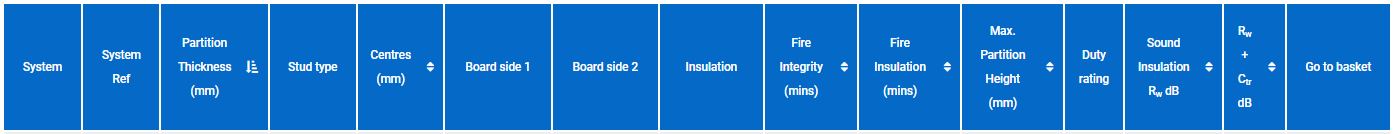

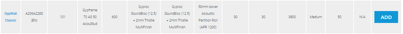

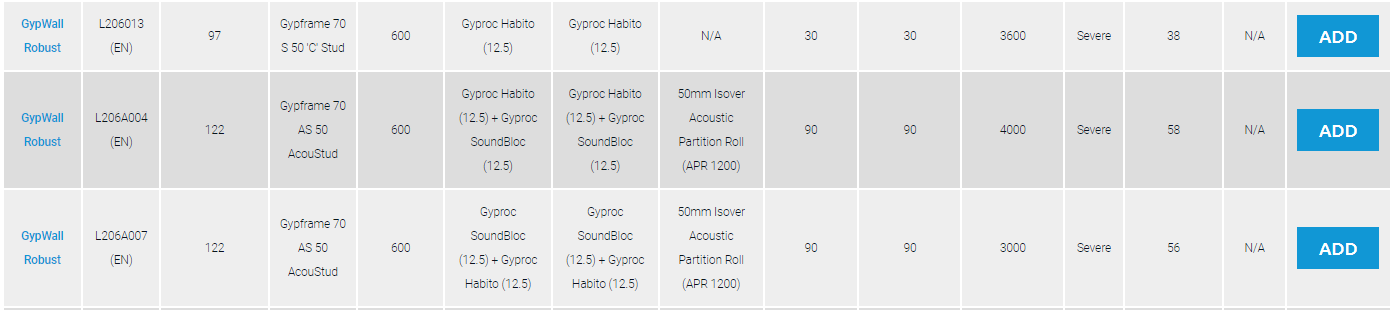

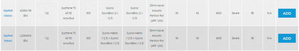

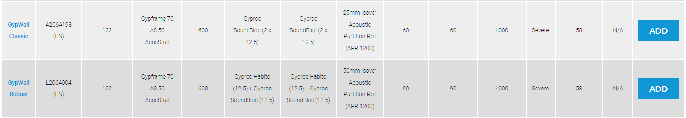

MortarThePoint Posted September 2, 2021 Author Posted September 2, 2021 I've been getting my head around Partition duty and I think I'll be happy as long as it is Severe duty in certain places. BG Habito is expensive (£20) and only available to me in Pallet quantities (38 @ 2.7m). It's good stuff though and the BG System Selector says a sheet of Habito either side of a 70 S 50 C-Stud is Severe duty rating with Sound Insulation of 38dB. That's with no insulation and they don't give a value with insulation. However, I can deduce from page C04.S02.P04 of the White Book that adding 25mm of acoustic insulation adds 6dB, so would make that combination 44dB. Given the incremental cost, I think I'll go with the Acoustud and SoundBloc upgrades which give Severe duty and 58dB sound insulation, the same as insulation + 2x SoundBloc each side. That gives me some combinations that all have 58dB: Habito + Soundbloc both sides £65/lm Habito + SoundBloc one side, 2x SoundBloc the other side £57/lm 2x SoundBloc both sides £49/lm In less sound and duty sensitive locations, I can go single skin with 50dB: Habito both sides £47/lm Habito one side, SoundBloc the other side £39/lm SoundBloc both sides £31/lm Future proofing with Habito is going to cost me a fair bit, but not as much as if I was to put Plywood or OSB in at their current prices. I may end up with some Habito sheets left over though. I can do this as I don't have many metres of partition to address. For reference, a 40dB 70 S 50 wall (with insulation) would be around about £18/lm I think. On this, SoundBloc each side adds about £8/lm and the Acoustud adds about £5/lm. I don't have any fire requirements above 30 minutes. 1 1
