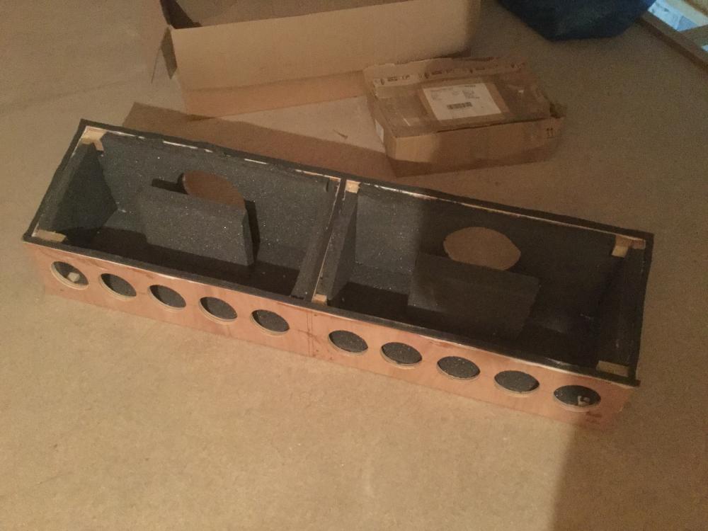

joe90 Posted March 9, 2017 Share Posted March 9, 2017 I am starting to design my MVHR system and will use the radial system. I am finding some of the components quite pricey ( manifolds) I know they have o rings and clips but I do wonder if these can be home made?. Jeremy made his own silencers and I wonder how difficult a manifold could be. I also like being able to adjust the flow at the manifold rather than at the terminal to keep noise to a minimum at the terminal. Can anyone point me at other suppliers that are reasonably priced? Any other info on DIY MVHR gratefully received. Link to comment Share on other sites More sharing options...
MikeSharp01 Posted March 9, 2017 Share Posted March 9, 2017 Make your own manifold - what a great idea Joe, you could make an MDF box and cut THESE in half and glue them into suitable holes to make the flexible duct connections. Spend some time saving money and you get exact the number of outlets you need. 1 Link to comment Share on other sites More sharing options...
joe90 Posted March 9, 2017 Author Share Posted March 9, 2017 Way to go Mike, at £2.40 each that's £1.20 per connection ( plus a bit of mdf leftover from making something else.) just need to work out how to restrict the flow at the manifold. ( Jeremy talked about knockouts but I have not seen them for sale). There seems to be a big difference in price for what looks like similar pipe, the airflex is over twice the price of BPC,S quietvent pipe of the same size!!! Is there any need for both silencers and manifolds, can't a manifold be a little larger and contain sound absorbing foam?, saves making more mdf boxes and more pipe connections? Next is the plenum and terminals, at £24 ish each and I need 9. my motto has always been " why buy something when you can make it?" ( and that includes a house ?) Link to comment Share on other sites More sharing options...

Jeremy Harris Posted March 10, 2017 Share Posted March 10, 2017 I can't see any reason why the silencer and manifold can't be the same box, if you can make room for a combined unit. One of my home-made silencers (the one that's almost hidden from view) is an MDF box sat directly on to the 150mm stub that comes out of the manifold. The flow adjustment discs fit to the HB+ manifold connections, and are secured in place by the quarter turn locking ring, so it would be challenging to get them to fit. Link to comment Share on other sites More sharing options...

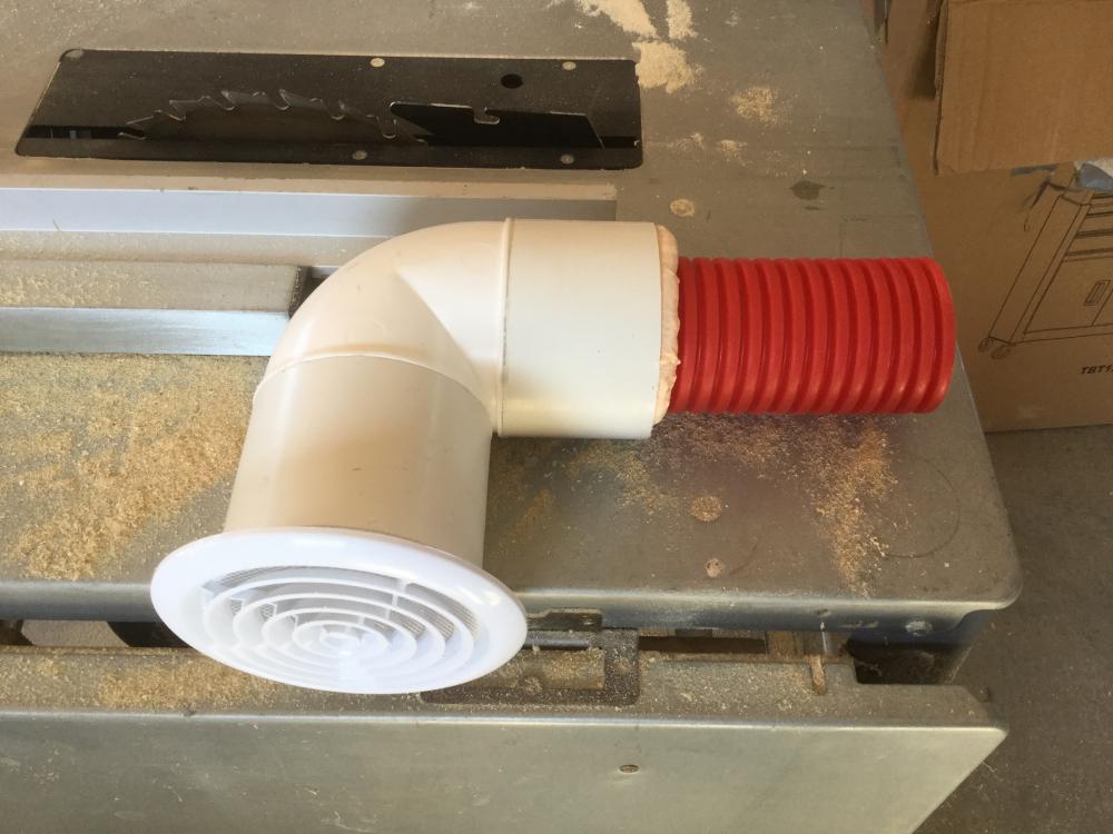

joe90 Posted May 12, 2017 Author Share Posted May 12, 2017 raising this thread again as I am about to order my MVHR duct and bits, BPC quiet vent duct appear the cheapest, I am going to make my own silencer and manifold. The plenum and valves are expensive , I can get metal ceiling valves at £3.60 each ( I don't need the adjustable ones as I plan to balance the system at the manifold, and pipe reducers about a couple of quid and don't need a 90' bend as the pipe will bend that much. If it works this will save in the region of £200. Am I just tight fisted ?????? Link to comment Share on other sites More sharing options...

joe90 Posted May 12, 2017 Author Share Posted May 12, 2017 Thanks guys, yes I do have a lot to do but I am retired so I don't have to balance site with a job. The only thing I don't like about the BPC type plenums is they are fixed before plasterboarding so fitting the boards around the pipe sticking out from the ceiling could be a fag, I would prefer to have a flexible connection above the plasterboard and cut up into it after the plasterboard was fixed. Link to comment Share on other sites More sharing options...
Bitpipe Posted May 12, 2017 Share Posted May 12, 2017 17 minutes ago, joe90 said: Thanks guys, yes I do have a lot to do but I am retired so I don't have to balance site with a job. The only thing I don't like about the BPC type plenums is they are fixed before plasterboarding so fitting the boards around the pipe sticking out from the ceiling could be a fag, I would prefer to have a flexible connection above the plasterboard and cut up into it after the plasterboard was fixed. We fitted them before plastering and I trimmed them with a multitool after skimming. Probably should have trimmed after boarding and before skimming to enable the plasterer to get a perfectly neat finish. Anyway, it really doesn't matter as the ceiling fitting overlaps by a good inch or so and covers up any imperfections. Link to comment Share on other sites More sharing options...
Stones Posted May 12, 2017 Share Posted May 12, 2017 I laid all the ductwork and positioned the individual plenums prior to plasterboarding. The joiners sheeted the ceilings then I simply cut out the holes for the plenum to go through, cutting each plenum to the correct length for a flush finish. The only plenums that the joiners fitted the plasterboard around were those in the vaulted ceiling where there was no subsequent access available. As they had to measure and pre-cut boards anyway, it wasn't much additional work to measure and cut out the hole for the plenum which I had previously cut down and fixed in place. Link to comment Share on other sites More sharing options...
