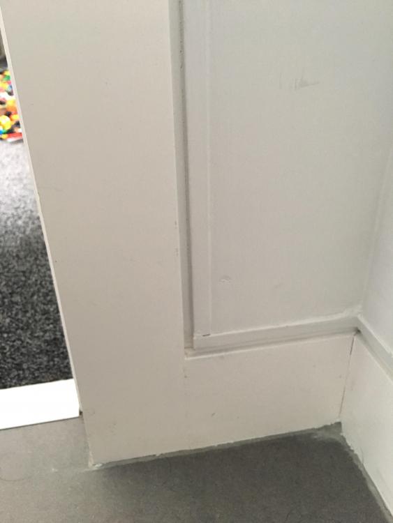

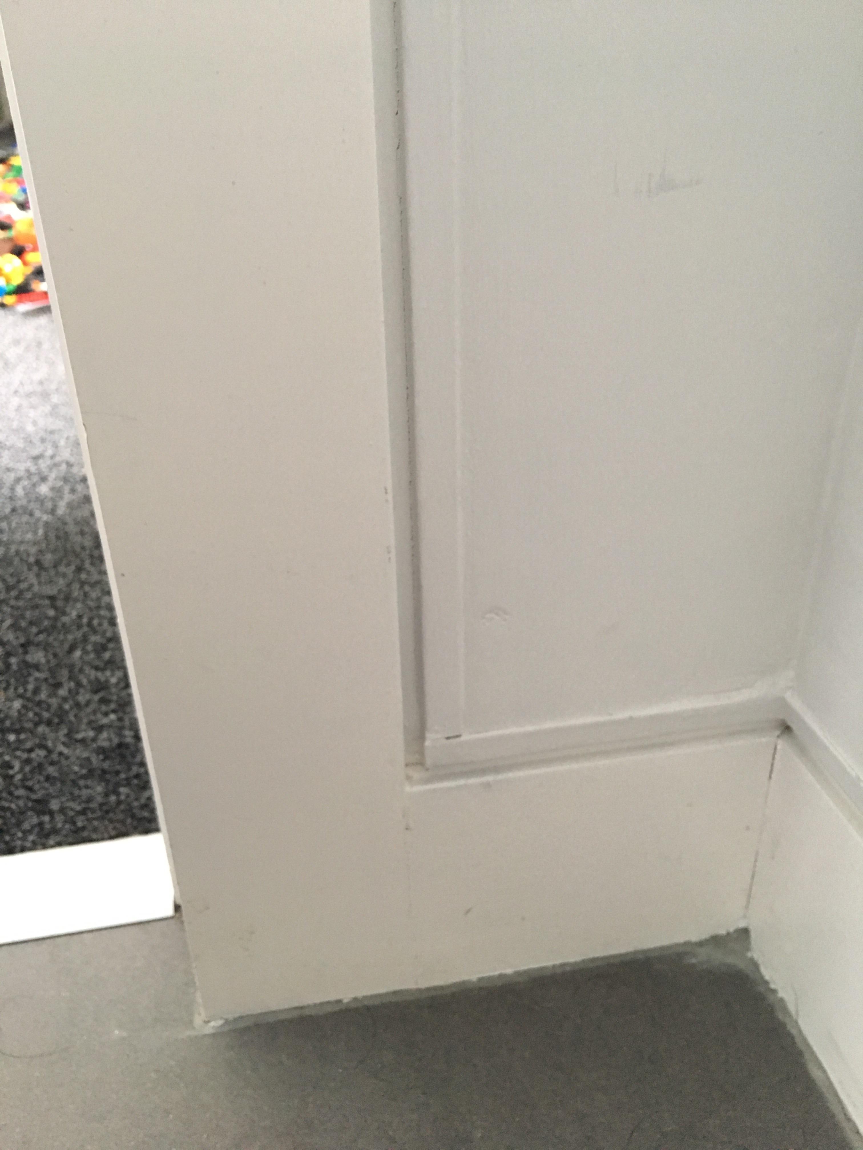

looks good. Is your architrave flush with a shadow gap?

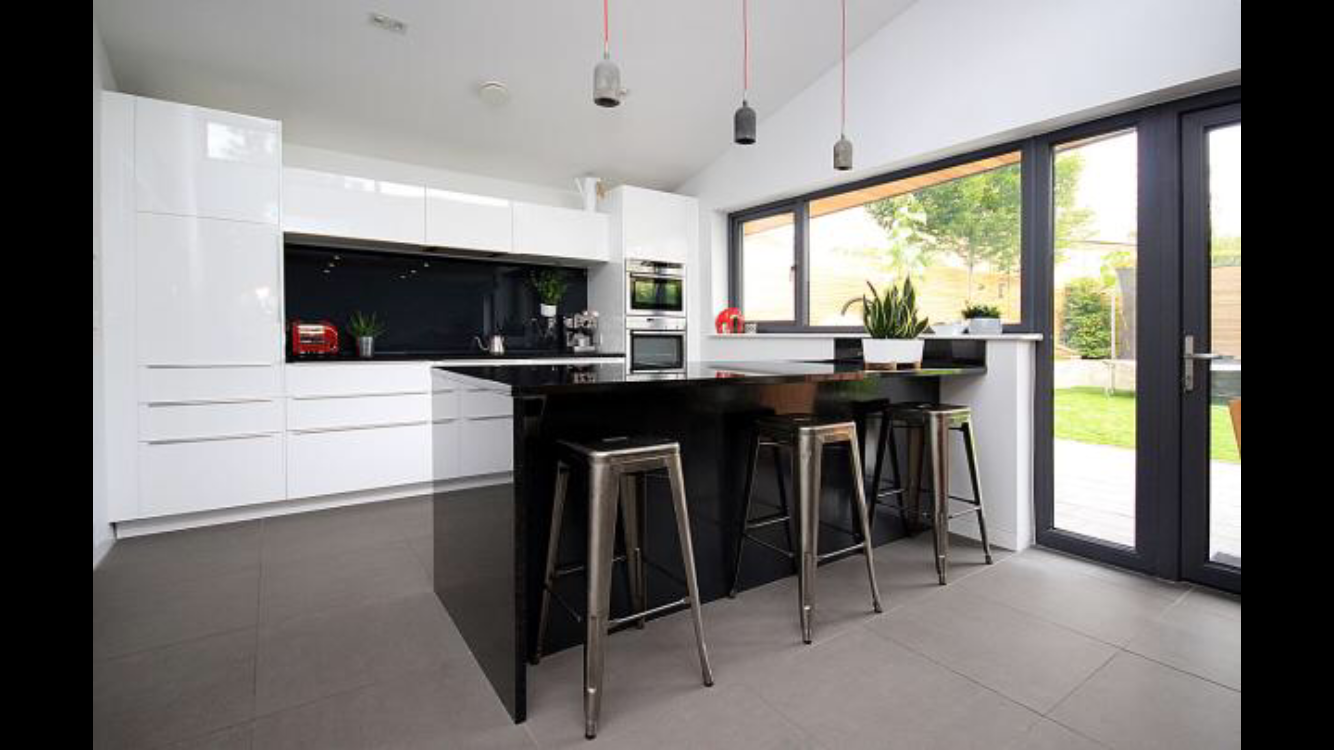

Looks fab! Especially like the kitchen/living space with the different ceiling heights dividing the space up.

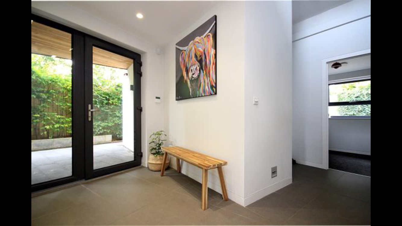

Can I ask who the artist is of the Highland Cow in the Entrance hall. We're in the process of trying to commission something similar of a Shorthorn for our converted cow-shed.
Edited by IanR
Looks like a Steven Brown print/original https://www.stevenbrownart.co.uk/
There are a few that do that sort of thing, I have three by James Bartholomew http://www.jamesbartholomew.co.uk/prints/cow-prints.html
We've had a few emails back-and-forth with JB, he's our favourite at the moment. Thanks for the Steven Brown link.

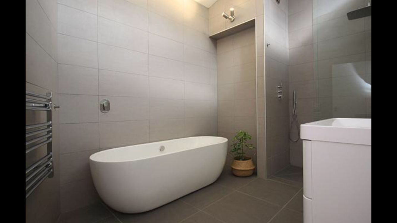

In your bathroom, where are the bath taps? (asks Debbie)
Wall mounted control valve (above left of bath) and a bath filler (i.e. fills from the overflow).
Well thats my guess :)
Spot on!!  I couldn't find a bath tap that I like (and would risk giving the kids a head injury when they play in the bath) so got an overflow filler.  I think it looks nicer with out the taps - but then I like the minimal look.

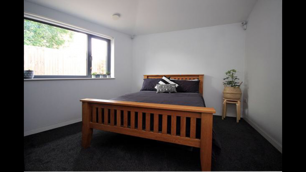

Yes and the skirting as well here is a closer photo, not 100% happy, but part of issue was not having a skim coat on the plasterboard, something that looking back I just should have done

Yeh would a skim of bought it flush with that bead? Does look good from a distance, not so sure about 100mm away!
