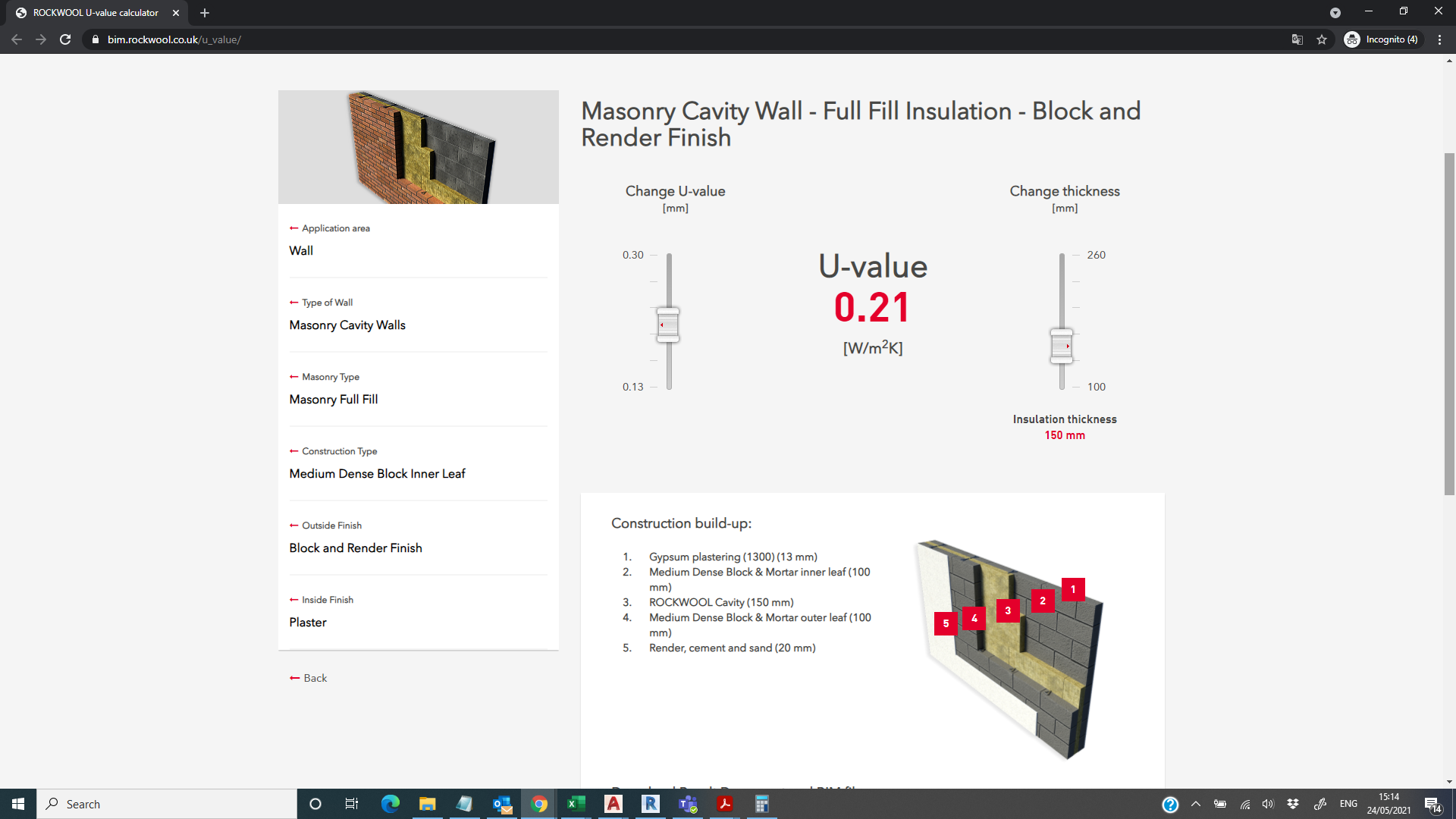

@PeterW & @Dudda
It will mainly be K-Render, 100mm 3.6n Outer block, 150mm full fill Dritherm32 and then 3.6n aircrete type inner block, slurry coated with dot and full width dabs, socket cavities sealed etc. Very similar to what you have posted Dudda.
The ties I was looking at are the Ancon BF2 that show a 0.7 W/m2K rating but I don't really know 0.14 difference is worth having. I'm guessing that as that is a Watts per meter squared (and the total area of these ties must be significantly less that that) that it would be a total waste of £1900 extra? Is that right?
