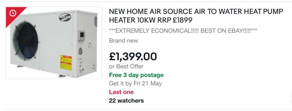

binary Posted May 18, 2021 Share Posted May 18, 2021 Hi This may help, if you install yourself you may be best with a monobloc version air to water heating and cooling .pdf Link to comment Share on other sites More sharing options...

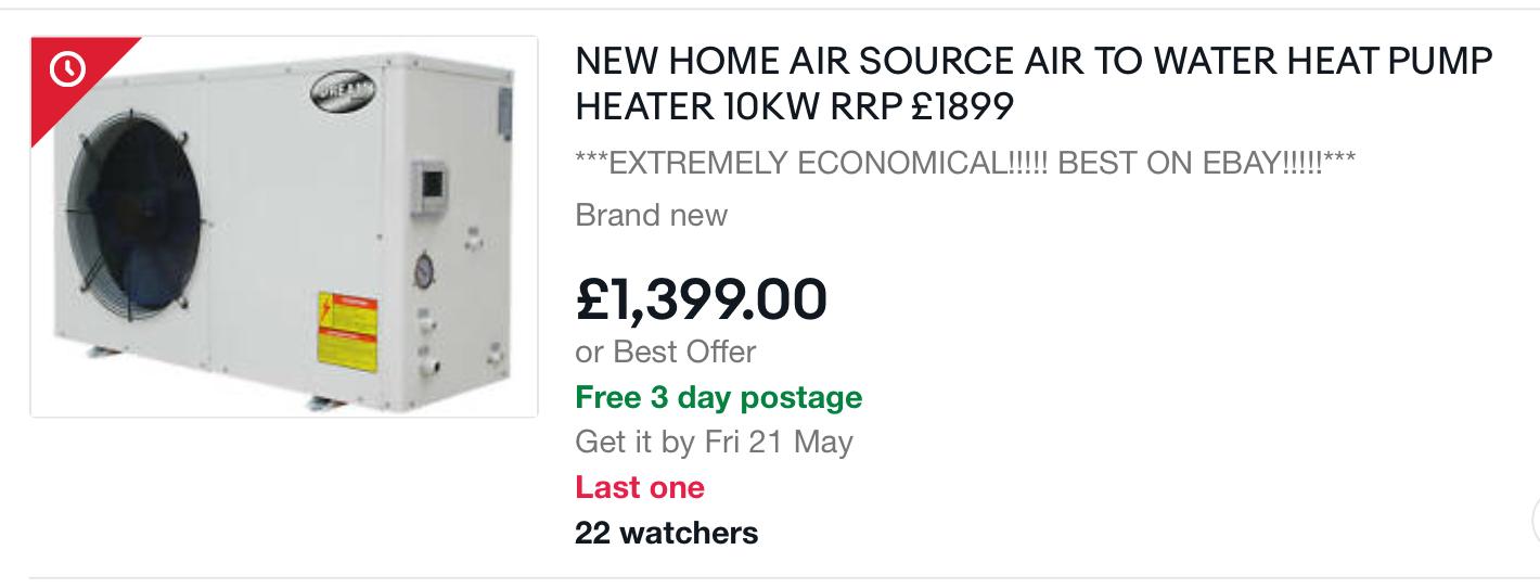

Bonner Posted May 18, 2021 Share Posted May 18, 2021 1 hour ago, binary said: Hi This may help, if you install yourself you may be best with a monobloc version air to water heating and cooling .pdf 138.38 kB · 8 downloads Looks very similar to these on eBay, with health mark up! Link to comment Share on other sites More sharing options...

binary Posted May 18, 2021 Share Posted May 18, 2021 Just a note on the heat pump information i included: the cost of the heat pump can be reduce if you are willing to locate a different delivery option the cost is also in US dollar so your pound will go further, as for Monobloc version you won't need a engineer to install under Part F gas as this type of unit is an enclosed unit different to a split version which needs gas charging Link to comment Share on other sites More sharing options...
