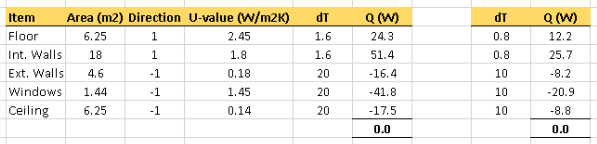

SteamyTea Posted April 7, 2021 Posted April 7, 2021 Part of the reason for having a warm floor in a bathroom is to speed up drying. It takes 2257 J/g to vaporise water.
