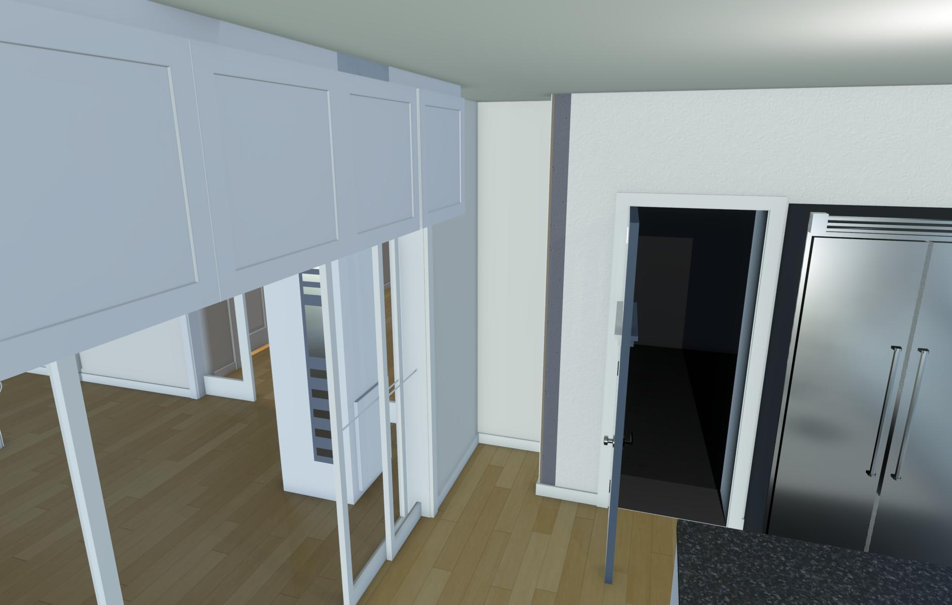

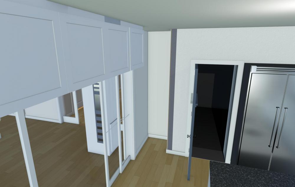

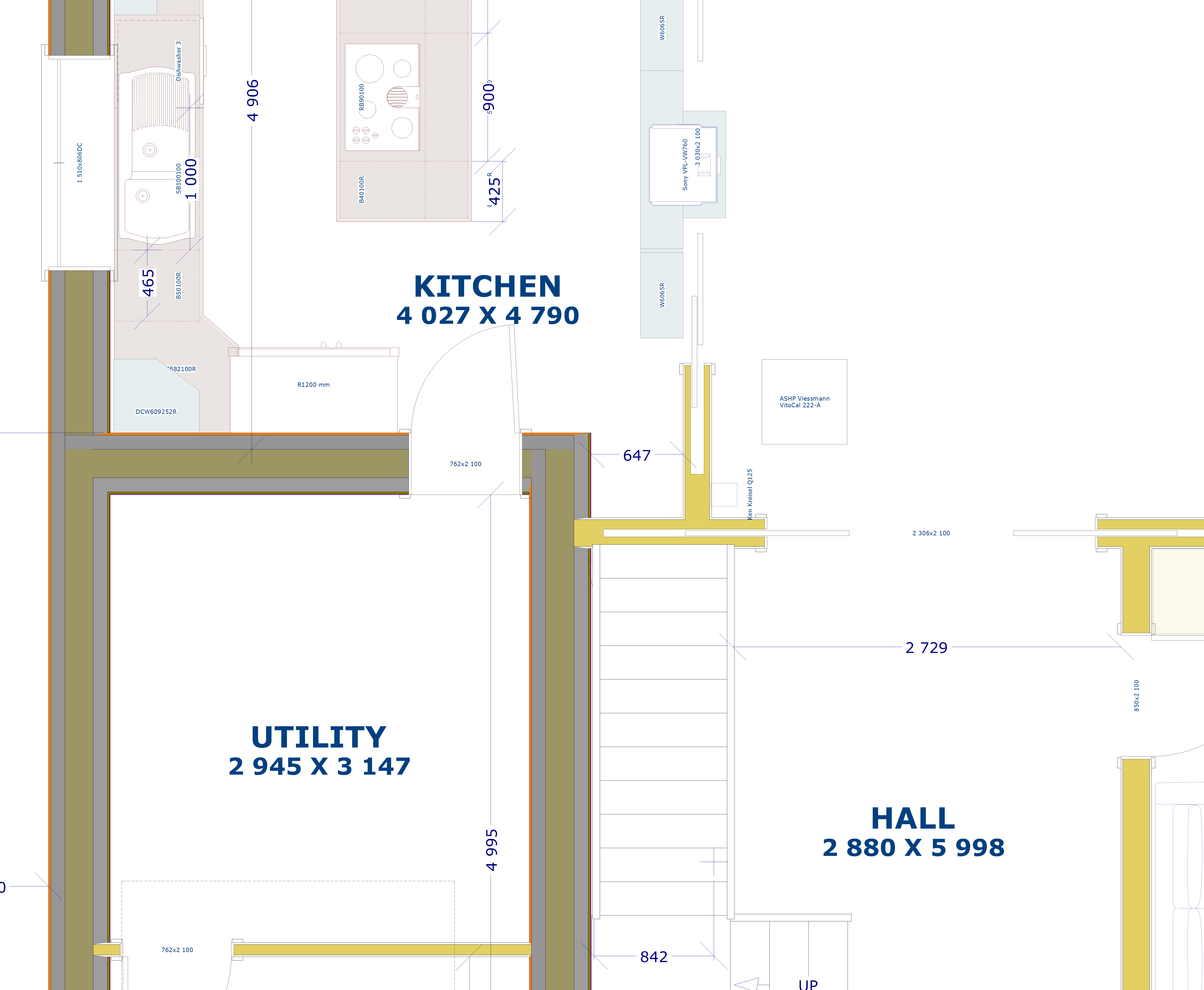

Suggestions for a weird corner?
Take a look at the attached image, in particular the weird kitchen corner, which is 647x600. What "clever" thing shall I do with this corner, and where to store the ASHP
A bunch of notes
- The viesmann 222 ASHP temporarily put in the middle of the room is 60x60, and could actually fit in that corner but then suddenly you can't put any cupboard in front of it
- Also, there's a walkway above that spot, so I guess pipes would have to go up-and-over the pocket door into the stair cupboard

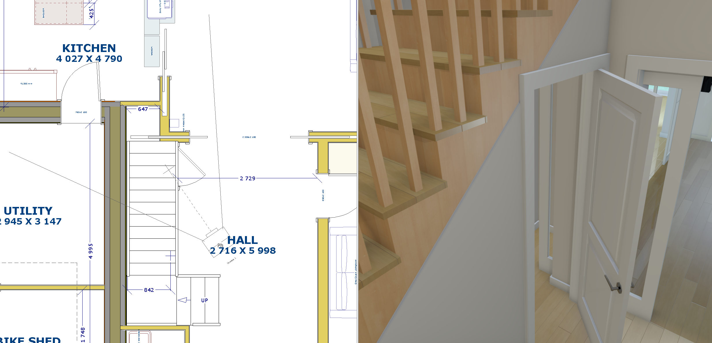

- The ASHP could fit in that stairs cupboard perhaps?
- The door (to utility) can be anywhere.
- Utility ideally should remain empty (since we could make a garage out of it, it has sort-of sufficient size, 5x3)
My ideal solution is to have some type of cabinet that conceals the ashp, but leaves it accessible for maintenance, but perhaps a 1200mm deep cabinet exists?

Put the ASHP indoor unit (basically, a pre-plumbed cylinder for anyone else unsure) in that space, build a service door in front to square out the room, then park your desert and wine hostess trolley in front.
Check if the cylinder has any pipe connections on the sides or back, as they'll be hard to install. In fact, check with the manufacturer how small a nook they advise it is can be installed in
The pipes to the outdoor unit can be run underground, under the slab. Where is the UFH manifold going? Are you using a manifold for DHW supply, and need secondary return? That stuff all takes space, but maybe can go under the stairs

I'm not sure if it matters but that 3d image doesn't match the plan, Its got your big fridge set into a wall.
I'd have the door open the otherway into the utility, in that corner a tall glass fronted fridge or a cupboard.
Or a vertical fishtank with some little jellyfish??
About the right size to store a surfboard and hang up the wetsuit to dry.

I would close off that awkward corner and incorporate it as part of the under stair cupboard with a clever arrangement that you can access it when the pocket doors are slid into the room.
Nah it's perhaps an unfortunate angle but the side of the fridge is dark, it's not inset.
It would impact a car though :/
Hmm something semi-movable (like a fridge) might indeed work there, so it can be rolled out of the way if access to the ASHP is needed..
Very interesting idea... this might actually fix quite a few things. If anything, nothing stopping us from putting the ASHP where we previously discussed, and indeed have it accessible if the pocket doors are closed..  Might have to ponder this option deeper..
Why do you need full access? You need sufficient access for the G3 inspection, but that's about it - the cylinder itself should last for decades.

I suppose one key question for me is primarily where to store the "gubbins" - things like manifolds for UFH and MVHR, and the actual cylinder. I always assumed:
- Connecting the ASHP 'warm water line' very close to the actual monobloc will be important (long lines seem harder, both for insulation and just transport reasons)
- Connecting the cylinder close to that connection seems like a good idea.
- Same for UFH manifolds.
So, that location was pretty much the optimal place. But would it perhaps be almost as good to have the UFH manifolds be there, but the hot water storage in the loft? I'm sure it will require more pipework but will it be "systematically worse" or just takes a bit more effort by the M&E guys?
I started off allocating a "plant room"
I then decided the plant room was the most daft place to put the hot water cylinder as it was a long way from the taps, particularly the kitchen.  So the HW cylinder went in an airing cupboard crated in the corner of the small bedroom putting it close to the kitchen, bathrooms and utility room.
UFH manifolds are in the utility room downstairs and in a partitioned off bit of the eaves wall in the en-suite. Again central for pipework connecting to them.
That just leaves the MVHR and it's manifolds and some heating controls and a pump in the largely empty "plant room" that is now a store room and has my electrical work bench in it.
