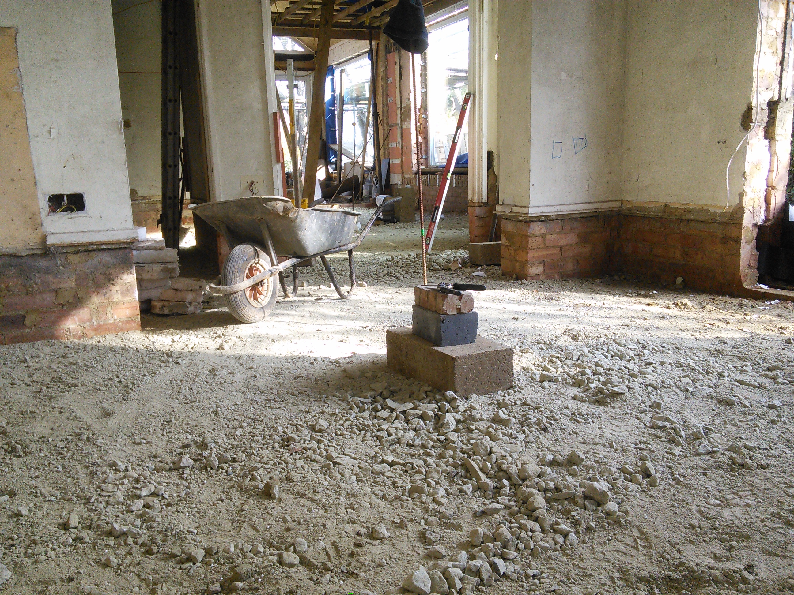

Onoff Posted February 21, 2017 Share Posted February 21, 2017 (edited) 8 hours ago, oranjeboom said: @Onoff Yes, I've covered your updates with interest over the past 12months or so. You should have popped round for some hardcore levelling as I read you'd been round to @PeterStarck the other day! Could have used your expertise levelling 90sqm. I totally forgot you were down that way! Dug by hand have you? Gives a certain satisfaction I found and cheaper than the gym! The photo is on the lines of what I'll do when I knock through the lounge / diner. I want level ceiling, floors and walls running through and at the mo absolutely nothing's in line/level from one room to the other. A scary thought I had.....if you remove a concrete floor (s) like we have then DID the original concrete floor provide a certain lateral "stiction" holding the walls in place? It's not like traditional houses have ring beams. Be interested how you go about the EWI assuming you've traditional footings that "step out" from the external wall line. Edited February 21, 2017 by Onoff "Be interested... Link to comment Share on other sites More sharing options...

oranjeboom Posted February 22, 2017 Author Share Posted February 22, 2017 On 2/21/2017 at 06:19, Onoff said: I totally forgot you were down that way! Dug by hand have you? Gives a certain satisfaction I found and cheaper than the gym! Cheaper than the gym, but you should see the chiropractor's bills!! On 2/21/2017 at 06:19, Onoff said: A scary thought I had.....if you remove a concrete floor (s) like we have then DID the original concrete floor provide a certain lateral "stiction" holding the walls in place? It's not like traditional houses have ring beams. Be interested how you go about the EWI assuming you've traditional footings that "step out" from the external wall line. Walls have all held in place - no movement that I can tell. They do all go down to the traditional footings that I have. Only problem I had was where the old WC room had one wall sitting on the slab only - not any footings at all. So have decided to leave that small room as is. It was only going to be a cloakroom for boots, jackets etc and possibly a manifold for UFH (which I will have to have elsewhere now). Perhaps a wine room now that it will not have UFH and also a lower temp than anywhere else in house! As for EWI, yes EPS all the way down to the top of the footings (still have to decide whether I leave a gap along the DPC) and how I protect the EPS below ground from future gardening spades and possibly rats/mice. I'll probably create a french drain of some kind and then also use pavers BGL. Most likely be an autumn job so time to think about that one. On 2/21/2017 at 08:22, JSHarris said: Investing in good insulation under UFH, especially in a refurb, is going to be money well spent in my view. Yes, long term best bet. Don't want to be in a position whereby they wife starts plugging in electric fan heaters as the place is leaking heat. Spend big now to save £££ in future years. Shame the price of insulation is creeping up over the past 12months...and more price rises to come I see. Link to comment Share on other sites More sharing options...
