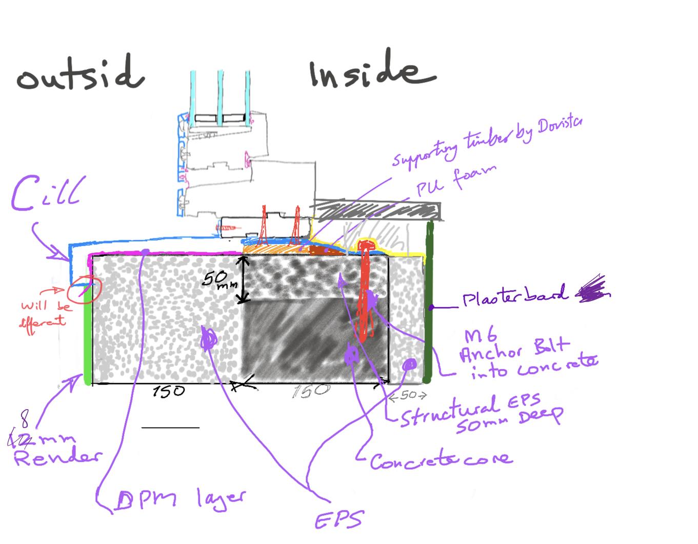

magnethead Posted March 31, 2021 Author Posted March 31, 2021 Cheers @ToughButterCup, sorry about the delay, fitting all my door handles the last few days. I'm in awe at this site, It's provided with me so much useful information, from when I was back throwing drawings together for the council, most of my first floors are poured concrete but a good section is rafters, and a guy suggested dropping them by 40cm which I did, gave me a lot more room on the lower end the Monopitch Roof. Just to spell it out about the Above, in case someone like me comes along here, the DPC should absolutely come out under your sill, then the render guys render up to it, and it's cut clean with the sill after that!! definitely not cut back inside the insulation. I was trying everything to stop this, leak, firing sealant into every little space. I wasted so much time on this. and in the end, this big dirty blob of silicone is what proved the leak was coming in the side of the reveal where it meets the sill

Babak Posted June 27, 2022 Posted June 27, 2022 (edited) Hi I recognise those ICF blocks from TH! I have also used TH on mine. The roofers are almost done (tiling the roof panels installed by the same company) and renderers will come afterwards and then the windows. I know the TH technical manual states you must have the dpc all the way to below the cill and into the EPS at the sides and render and then cut, but my window suppliers have their own ideas and say that is not necessary with (aluminium) cills. But they do insist that rendering must be done first, so they can seal the window frames against the render (I am using aluclad wood by Rationel). Thank you for sharing - looks like I have only a few weeks to do research and make any necessary changes. Edited June 27, 2022 by Babak
Nick Laslett Posted June 28, 2022 Posted June 28, 2022 11 hours ago, Babak said: Hi I recognise those ICF blocks from TH! I have also used TH on mine. The roofers are almost done (tiling the roof panels installed by the same company) and renderers will come afterwards and then the windows. I know the TH technical manual states you must have the dpc all the way to below the cill and into the EPS at the sides and render and then cut, but my window suppliers have their own ideas and say that is not necessary with (aluminium) cills. But they do insist that rendering must be done first, so they can seal the window frames against the render (I am using aluclad wood by Rationel). Thank you for sharing - looks like I have only a few weeks to do research and make any necessary changes. We had the rendering done after the windows were fitted. Our door fitters had the exact opposite view that the render would provide the weather tight seal and be done after the door fitting. They also felt that aluminium cills did not need the same dpc detail as the TH manual. Having the render done first may have a lot of advantages. My inexperience might be showing here, but I actually thought the windows had to be in before you could render, I never even considered that it could be done first. We did the same as Russell with the windows and put down the liquid dpc. We fitted all our windows. We used window straps, Illbruck tape. Drilling holes in TH ICF is tricky due to the depth and because you are drilling blind into 75mm of EPS first and then there is the issue with the embedded rebar. I managed to snap one masonry drill bit as it fused on the rebar. Do you have the check reveal detail on the window openings? The door fitters cut this off for the door install. But I kept them for the windows. The window, cill and check reveal detail is very tricky as indicated by the original posts in this thread. 1

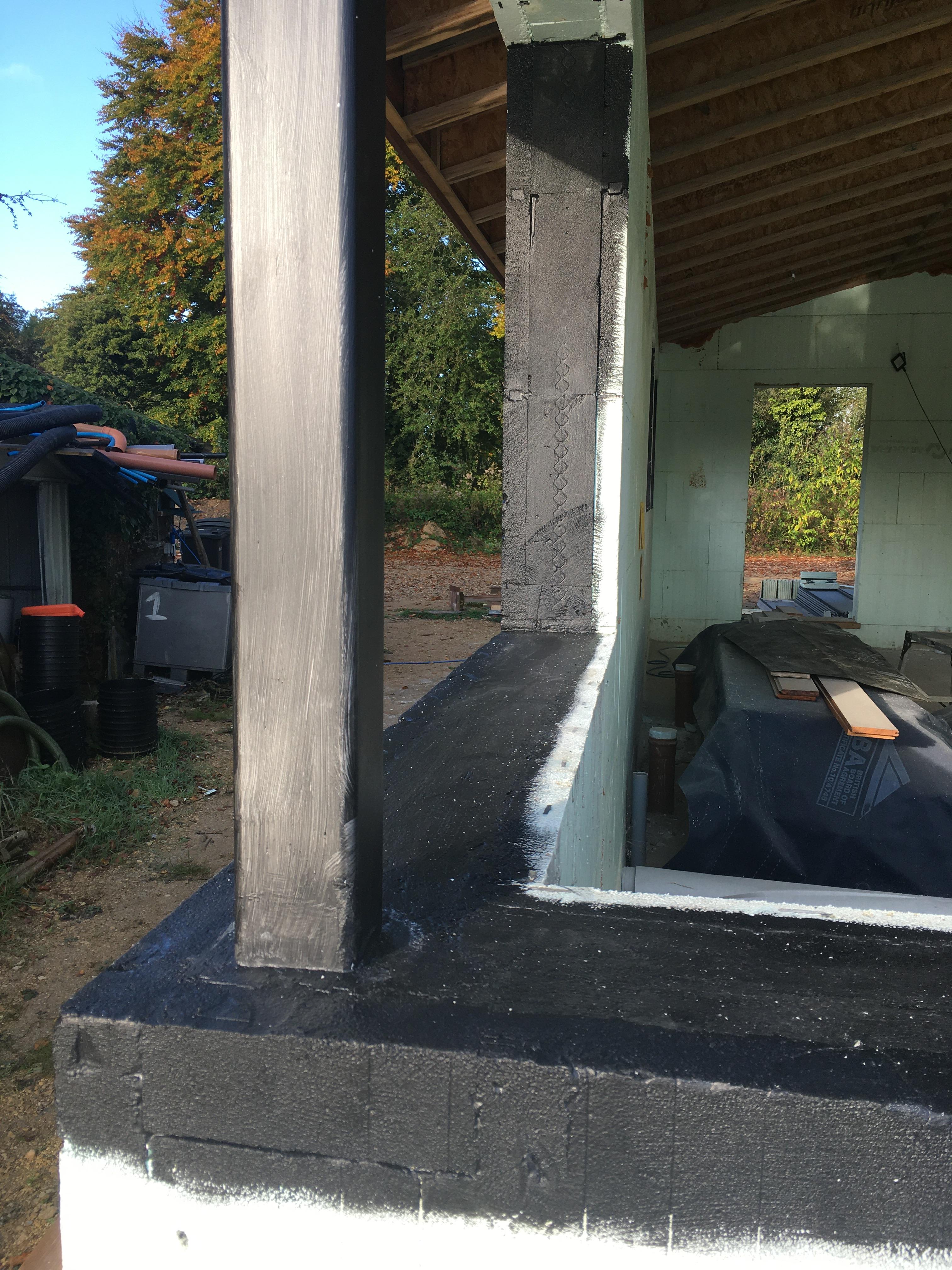

Babak Posted July 9, 2022 Posted July 9, 2022 On 28/06/2022 at 09:34, Nick Laslett said: We had the rendering done after the windows were fitted. Our door fitters had the exact opposite view that the render would provide the weather tight seal and be done after the door fitting. They also felt that aluminium cills did not need the same dpc detail as the TH manual. Having the render done first may have a lot of advantages. My inexperience might be showing here, but I actually thought the windows had to be in before you could render, I never even considered that it could be done first. We did the same as Russell with the windows and put down the liquid dpc. We fitted all our windows. We used window straps, Illbruck tape. Drilling holes in TH ICF is tricky due to the depth and because you are drilling blind into 75mm of EPS first and then there is the issue with the embedded rebar. I managed to snap one masonry drill bit as it fused on the rebar. Do you have the check reveal detail on the window openings? The door fitters cut this off for the door install. But I kept them for the windows. The window, cill and check reveal detail is very tricky as indicated by the original posts in this thread. Yes its odd how different installers (and manufacturers) have such differing ideas about what should be best practice. My Windows and doors (Rationel) are also designed to rest against check reveals which I guess is why they insist on having the render done first - so they can pressure seal against those extra lips on installation. But in my case I had to remove the check reveals that come with TH. At 2.5cm plus the 8mm of render they would have been too wide for the frame to sit against and still have enough frame left between the sash and the external opening. Plus my frames would sit a little further forward so the TH lips would have been in the wrong place. I am a little worried about the DPC. I think the order of things as they will happen in my case will be 1- Render all the way up to the opening maybe slightly lower, 2- put DPC/DPM on reveal base and use CT-1 or similar to seal against the render 3-Fix cill 4 - Install windows. Just keeping my fingers crossed that following Rationel requirements will at provide an installation assurance. The cill will be cut to go round the reveal (like normal installations) rather than into the polystyrene as suggested by TH. But if I am right, the cill was not the problem above, it was the lack of full DPC/DPM all the way below the cill? Not sure if it helps anyone else, but below is a hand drawn detail of how it should work in my case, except for the DPM and cill detail which will be slightly different (credit to my XXX for sharing properly drawn originals from elsewhere!). The cill will not turn back onto the render to close the air gap. What is Illbrook 295? I can find Illbrook, but not the 295. Is it tape or silicone type?
Firsttimer Posted September 5, 2024 Posted September 5, 2024 On 28/06/2022 at 08:57, Russell griffiths said: i did this to all windows and doors. What product did you use @Russell griffiths ?
Russell griffiths Posted September 5, 2024 Posted September 5, 2024 40 minutes ago, Firsttimer said: What product did you use @Russell griffiths ? Triton TT gas and water liquid membrane. 2 1
