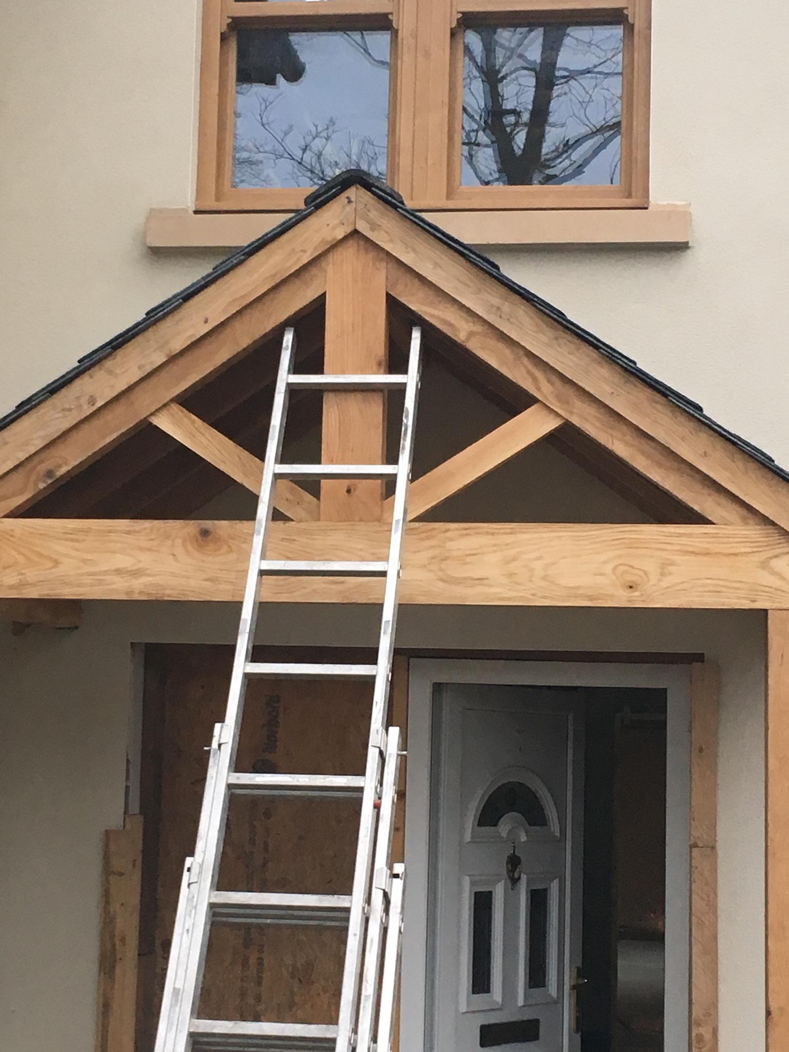

I have fitted a temporary external door today made from a sheet of 12mm osb. Temporary is a relative thing as this door might be the primary entrance door in daily use for a year during the remainder of the build.
The door needs a handle, latch and be lockable from the outside. This simple £11 "Rim Lock" ticks the boxes, is there something more suitable? I have never fitted a door lock before.
https://www.toolstation.com/rim-lock-with-handles/p79578

I had thieves in my place on weds night. They came in through a temporary door blank.
What you have described is totally inadequate if you are intending to keep people out.
My set up was 18mm OSB bolted from the inside. It was a pain in the ass to open and lock each day but I (wrongly) thought it was secure.
On the plus side nothing was damaged in the house and my container wasn't touched.
If you have a locked door people will assume there are goodies inside. Better to leave it open until you have a proper door and keep tools off site.

12mm entrance door is not going to cut it. Thieving scum will get in through anything if they want to.  get either a cheap external door, or a second hand one, and put 12mm ply on either side. Make up a frame from 4 x 2 etc and fit the damn thing properly. Hinge bolts, Two 5 lever locks. One a third from the top, and One a third from the bottom. Think about a cheapish solar alarm, which will come with a couple of pir's and a couple of door contacts. The pir's can be fitted on a couple of planks and rested against the wall, and moved around. Put some alarm stickers around the place, and make sure One is on the front door. None of this will stop somebody who wants to get in, but it will help. One last thing. Make sure that you regularly set the alarm off during the day when the workers are there. Make sure anybody who comes to site knows that the place is alarmed. Early morning delivery. "Won't be a min fella, just got to get the alarm switched off. I am a firm believer that a lot of site nicking is done by somebody who knows somebody. Go to all the nearish neighbours, and tell them the place is alarmed. Give them your phone number, so if it goes off in the night, they can contact you. That way, with a bit of luck, any teenage kids will get to know that the place is alarmed from the parents. Tell the local Old Bill, and ask them to keep an eye on the place when driving by etc. It all helps.

PIR lights are a good plan too - off the building and pointing at it. You trigger them and it lights up the front so you can see.
Also consider fitting any chains or locks at shoulder height. Not only is it easier to unlock yourself, it makes it very hard for a scrote to conceal any cutting equipment and many don’t carry PPE so the thought of using a battery grinder whilst wearing a pair of Glasgow squints, and getting a face full of sparks puts them off.
You’ll find lots of second hand doors too on Facebook marketplace - get one near sized and fit that, you may have to pack it out but it’s a ready made solution - just change the lock barrel first !!

We live onsite and the bedroom of the static caravan is just 7m from the temporary door. My minimum requirements are:
  1. Keep the weather out.
  2. Deter nesting birds particularly when the swallows arrive.
  3. Keep prowling cats out.
  4. Deter opportunistic prowlers by creating a barrier that needs to be forced and splintered.
I could add a bolt top and bottom and padlock those each night.

As you have pointed out, you live on site a few metres away from the house. Why does the door need to be lockable? If its to 'secure' the house then the whole thing isn't up to the job and you need a proper cheapo door. If the door is just to keep things sealed and weatherproof there is no need for the lock?

We just had an old scrap pine interior door, with just a bolt and hasp and staple with padlock on the outside.

My thinking is that criminals vary in their level of planning, determination and risk they are prepared to face.
At one end of the scale there are opportunistic prowlers who will enter an unlocked or open building looking for easy pickings, others are prepared to engage in short duration smash & grab crime and others plan. Most of use will padlock a garden shed.
I think a lockable door that offers 30 seconds resistance against a few kicks is better than nothing though I like @willbish's reverse psychology about the message given by an un protected building.
