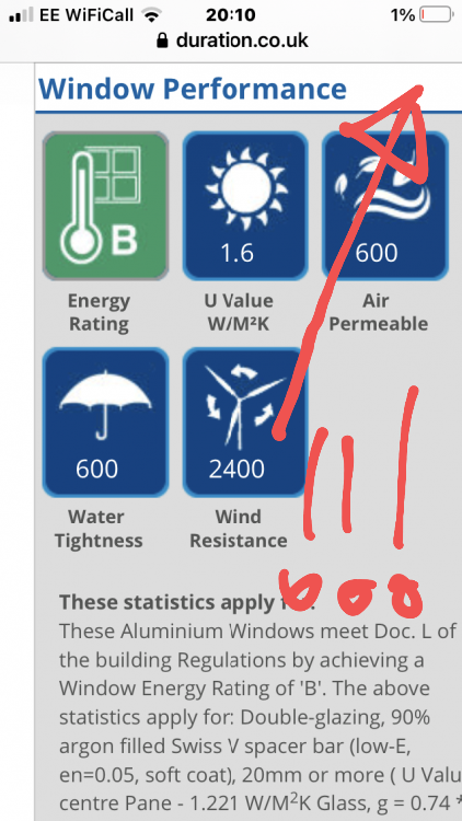

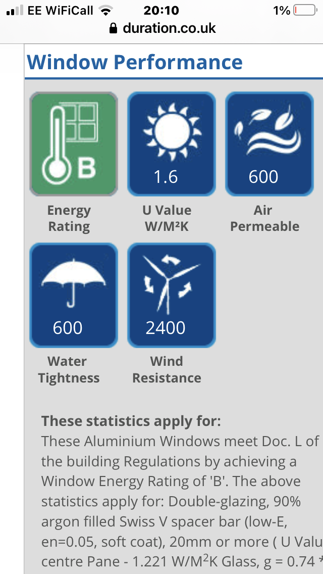

nod Posted March 13, 2021 Author Share Posted March 13, 2021 These are some we considered first time round Aluminum and double glazed If someone could add there numbers as a comparison It would give me a good reference point Link to comment Share on other sites More sharing options...

Oz07 Posted March 14, 2021 Share Posted March 14, 2021 Fack me @nod you love to live dangerously don't you 2 Link to comment Share on other sites More sharing options...
Oz07 Posted March 14, 2021 Share Posted March 14, 2021 7 hours ago, Iceverge said: From my research they're the cheapest, biggest improvement to energy savings shortly followed by airtightness and MVHR. Not being pedantic but wouldn't it depend on glazed area? I always understood airtightness to be the best bang for buck? Link to comment Share on other sites More sharing options...

nod Posted March 14, 2021 Author Share Posted March 14, 2021 3 hours ago, Oz07 said: Fack me @nod you love to live dangerously don't you That amused me also I’ve never seen that rating before Bit worrying to think at a certain part of a storm we could be showered with glass Link to comment Share on other sites More sharing options...
dpmiller Posted March 14, 2021 Share Posted March 14, 2021 your battery's a bit low... 1 1 Link to comment Share on other sites More sharing options...
