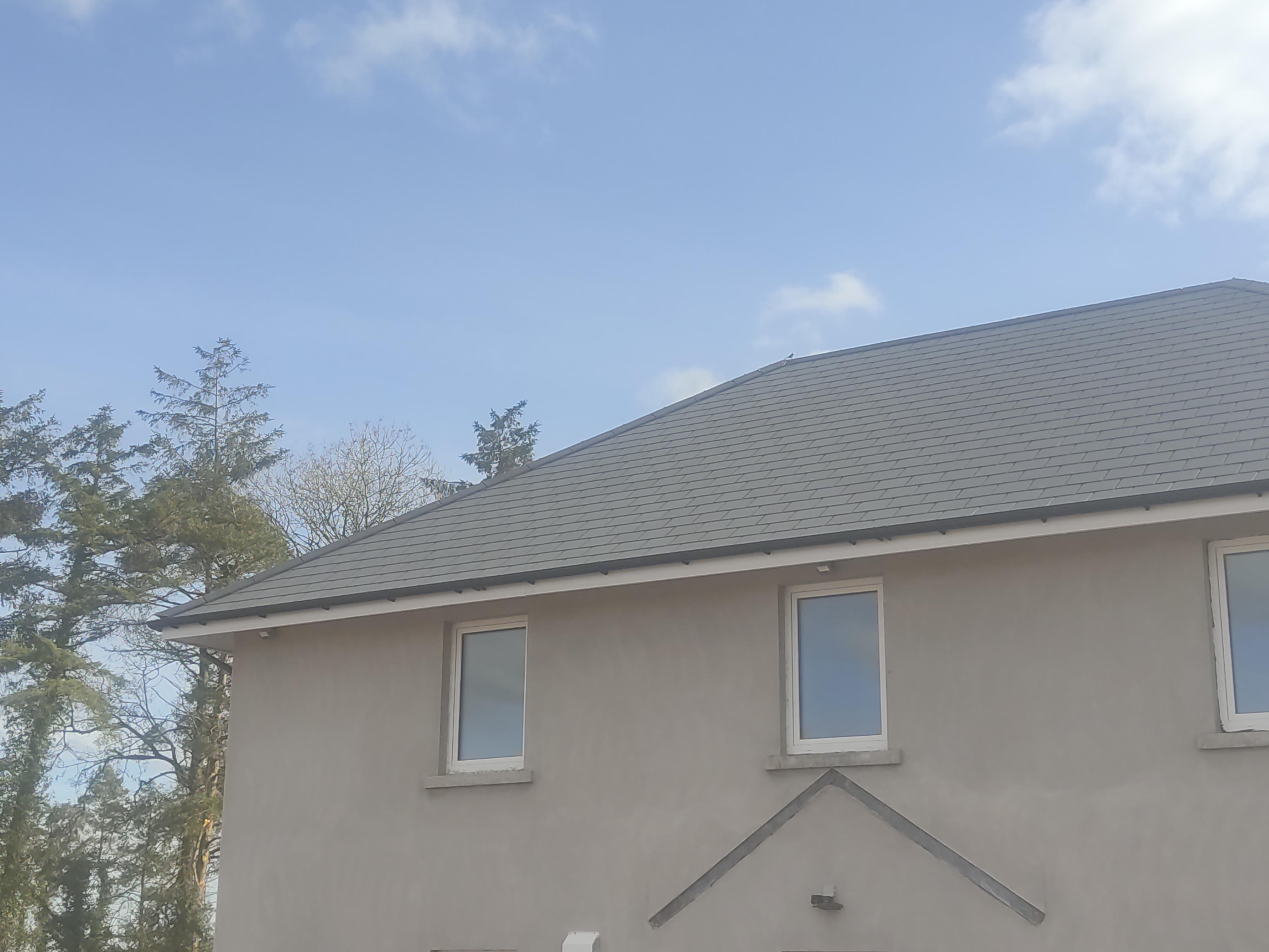

Iceverge Posted March 8, 2021 Posted March 8, 2021 (edited) A bugbear of mine.  We had 98mm rafter truss tails.  Over and over I stressed to keep the fascia slim.  Despite all this the. Roofers and fascia guys went from my 150mm drawings of fascia to 170 to 195 and eventually 225 is what we ended up with. "its the way we always do it m8"  Banging my head against a brick wall.  Keep them as slim as possible is my take for the most elegant look. You can cut an angle from the rafter tails to help too.     Edited March 8, 2021 by Iceverge Add photo
epsilonGreedy Posted March 8, 2021 Author Posted March 8, 2021 23 minutes ago, Iceverge said: A bugbear of mine.  We had 98mm rafter truss tails.  Over and over I stressed to keep the fascia slim...   I am burning a lot of brain cycles on this single detail, one problem is there are few examples locally. As Kevin McCloud would say the local vernacular is barebones eaves, no overhang with guttering hanging off brackets embedded in the facing bricks.  Does your photo show the 225mm end result?  Another benefit of slim fascias is that this will exhibit more of the expensive flat fan arches above the upper window.

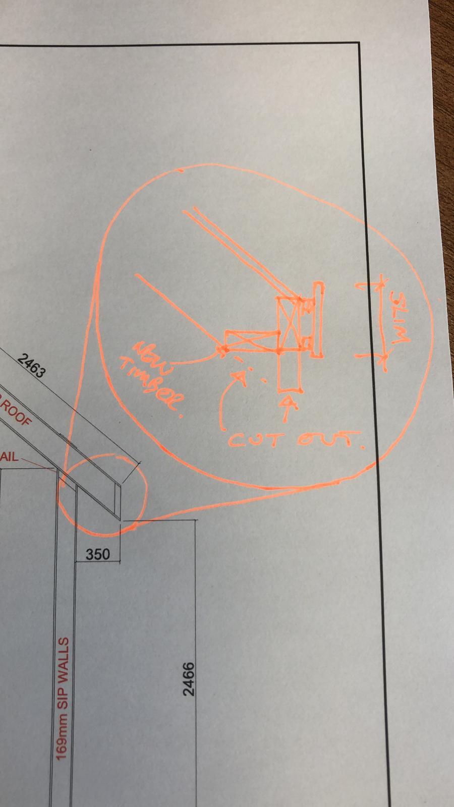

SuperJohnG Posted May 4, 2021 Posted May 4, 2021 (edited) Hmm, I'm doing my fascia detail just now to order stuff in prep for kit going up. Reading this makes me think I've messed up  I had the SIPS kit manufacturer cut the ends of the kit plumb, so I could attached a Fascia directly to it, but it's a 219mm thick roof panel, then I need 25mm counter batten, then 22mm sarking, then it's slates.  Looking here, the plumb cut it 310mm, plus my 25mm and 22mm for sarking and batten, is this going to look ridiculous? How else shoudl I have done it?. I was hoping I could attach fibre cement fascia directly and make life easy.  Edited May 4, 2021 by SuperJohnG
Marvin Posted May 5, 2021 Posted May 5, 2021 Hi Super JohnG. As the over hang is outside the thermal envelope, looking at the problem the only thing I can think of to do, if the fascia is too tall, is to cut part of sloping soffit side horizontal however I'm not sure this wouldn't cause you other problems. Hopefully someone comes up with a better answer.  Good luck. M 1
joe90 Posted May 5, 2021 Posted May 5, 2021 3 hours ago, Marvin said: Hi Super JohnG. As the over hang is outside the thermal envelope, looking at the problem the only thing I can think of to do, if the fascia is too tall, is to cut part of sloping soffit side horizontal however I'm not sure this wouldn't cause you other problems. Hopefully someone comes up with a better answer.  Good luck. M This is a good idea, it would give you a flat surface to fix a soffit too as well.
SuperJohnG Posted May 5, 2021 Posted May 5, 2021 4 hours ago, joe90 said: This is a good idea, it would give you a flat surface to fix a soffit too as well. Make sense, just seems a major pain to do. I'd need to cut it then add a timber and that that is SIPS it's all insualtion.  Architect suggested the below which works. Just an extra step. Also doesn't deal with verges which is impossible really as panels are 219 thick. Â
joe90 Posted May 5, 2021 Posted May 5, 2021 Yes, cut sip to required height by removing the bottom pointy bit, hack out the insulation enough  to put noggins between OSB sides both vertically and horizontal to fix facia and soffit too, you just need to work out what facia height you actually want!
