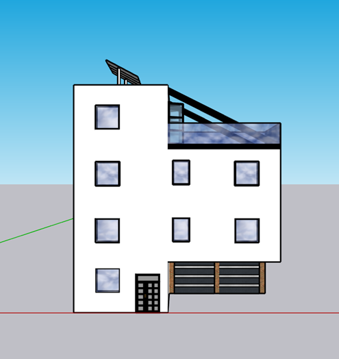

JJD1 Posted March 6, 2021 Posted March 6, 2021 Hi all, I am at the very early stages of planning a self-build. The site is in London and is extremely constrained, which means the design includes a heavy cantilever (image below). The site measures only 11x6m total. At the moment, I am considering a steel frame design (mostly as a result of the need to support the cantilever). I am yet to have a soil survey carried out but know that it is highly likely that there is made ground to approx. 3m, superficial deposits to 7m 3and London clay beyond. Structural engineers are advising CFA piles - if you have other suggestions, please let me know. I'm trying to estimate costs to see if the project is feasible but I'm not sure if I've missed anything? I'd be grateful if those with experience could take a look and give me any feedback please? Some indicative costs have been provided by tradespeople and others are pure guestimates, so would appreciate your thoughts. Thanks. Costs Spreadsheet.xlsx
nod Posted March 6, 2021 Posted March 6, 2021 I would go with steel and block Your obviously trying to keep the cost down I’m in the NW of England and find your costings to low London prices are going to be even higher Bathrooms and kitchen Windows Doors Garage doors can be expensive Kitchen and bathrooms also I would put a support under that corner Cantilever look great but can be expensive Only my take Sorry if it sounds a bit negative
PeterW Posted March 6, 2021 Posted March 6, 2021 (edited) I reckon your costings are about 100% out ... sounds harsh but you have a difficult site and finishing this for less than £1500/m is going to be a really tall order. Piles and steelwork are going to be easily double - what about services such as drainage and water ..? Edited March 7, 2021 by PeterW Typo..!! 1

Conor Posted March 7, 2021 Posted March 7, 2021 (edited) For a normal cantilever building using standard techniques, you want the anchoring wall to be double the length of the cantilever*. You don't have that. I'm not sure this building is constructable without extreme (expensive) structural solutions not normally used in standard residential construction. How much detail has your SE looked at? At a guess, steel framed building with lightweight wall panels (sips) would be the obvious option to minimise the engineering required for the cantilever. What's the constraint that allows to build over land as a cantilever but not put in posts/supports? A couple conctrete columns would knock several tens of thousands off the build cost. * I am not a structural engineer, just a lowly environmental engineer ? Edited March 7, 2021 by Conor
Ronan 1 Posted March 7, 2021 Posted March 7, 2021 (edited) I agree with Conor above, that looks to be almost unconstructable without some support and I'd imagine it will add a 6 figure sum to your building cost if it is. If you can get a few columns under it it would be a while different story and a completely different build. Best of luck with it though. Edited March 7, 2021 by Ronan 1 Because i cant spell and bloody auto correct is a pain
ProDave Posted March 7, 2021 Posted March 7, 2021 What is actually stopping you having a pillar in that corner? As long as the access is still wide enough? 1
Gus Potter Posted March 9, 2021 Posted March 9, 2021 (edited) On 07/03/2021 at 00:51, PeterW said: Should say costings not coatings although I can’t see how much you’ve got in for that ..! Insulation and that sort of thing will chew £40/m so that could be £7-8k. Your issue with piling isn’t that you “only” need 30 sqm, it’s you need piles to stop the building rotating about its middle wall. You’ve got to basically load the cantilever to keep it from rotating and you’re going to need a huge spine wall to do it. That point load will need a lot support and you’ll need to ensure the building is balanced. All the steels will need to be very big too, wouldn’t surprise me if the structural cost was £60-80k on top of a £50k foundation cost. Then add in the walls, insulation and that could cost you another £30k with scaffold and access etc. @Gus Potter whats your thoughts ..? Feasible ..? Oh Peter you have put me on the spot. Having a look at the section. Structurally big cantilever, more span than available back weight. That bit that is over hanging is much more than the main width of the four storey part. For all, think of it like a swing.. pivoted just to the right of the door. If all the building is the same weight it will probably want to tip over under it's own weight. But.. Peter. Could you Architecturally make the left hand side of the section heavy.. do this in brick / block, make the over hanging cantilever zinc external say.. not masonry.. say on a steel stud work, use a wriggly tin slab on the four storey bit.. you'll need a good floor thickness anyway for fire regs.. now you have ballast for the cantilever... for all, you now add a big weight to the short end of the swing so it won't fall over. It may be that you need to add a good mass to the left wall ( Trombe wall possibilty? ) using masonry..you will need a good bit though. The side elevation looks good.. not too many openings. This leads me to thinking about a simple steel braced frame that fabricators churn out every day.. easy to insulate and get priced up.. simple steel connections and so on. A simple design that you can easily attract tenders.. cost effective.. go for simple stupid. But in some ways this is good economic design... best to spend the money on Architectural features than heavy steels /piles you hide? One key would be to nail down the construction sequence so the thing does not fall down when you are putting it up. Provide enough back weight at all times so you go you don't need too design the left side piles as tension piles. Fine for a major client as tension piles ( still cost a bit more) are fine on occasion but as a self builder keep it simple / stupid and you'll get more tender options. I think it's just doable engineering wise for a domestic client at London prices, but.. they need to invest early to get a buildable design that leads the contractor by the hand. Do this and they may well get this in on or below budget. It's a must to get the Architect and SE working together from day one and in short order bring on board a trusted contactor who undestands the stability issues. That's my first go at this! and please excuse the spelling and grammer. Edited March 9, 2021 by Gus Potter claity, my left handed typos, is't social and enjoyable 3
